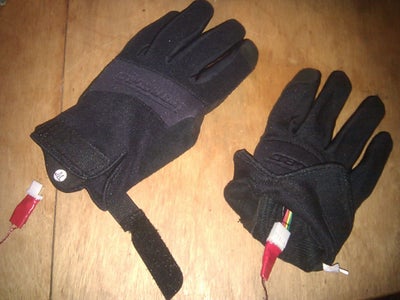

For earlier prototyping I used the Arduino Uno for ease of use then moved it over to the Arduino Pro Mini on a protoboard once I wanted to make it more permanent. The circuit diagram is below. Its looks more complicated than it is. The servos get power, ground and data and the push button switches in each finger are connected to power on one side while the other connects to a data pin from the arduino with a reference to ground via a resistor. All of the resistors are 10k ohm.
The control sketch for the arduino is also below. I used a bounce library to take care of the noisy buttons. I titled this sketch "with simultaneity" because an earlier version required me to hold down the button to make the servos move. This was an issue because the arduino can only do one thing at a time. So, what I did was made it so that one button press activates the servo and a second button press turns it off. This allows the activations of multiple servos at once.
The 5 wire JST connectors were convenient to use for the gloves, making the gloves detachable from the central brain. Each glove has 5 wires: 4 lines to the arduino's data pin (one for each button) and one common power source. To go from the glove to the brain I used magnet wire. Don't do this. I was seduced by their thin low profile and managed to convince myself that they wouldn't fatigue and break under the stress.
I then used a radioshack battery case meant for 4 AA's as an enclosure. I hollowed it out then made holes in the side for the servos and gloves and a big rectangular whole in the top as a viewing port.

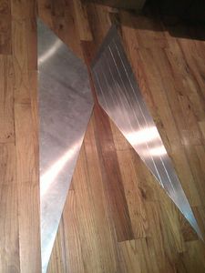

This took me FOREVER. To ge the brushed aluminum look, I used 100 grit sandpaper at the end of a sponge mop to put the finish on them. Using the mop instead of your hands allows you to get much longer strokes and much straighter brush lines.
Once they had the brushed finish, I used a diamond tipped dremel bit to etch lines into the panels to match the model in step 2. This took FOREVER, but I'm very happy with how it came out. I could have drawn the lines on, but the etching really pops when they catch the light giving it a much better look.
Below are the two secondary wings comparing before and after.
Note: The way I did it I had to take the wings apart after testing them to do the final detailing. I did this so I wouldnt risk damaging the finish while mounting them. If you know the best way to do it (I dont) then you could detail them, add a protective coat (I tried polyurethane and it didnt work out that well) then mount everything to them without worrying about scratching them.
