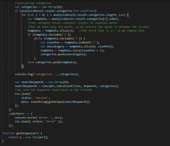

Next, we need to extract the detected features from Watson NLU's JSON response. We just loop through the results and store the items in string arrays. As categories contain a taxonomy of items separated by slashes (/), we extract each word separated by slash, storing them into an array. Then we combine all the items into a single array. To remove duplicate items, we convert the array into a JavaScript set and then covert the set back to an array using the spread (...) operator. These unique array elements are then converted into a string. It is then sent to the fronted, as a JSON response for the POST request.

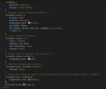

The frontend is the area for the user input as well as the output. For determining the type of document, we include a drop-down list button, showing options: text / URL. Then we include a text area for entering the URL or the write-up, and a search button. We then add some CSS and a background to make the page look appealing. We would then be implementing DOM (JavaScript) for controlling the various aspects of the page.
