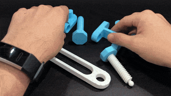

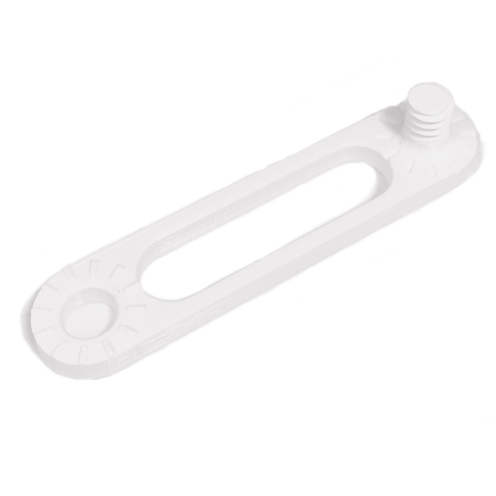

The initial design had two models of arms:
- One with two "male" ends (two threaded ends);
- One with two "female" ends (two ends with a hole).
The idea here seemed great to me! The threaded end of one of the arms passes into the hollowed end of the other, and a knob, also 3D printed, is screwed to compress the two pieces together. Grooves and bounces on the surface of these two partes are used to lock the position of the arms.
These two models are still available and are still compatible with all other parts. However, these two types of parts slightly limit the mounting of the lamp, since one should always use an even number of arms between the lamp holder and the anchor point.

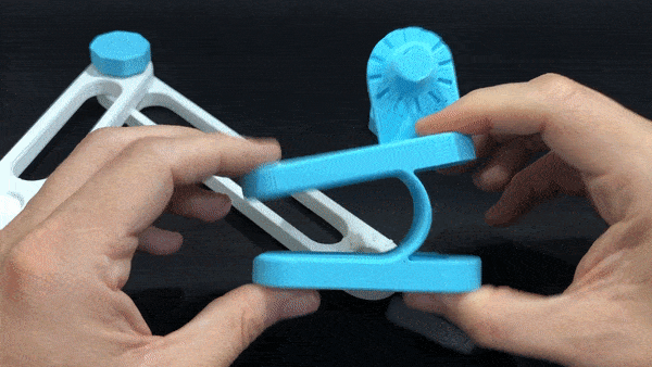

The first remix of the project was the inclusion of a new type of arm, containing a threaded joint at one end (male) and a hole at the opposite end (female). In this way, it is possible to mount the lamp with any desired number of arms (even or odd number of arms), making the structure longer or shorter as desired. Special thanks to Robert Phelps
who had the great idea of adapting the arms (link). Thank you!
Different applications may require larger spacing between the fixing point of the lamp and the object to be illuminated. With this in mind, different sizes of arms were introduced: 100, 140 and 200 mm. Any of the sizes can be combined in the construction of the joint. The idea came after Ken Mckittrick published and 8 inch long arm (link), and made realize that this might be usefull for different users.
Please also check div saW remix (link). It uses a spring between the arms and the nuts to create a self articulating joint.

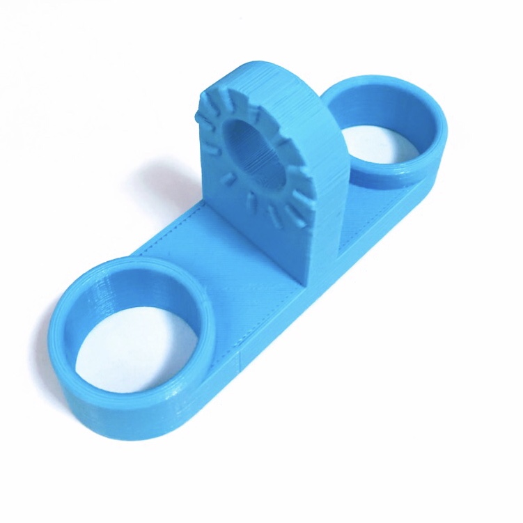

One remix proposed here was the addition of a new lamp holder model, enabling a pair of lamps on the same holder. Thus, it is possible to achieve twice the brightness for the luminaire.
This remix was inspired in Lena Brüder design (link), which accomodates three lamps in a single holder. I thought three lamps would be too much for me, so I redesigned it for a pair of lamps only. :)
A lot of users warned me about the dangers of the exposed contacts behind the socket, and the danger of and electrical discharge. Carlos Martinez (link) and Pepe Potamo (link) proposed a lamp cover as a safety improvement. But what really caught my attention was the solution of MAILLERE Brigitte (link), who proposed a lamp cover with a round switch for turning the lamp on/off. I really liked that and decided to make my own version, in a octagonal pattern to resemble the format of the nuts used in my design. The socket is hidden inside this structure, and a round button is installed on the opposite side. There's a hole on side for the wires.
I also designed a simpler version, without a button, meant to cover the exposed contacts of the connector and avoid electical issues. As always, use it if caution even with this protective lamp cap.

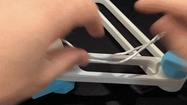

The very first suggestion I received was for a wire holder for the lamp. The wires between the connector and the socket are loose, being able to entagle with the structure itself or with nearby objects. Some users solved this using some zip ties, which's just fine. But Carlos Martinez (link) presented another great solution for the problem, followed latter by Pepe Potamo (link). They devised a clip to hold the wires close to the structure of the arm itself.
Although, I wanted something simpler. So I designed my own version of the wire clip, which's easy to use, easy to print and, I hope, not so easy to break! :)

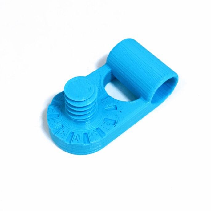

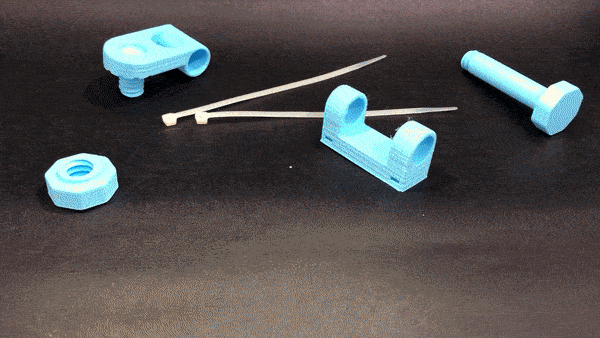

Another new support presented here is the clip peg type. This support is designed to be "clipped" on flat surfaces with thickness up to 35 mm. The advantage here is, in addition to versatility, the fact that it is made up of a single piece! It will take longer to print, but it's make of a single part with no external moving parts.
The last part I present here is the zip tie mount. It was proposed by Gael Lanfond (link) based on a remix of the wall mount part. It has a couple of inserts, through which zip ties are passed. This assembly allows tying the luminaire in tubular structures, like pipes and post. It's a great idea!

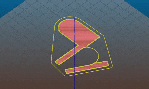

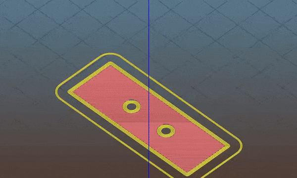

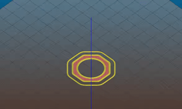

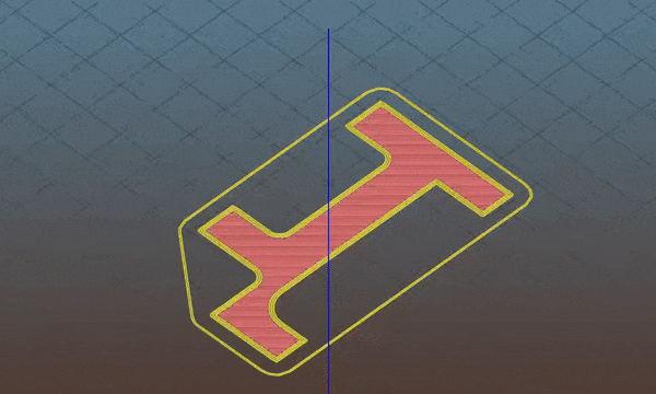

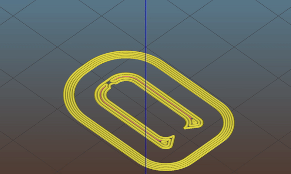

Step 5: 3D Printing
You may print the parts described on the previous steps, in your favourite color. Some of the parts, like the arms or the knobs, might have to be printed more than once. I printed all the parts in PLA, with 0,2mm resolution, 20% infill and no supports (considering you place then with the right orientation, the one of the stl files).
You can find all files at:
https://www.thingiverse.com/thing:4739055
https://cults3d.com/en/3d-model/home/articulating-...
https://pinshape.com/items/40945-3d-printed-3d-pri...
https://www.myminifactory.com/object/3d-print-4369...
https://www.youmagine.com/designs/articulating-led...

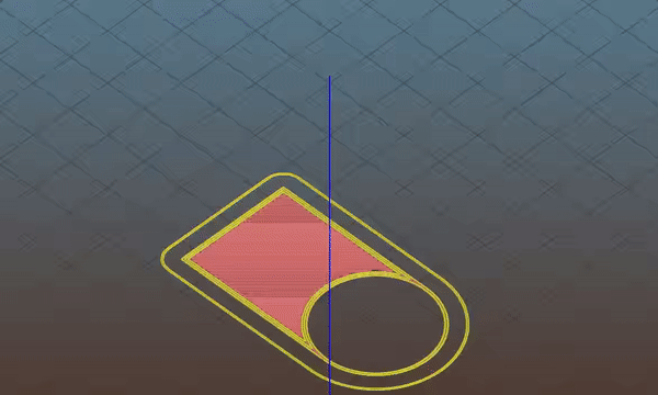

Follows a picture of each part and the extimated tipe you'll take to print them.

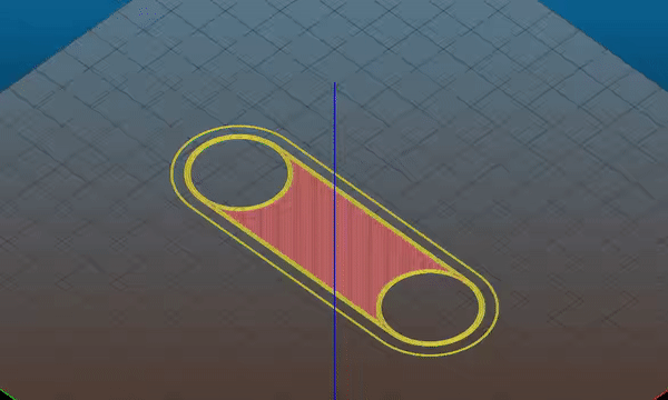

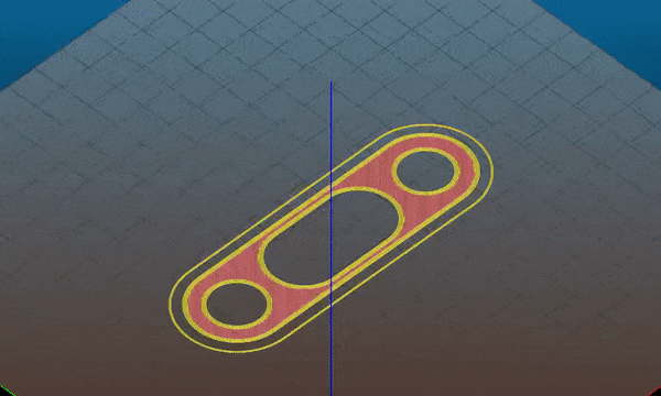

Arms:
Printing time:
- "Female/female" arm (100 mm / 140 mm / 200 mm): 70 min / 90 min / 110 min
- "Male/Male" arm (100 mm / 140 mm / 200 mm): 120 min / 140 min / 160 min
- "Female/Male" arm (100 mm / 140 mm / 200 mm): 90 min / 110 min / 130 min

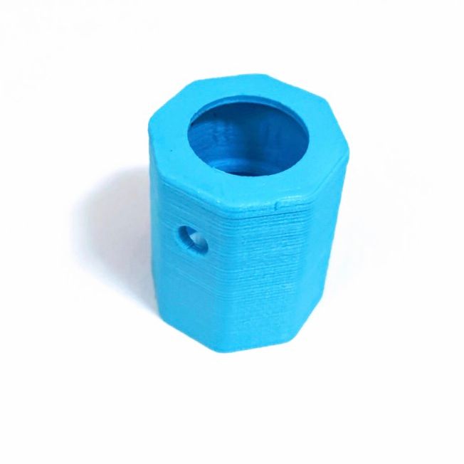

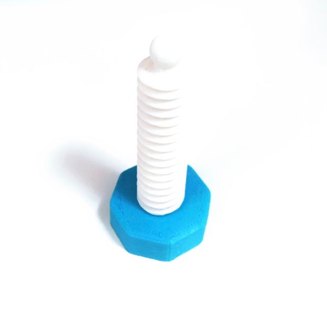

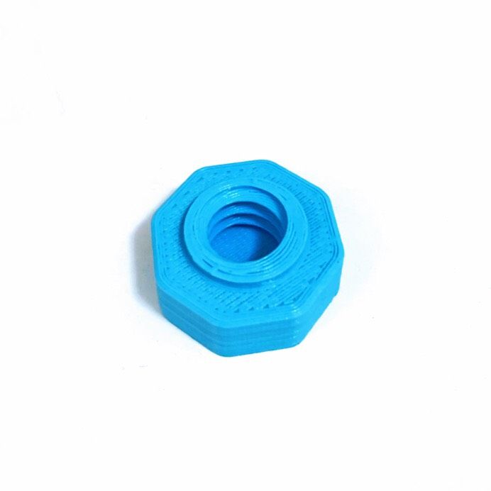

Knob
Printing time: 30 min

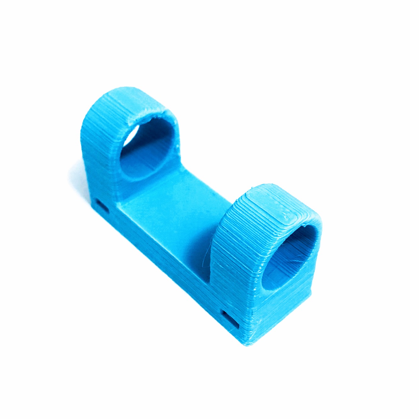

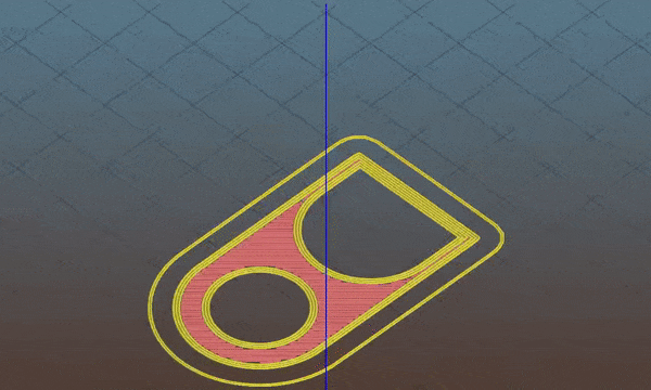

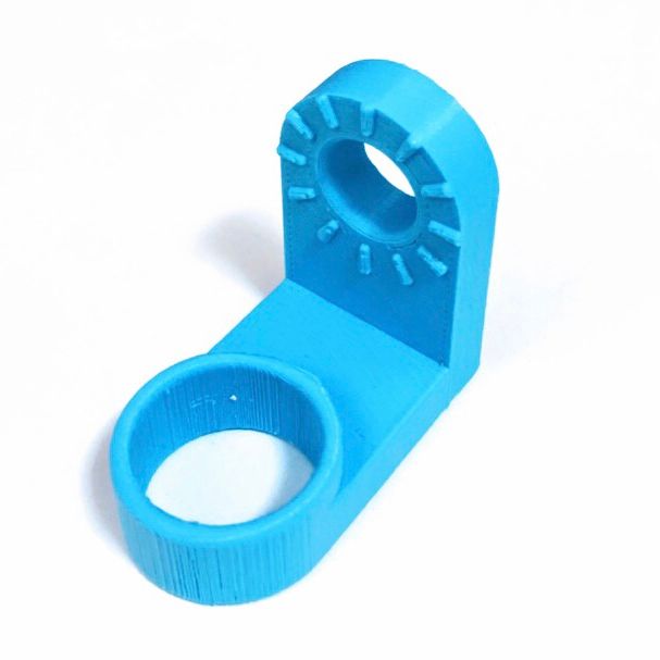

Single lamp holder:
Printing time: 105 min
Double lamp holder:
Printing time: 145 min

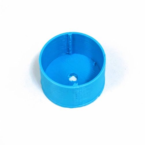

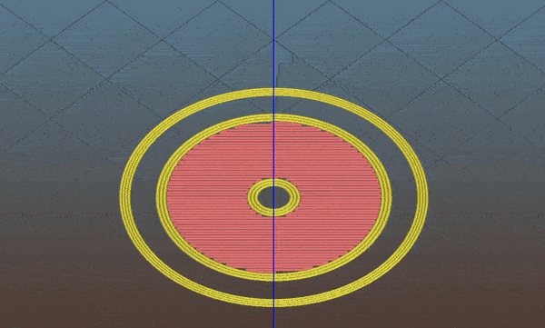

Lamp cap:
Printing time: 25 min

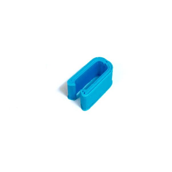

Wire clip:
Printing time: 10 min

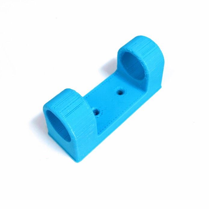

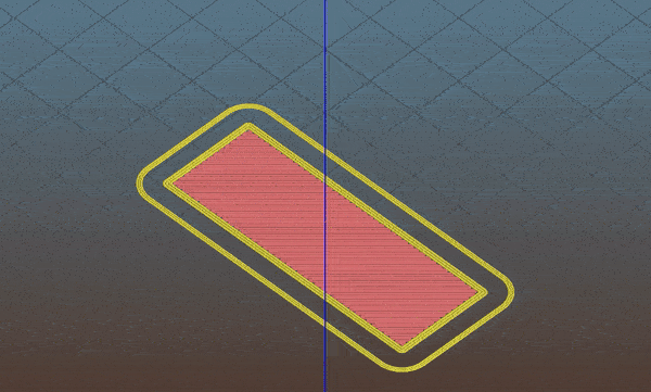

Wall mount:
Printing time: 70 min

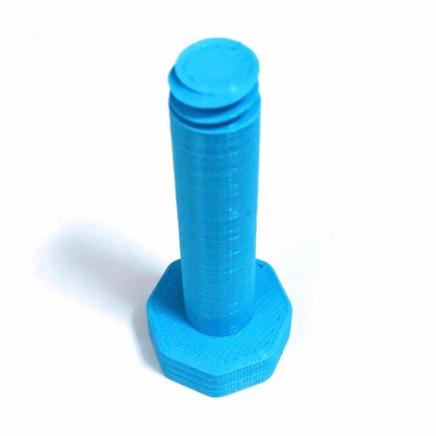

Bolt:

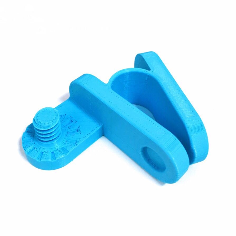

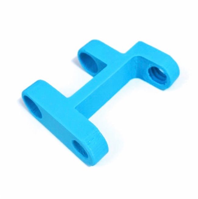

Wall joint:
Printing time: 90 min
Clamp:
Printing time: 110 min
Clamp screw:
Clamp cap:
Clip:
Printing time: 235 min

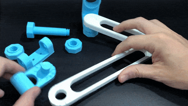

In this step I'll show you how to assemble the lamp, connecting each part of it. The assembly is very intuitive and self explanatory, however I wanted to include some animations here! :D
As I said before, there are several ways to mount the lamp using more or less components. Here I present just how to assemble each component individually.

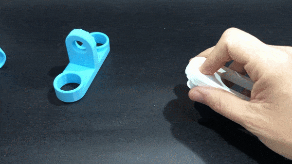

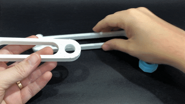

Arms

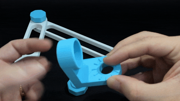

Connect the threaded end of one arm with the hollowed end of the next arm and use a knob to compress the two and lock their relative position.

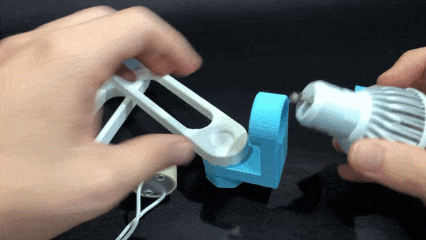

Single lamp holder
Connect its end to the threaded end of one arm and use a knob to compress the two and lock their relative position.
Double lamp holder

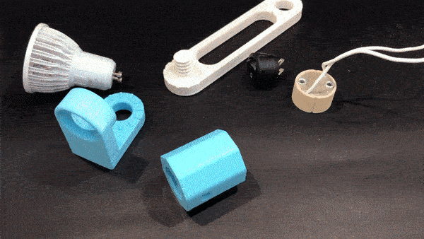

Lamp connector

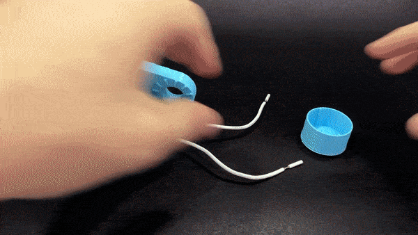

Pass a LED spotlight through the lamp holder and put the GU-10 connector on the other side.
Wire holder
Clip the wire holder into the arm, securing the cable.
Lamp cap
Pass the wires through the center hole of the part and attach the cap to the lamp connector.
Lamp button cap
Fit the button on the cap, solder the wires from the connector to the button terminals (not shown in the animation), and the power wires through the cap hole (not shown in the animation). Attach the connector to the lamp button cap part, and then the connector on the lamp.
Wall mount
Connect the wall joint to the hollowed end of one of the arms, imprisoning it with a knob. Enclose the wall mount in the wall joint, and pass a bolt through both parts. Thread a knob at the end of the bolt. Use a couple of screws to install it on the wall.
