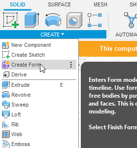

  2. Open Fusion 360. Then 'Create'> 'Create Form'. Since the spiral is not a regular shape, we wil use form builder to do this.

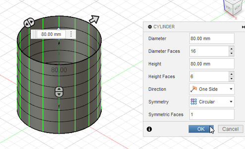

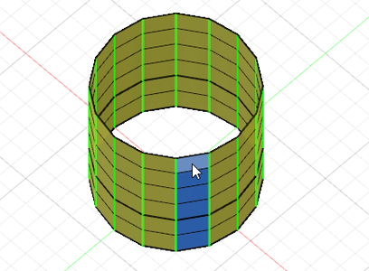

  3. Create a 'cylinder' from the list. Provide diameter, height as you like. make sure the 'Circular Symmetry' is on.

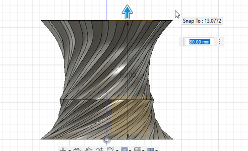

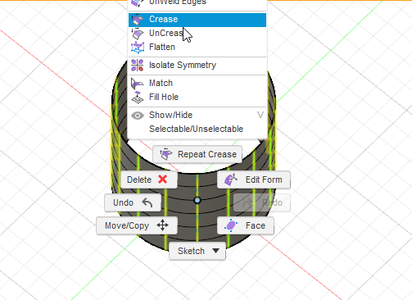

  4. Select one vertical line shown in green as shown in the 4th picture. Due to symmetry, all the lines will be selected. Then turn them into 'crease' by right clicking.

  1. Select face: Select a set of vertical faces as marked in blue. Carefully click at the center of the faces, not the edges.
  2. Then 'Right-click'> Edit form.
  3. Extrude: Go to the top view (by clicking 'top' on the view cube at the top-right portion of the screen btw). Now keep 'Alt' pressed and drag the blue square to give i some thickness as shown.

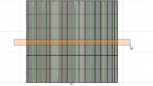

  1. In the horizontal view, select any edge loop by dragging the cursor.
  2. Use the 'Dot' as pointed by the cursor in the picture to scale the individual loops.
  3. Make the shape as you like. you can make various shapes by modifying the edge loops.

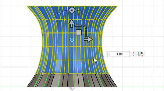

Step 9: Adding Twist in the Story

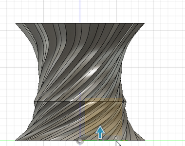

  1. Now you need to add a twist in the vase. In the horizontal view, select all faces except the bottom row.
  2. Use the 'rotate dot' shown in blue and twist it by specifying degrees of rotation. Similarly keep providing twists to the layers above also.
  3. If you want other designs like: a line between layers, deselect the last edge and twist to see how you like the design. You can scale also to change the loops afterwards. You can make different kinds of designs with the techniques discussed . The more you play with the design, the more innovative designs can emerge.

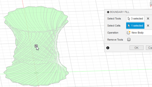

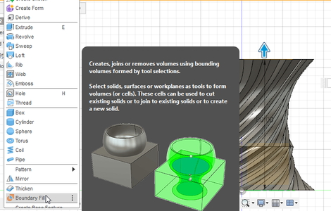

  1. You need to specify boundaries to fill a solid. In horizontal view, drag the lowermost plane to the top as shown to create the top end.
  2. Select boundary fill from the dropdown menus as shown.
  3. Select the planes and the shell. Tick on the center box as shown. You will get the solid in this way.

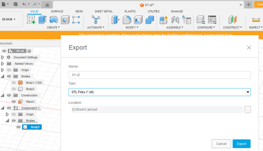

  4. Once you get the body, export it to '.stl' form for 3D printing.
