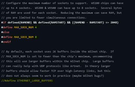

Download Ethernet.h from this project and Ethernet library via Library manager in Arduino, replace original Ethernet.h with one included in this project or adjust following parameters in existing Ethernet lib.
Ethernet | Arduino Documentation
- Open Ethernet.h file in your library location and edit following parameters:
- change #define MAX_SOCK_NUM 8 to 2
- uncomment #define ETHERNET_LARGE_BUFFERS

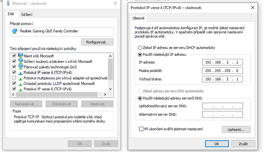

Network Interface static address:
First step is to configure our Network Interface in windows to static IP. This IP address needs to be in Range of network we want to use. For further explanation please refer to TCP/IP Networking basics as this information is in general available. TCP/IP addressing and subnetting - Windows Client | Microsoft Learn
example:
- your PC ethernet adapter has IP: 192.168.2.1 mask 255.255.255.0
- your nodes can use address between 192.168.2.2 - 192.168.2.254 (Configured in Step 3)

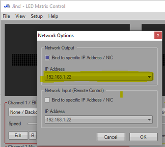

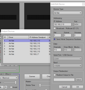

Open Jinx! and define your output device with IP, subnet and universe you used in your code setup in chapter 3
Define Output network device.
Define LED matrix with our newly created output device.
Run some animations from the Jinx!
Click start output. Your Artnet node should output Artnet Values to LED strips.
