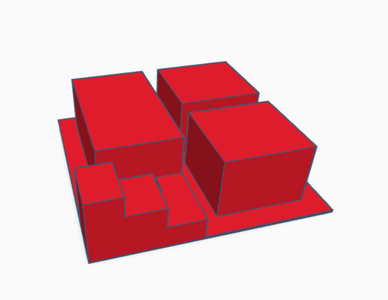

Step 1: Tinkercad
  • Before we make our mold, we need to plan
  • I used tinkercad to design the model
  • Thickness for walls or steps should be 8mm or higher
  • no overhangs
  • Keep it simple
  • We need the negative of this design
  • Covert the design into the hole and cut it into a square for which the length and breadth are the same but the height is 1mm taller
  • The result is as shown. We have a (inverted) base
