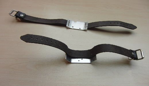

9. Cut out 2 Alu-plates (or brass)
10. Attach leather-belts to the plates, plates to rails, where ever they feel best when you have it on your arm.
11. Drill a hole in the ring (or make a ring from tubing / bend a ring, strapof brass will do).
12. Attach a piece of string to the ring, the other end to the trigger-lever. Has to be long enough, but not too long ^^
