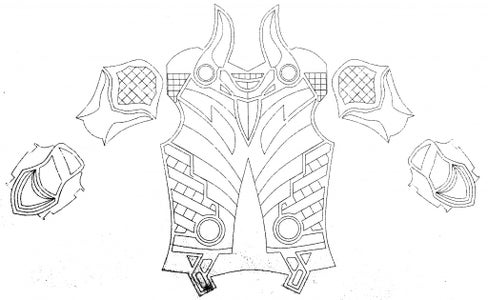

We started with a pic of the armor and helmet! once we found a good one we did some measurments to make sure the Armor and helmet would fit properly!
We then opened out CAD program and based out our outline, once it was to the shape and size of our measurments we started adding the detail. After the detail was refined we added a little color to it to makes sure we were happy with the overall look of the designed piece.
Next we set up the the CAD file in out software to assign route pathing to the areas we want to cut. Since we are making a master we cut away the recessed areas to give us raides detail! This is the hardest part as you are taking a 2D image and turning it into a 3D object. Also our CNC machine does not cut in 3D so we have to do our designs in steps and recesses.

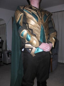

Once your latex is dry you can pull it from the mold and get it ready to paint. First I would advise that you cover the exposed latex with baby powder as this will prvent the latex from sticking to its self. Now with the latex out of the mold you will want to wash it off with water, trim off all the acess and let it dry. Once dried we usually cove the latex piece in plastidip, it helps your paint stick better and keeps it from cracking. Once the plastidip dries you are ready to paint, you can either use latex paint or watetred down acrylic. Paint up your Armor the way you want it and let your paint dry bewteen coats.
Now that your piece is painted you will want to add straps or mount it to your underarmor shirt. I usuaklly glue mine it seems to stay in place better so that is what I will explain next. For the glue we use weldwood contact cement, it stick by chemical reaction so I would not recommend wearing the under shirt while gluing. All you have to do is cover the area of your undershirt that the Armor will cover, I would siggest at least 3 coats letting each nearly dry before adding the next. Once the last coat is on coat your latex armor, let dry a little and press the armor to the undershirt. Let dry for 12-24 hours and you have yourself some kick butt armor.
This will work with any costume if you have the imangination to make it a reality. We used Loki Armor as an example. We also did the helmet, but thats another ible.
