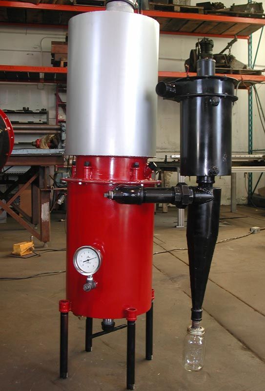

When you are finished with this Instructable, your GEK biomass gasifier will look like this.
Well, you might have to apply a bit of paint first. You are welcome to paint your GEK in any manner you like. Though we do suggest you use high temp paint, commonly found at any auto store. The 500F paint is fine. You do not need the 1200F paint

The gas cowling, reactor and hopper bolt together into a single vertical assembly. The cyclone, packed bed filter and blower similarly bolt together into a single vertical assembly. These two assemblies attach together via the gas outlet flange to the cyclone. A soft hose attaches the blower to the swirl burner.
