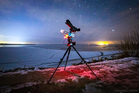

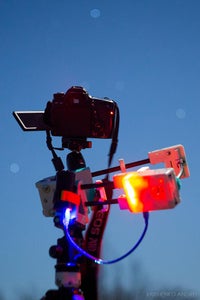

There are only three main things you need to have to start with astrophotography:
  • DSLR with a lens or mirrorless camera
  • Tripod
  • Clear starry sky and no wind
Of course, there is a lot of other stuff you might need, the stuff that can make the process easier and faster, but if you have the first three, you're good to go!
But if you want to fully immerse yourself in this process you will need to consider purchasing the following items:
  • Red headlamp (very simple, but very useful piece of gear)
  • Remote camera trigger (can be wired or wireless, wired is cheaper, wireless has no limitations that wired has)
  • Bahtinov mask (special cap for lens to get perfect focus)
  • A set of several fast lenses with various focal lengths
  • If you are using a cropped DSLR, you may consider purchasing a full-frame one
  • Ballhead tripod (if you don't have one yet)
  • Star Tracker device (pretty expensive, but it allows you to drastically improve your astrophotography abilities)
  • Telescope (might be very expensive, but it'll literally allow you to reach the surface of the Moon, our neighboring planets and faraway galaxies)
  • There's actually a lot of other stuff you can get, but all above is what I use and have experience with.
