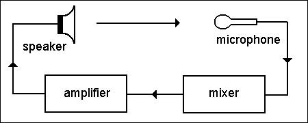

Step 1: Feedback
Feedback is a howling noise.  It can either be on the high end (very high pitched) or low end (very low pitched).  Feedback is caused when a mic is too loud and is able to "hear itself" in the speaker.  This starts what is called a feedback loop.  Tiny  imperfections in the mic are amplified, and looped over and over again, causing the howling effect.
You can fix feedback by turning the volume on the mic down (the fader on the sound board), turning the gain down (usually the knob at the top), moving the mic behind the speakers, or turning the main fader(s) down.  The preferred way to fix it is to turn the gain down, or the main fader(s).  (The main faders affect your gain structure.)  If you don't know what mic the feedback is coming from, you should use the main fader(s).  To prevent feedback keep your volume and/or gain as low as possible.

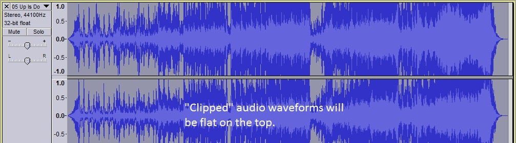

Step 3: Clipping
Clipping is a distortion caused when the audio going to a component is too hot (loud).  This causes the top of the signal to be "clipped" off.  You should turn down the gain or volume on any adjustment available until the distortion is gone.  Prolonged clipping can cause damage to equipment.
You can compare a "healthy" waveform to a "clipped" waveform in the pictures.
