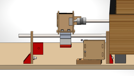

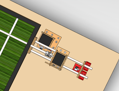

The subsystems are assembled together in order to create the Full Mechanism. The Subsystems are(also shown clearly in the Block Diagram Attached):
1-Stepper nema-17-42a02c-1 Motor for Rotation Support:
This part is composed of the motor responsible for rotation and it's support pieces. This motor will be driven by pulley-belt transmission mechanism in order to perform both the rotation of the goalkeeper and remain able to translate.
2- Connection between Stepper nema-17-42a02c-1 Rotation and Translation Motors:
The Connection between both motors is established by using sliding linear bearings on rod. To fixate the bearing to rotation motor, the 3D printed Linear bearing support is connected to the downward side of the motor support with M4x20mm screws. It is good to note that shorted screws can be used but there weren't any available, so nuts where used to compensate the part left of the screw which was still unscrewed. In addition, to connected this part to the translation motor, we implement a critical part to lock the belt in its place. Therefore, when the translation motor rotates the timing pulley, it will translate the belt which is connected to the belt lock which is connected to the linear bearing support. Linear bearing Support is also connected to the rotation motor. Thus, the translation and rotation are communicated.
3-Tensioning of Belt:
This is achieved by fixating the Fixators for Rod Supports and then fixating pulley support to it with a screw. The screw can be fastened to the lock nut more to tension the belt more and vice versa.
4- Stepper nema-17-42a02c-1Motor for Translation Support:
It includes fixing the translation stepper motor that is connected to the pulley holding the belt and translating it. The fixation is achieved by screw with the big supporting plate for the whole table, and of course the motor is fixated to it by its supporting design.
5-Baby-Foot and mechanism connection
The rotation motor connects to goalkeeper's rod by a flexible 5-8mm flexible coupling. Furthermore, the rod supports are fixated beside the table by their Support Fixators that is screwed to the huge plate supporting the table.
5-Electronics part
This part is concerned with fixating the limit switch and the photoresistor to the mechanism in a way photoresistors can detect ball position and limit switch initializes goalkeeper position. Unfortunately, due to time limit, the Electronics part remained uncovered. In addition, there were too many sensitive connections that we need to access often so we decided that we are gonna keep it uncovered instead of speeding up this part and ruining the connections. But, it is great to mention that our initial plan to cover this part was to place it under the field of the baby-foot table.

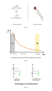

a. photoresistor sensor (GL 5528)
In this project, the main objective is to move the goalkeeper in order to catch the ball; for that we need to detect the position of the ball at the stadium and to predict its direction in order to move the goalkeeper in front of this direction. In order to realize the detection of the ball, we are going to use as sensor a photoresistor because it summarizes in it all the characteristics for the good functioning of our project ie a low cost, wide spectral ranges, easy implementation, static transfer ratio and high sensitivity. However, in order to be able to predict the direction of the ball, we will establish two lines of photoresistors in front of the goalkeeper and each line consists of 8 photoresistors. We know that to have a straight line we need two points so each photoresistor on the first line constitutes the first point and each photoresistor on the second line constitutes the second point. Therefore, once the ball passes over one of the photoresistors on each line, the direction can be predicted and the goalie will be moved simultaneously in front of this direction. This objective will be reached if we know how to collect the information that will be transmitted to us by the photoresistor in order to be able to move the goalkeeper to the desired place. For that we must know how a photoresistor works and that will be the object of our next paragraphs.
a.1. definition:
A photoresistor is a non-polarized electronic component whose ohmic value varies according to the brightness to which it is subjected.
a.2. symbol
As an electronic diagram, it is symbolized as shown in the figure below. And as we can see it is a non-polarized component consisting of 2 pins behaving like a resistor whose value decreases when the brightness increases and therefore the value increases when the brightness decreases.
(Refer to Figure 1)
a.3. main features
The main characteristic of a photoresistor is its resistivity-luminosity relationship. In fact, this gives the ohmic value of the photoresistor, depending on the light intensity to which it is subjected. However we will use this characteristic to our ends(purposes) ie the presence of a ball on a photoresistor will create darkness and the absence of the ball on a photoresistor will mark the presence of light; by this fact the new challenge will be to find the way to collect this information in order to communicate it to the two step motor which controls the goalkeeper (in order to move it to the right place). This way will be discussed in the next paragraph.
(Refer to Figure 2)
a.4.How to connect a photoresistor sensor in an electronic assembly
As we talked about in the previous paragraph, the goal of this section is to find a way to collect the information collected by the photoresistor on the stadium in order to control the two step motors that control the movement of the goalkeeper. This information that is nothing more than the variation of the value of the resistance of the sensor photoresistor in the presence of light or not. Knowing that a photoresistor is an electronic component with 2 pins whose ohmic value varies (the variation of the resistance is the information collected by the sensor) with the ambient brightness, a simple ohmmeter can measure this value, when this photoresistor is not connected to anything else. However, we wish to use it within an electronic assembly and it is not beneficial for us to use an ohmmeter because we will not be able to transmit this value (information) to the two step motor. In fact, we will have to find a roundabout way to find the value of this photoresistor. As the photoresistor behaves like a variable resistor, we prefer this solution which is to create a voltage divider bridge. We can then connect it in series with another resistor but of fixed value that we will connect both on Arduino board in order to collect the information of the photoresistor which is the variation of its resistance depending on the detection of the ball or not. By the above, we can illustrate the connection of a photoresistor in the way below.
(Refer to Figure 3)
Vs represents here the signal (voltage) collected by the Arduino because it is a function of the value of the resistance of the photoresistor which is the information necessary to move the goalkeeper.
       In the first case Vs=(5*R)/(R+Rph)     and   in the second case Vs==(5*Rph)/(R+Rph)
Where Rph is the resistance of the photoresistor which varies in the presence of light or not.

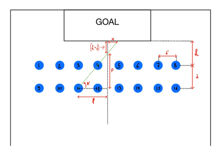

Draw 1:

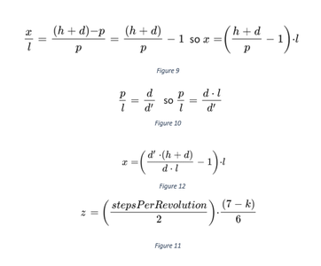

Let’s assume that the ball will have to pass through 1 photoresistor in each line. In order to be able to stop the ball and prevent it from entering the goal, it is necessary to calculate the distance X (referring to the drawing above) that separates the destination of the ball from the center of the goal.
By the property of similar triangles, we know that:
(Refer to Figure 9)
P can be calculated by the same property:
(Refer to Figure 10)
By substituting P in the first equation, we get our x:
(Refer to Figure 12)
After calculating each x-distance for each of the possible photoresistor combinations, it is important to store this data in an efficient way in order to assign the goalkeeper the distance to be covered between the center of the goal and the trajectory of the ball after each shot of the player.
as a first step, we decided to store in a square matrix of dimension 8x8 the distance X for each combination of 2 photoresistors, with in column the number of photoresistors of row 1 and in row the (number of photoresistors of row 2) -8

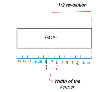

However, it must be taken into account that the goalkeeper has a non-negligible width and that the foosball table at our disposition is relatively small with a limited size of the goal. It happens that for several different combinations of photoresistors, the goalkeeper can stop the ball with one and the same movement.
Draw 3:
So we set up 13 different positions for the goalkeeper, with position 7 being the middle one (the goalkeeper must not move), position 1 being the one on the far right and position 13 the one on the far left. We then made a more manual calculation (by drawing straight lines) to determine the position where the goalkeeper should be (and not anymore the distance X between the trajectory and the middle of the goal) according to all the possible combinations of the photoresistors.
Draw 4 :
we know that to move from the middle of the cages to its extremity (from position 7 to position k=1 or k=13), the number of steps the motor needs is stepsPerRevolution/2 where stepsPerRevolution is the number of steps needed for 1 revolution of the motor. as there are 6 positions between the middle and the extremities, the number of steps for each position k is given by this formula:
(Refer to Figure 11)

// function that translate the goal keeper to the corresponding position and then rotate it to shoot the ball
void Move_and_Kick(int line1,int line2){
  int k = matrix[line1][line2-8];
  if (k<=7){
    digitalWrite(dirPin, HIGH);
    z = (170/2)*(7-k)/6;
  if (k>7){
    digitalWrite(dirPin, LOW);
    z = (170/2)*(k-7)/6;
  for(int x = 0;  x < z ; x++)

// function that place the goalkeeper at the center of the goal using a limit switch.
void Move_To_Limit() {
  Serial.println("past in move to limit");
 limitSwitch.loop();
  if(limitSwitch.getState()==0){
       p=1;
  while(p==0){
    Serial.println("on the while");
    limitSwitch.loop();
    digitalWrite(stepPin, HIGH);
    delayMicroseconds(5000);
    digitalWrite(stepPin, LOW);
    state = limitSwitch.getState();
    if(state==0){
      p=1;
    for(int x = 0; x < stepsPerRevolution; x++)
    delayMicroseconds(1000);
    q=1;
Step 9: Integration Guide
  1. Connect the Stepper nema-17-42a02c-1 rotation motor and Stepper nema-17-42a02c-1 translation motor to their supporting laser cut plates using M3x25 flat head screws to connect side to front and back sides and M4x5 to screw front side to the motors. All parts other than mentioned are made female-male connection, like Legos they only require a little force of hand to push them together. In addition, the design of the plates was made in a way to connect to their downward plate and remain fixated without the need of glue.
  2. Stepper nema-17-42a02c-1 translation motor is fixed on the huge plate supporting the whole assembly by M4x20 wood screws.
  3. Connect the Stepper nema-17-42a02c-1 rotation motor to the linear bearings using M4 x20 flat head screws: u can use shorted screw without the need of Nuts, but due to the non-availability of enough medium lengthened screws we decided to go with 20 mm length and add nuts to compensate for the unused screw part.
  4. Connect the linear bearing support by the already placed screws and then connect this support to the upper belt lock. place the GT2.5 timing belt inside the belt lock and then place the downward part and screw using M4x20 flat headed screws.
  5. place the belt on both GT2.5 timing pulleys. One pulley is fastened to the Stepper nema-17-42a02c-1 translation motor and the other is fastened to the pulley seat with placement of rod inside side holes.
  6. The pulley seat is fixated to the rod supports with M4x20 flat headed screws, M4 nut, and M3x5 screw.
  7. The rod supports are fixated to the huge plate supporting all baby-foot table using the 3D printed fixators and M4x20 wood screws. In addition using M4x20 flat head screws and hex M4 nuts to fix them vertically and keep them perpendicular. The other side as well but using fixator with 2 holes instead of the 4 holed one.
  8. Slide the rods to first rod supports, then to the linear bearings, and at the end to the other rod supports.
  9. Attach Limit Switch to the Translation Motor by using M2x5 wood screws. Place photoresistors in the holes of the field.

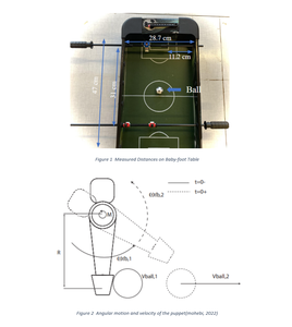

Step 16: Annex(Calculations)
The Motor Calculations can be found here:
A main requirement is the maximum distance the goalkeeper rod can move in order to know the maximum lateral motion the motors must provide for the goalkeeper rod. Figure 1 displays the measure maximum lateral movement for the goalkeeper rod and distance between the opposing player and the goalkeeper. The maximum rotation range for our application is between -45° and +45°(Figure 2). In lateral move, as shown in Figure 3, considering the distance between the ball and goal is about S=150 mm, every angular error (Theta)e= 0.5° mistake makes about Error= S*tan((theta)e)= 1.3mm. When the maximum error in the destination is 1.3 mm,it is still possible that the goalkeeper misses shooting the ball and it goes toward the goal. The deviation of hitting point from central axis of the ball is Error Emax=±0,14 mm The ball velocity Vball=12 m/s Distance between human controlled bar and actuated goalkeeper bar is Sbar= 31 cm.
Maximum movement of goalkeeper is Srod=11.2 cm The passing time from a bar to the next one in straight shot is Tpass=Sbar/Vball=26 ms The time for reaction is less than 26 ms and depends on the processing unit, reaction time of motor and speed of the rod’s moves. Taking a good estimation, the time for two third of the distance between the two adjacent rods considered for processing time and command to the actuator and the other one third for the rod’s move to reach the ball. It means 17.3 ms for the processing and command and 8.7ms left for the rod to catch the ball by the goalkeeper. According to previous researches, if the puppet hits the ball at the theta e=8°, then the ball will lose 1 percent of its forwarding speed(Figure 4). The maximum time for the goalkeeper to catch a ball is Tmax=8.7 ms. then the necessary speed for lateral move will be: Vrod=Srod/tmax=1.3 m/s and acceleration to reach this velocity would be a=13 m/s2. Therefore, the angular velocity for the rod is w= v/r=(1.3m/S)/(4mm)=325 rad/s (r being the radius of the goalkeeper rod) In addition, considering the goalkeeper’s leg for the angular accuracy is important.Often, foosmen feet are 16 mm in length. The Angular deviation error is usually considered ±3mm for the most accurate output according to some researches(mohebi, 2022). Refer to Figure 5 for a clear diagram of this point.
Reference: Mohebi, Dani. ‘The Study of Semi-Automated Foosball Table’. Fi=AMK-opinnäytetyö sv=YH- examensarbete en=Bachelor’s thesis , 2022. http://www.theseus.fi/handle/ 10024/745224
