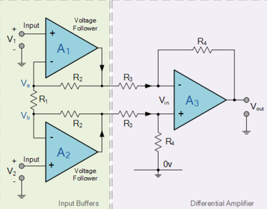

The first component of the circuit is an instrumentation amplifier. As the name suggests, the instrumentation amplifier is used increase the magnitude of the signal. An ECG signal that is not amplified or filtered is roughly 5 mV in amplitude. In order to filter the signal, it needs to be amplified. A reasonable gain for this circuit would have to be large in order for the bioelectrical signal to be filtered appropriately. Therefore, the gain of this circuit will be about 1000. The general form of an instrumentation amplifier is included in the images for this step [2]. In addition the equations for the gain of the circuit, the values that were calculated for each component are shown in the second image [3].
The gain is negative because the voltage is supplied to the inverting pin of the operational amplifier. The values shown in the second image were found by setting the values of R1, R2, R3, and gain as desired values and then solving for final value R4. The third image for this step is the simulated circuit in LTspice, complete with accurate values.
In order to test the circuit, both as a whole and as individual components, an alternating current (AC) analysis should be run. This form of analysis looks at the magnitude of the signal as the frequencies change. Therefore, the analysis type of AC analysis sweep should be a decade because it sets the x-axis scaling and is more conducive for accurately reading the results. Per decade, there should be 100 data points. This will accurately convey the trends in the data without overworking the program, ensuring efficiency. The start and stop frequency values should encompass both cut off frequencies. Therefore, a reasonable starting frequency is 0.01 Hz and a reasonable stopping frequency is 1kHz. For the instrumentation amplifier, the input function is a sine wave with a magnitude of 5 mV. 5 mV corresponds with the standard amplitude of an ECG signal [4]. A sine wave mimics the changing aspects of an ECG signal. All of these analysis settings, except for the input voltage, is the same for each component.
The final image is the frequency response plot for the instrumentation amplifier. This shows that the instrumentation amplifier is able to increase the magnitude of the input signal by about 1000. The desired gain for the instrumentation amplifier was 1000. The gain of the simulated instrumentation amplifier is 999.6, found using the equation shown in the second photo. The percent error between the desired gain and the experimental gain is 0.04%. This is an acceptable amount of percent error.
