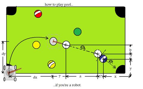

1) Webcam takes a picture
2) MATLAB vision program starts up
3) Human defines location of robot and arena area
4) Balls are identified
5)
a)human tells which ball to hit and which pocket...or...
b)artificial intelligence (AI) program figures it out!
6) Program figures out all the angles to make a shot, passes variables to Microcontroller
7) Microcontroller energizes longitudinal system, horizontal system, 3DOF aaaaand....
8) A shot is taken!

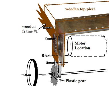

-Gets distance the robot needs to travel long-ways with the table
-DC Motor & drive chain kick in
-Built in encoder tells distance travelled
-Motor controller adjusts power accordinglyh
-Longrail arrives in place!
