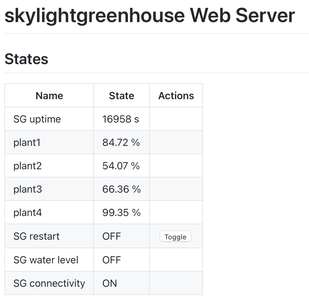

ESPHome has a built-in web server so even before connecting to home-assistant, you can keep an eye on your plants, as you can see from the screenshot.
