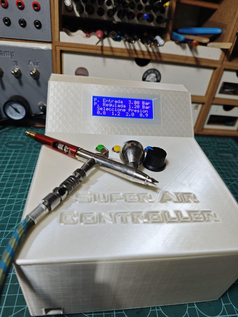

Very good to everyone! Today I bring you the Super Air Controller, what is this? Well, a pressure controller for compressed air, with which we can automatically increase the pressure or lower it, depending on our needs. Either through the buttons with preset pressures or by selecting it ourselves using a potentiometer. Just connect your compressor and enjoy! I leave you a small video from my Instagram where you can see the operation of a first version that was made with MDF cut with a cutter, superglue and patience, this model had control of the compressor, lights and password to access, I have ignored those things in this model but are easy to implement.

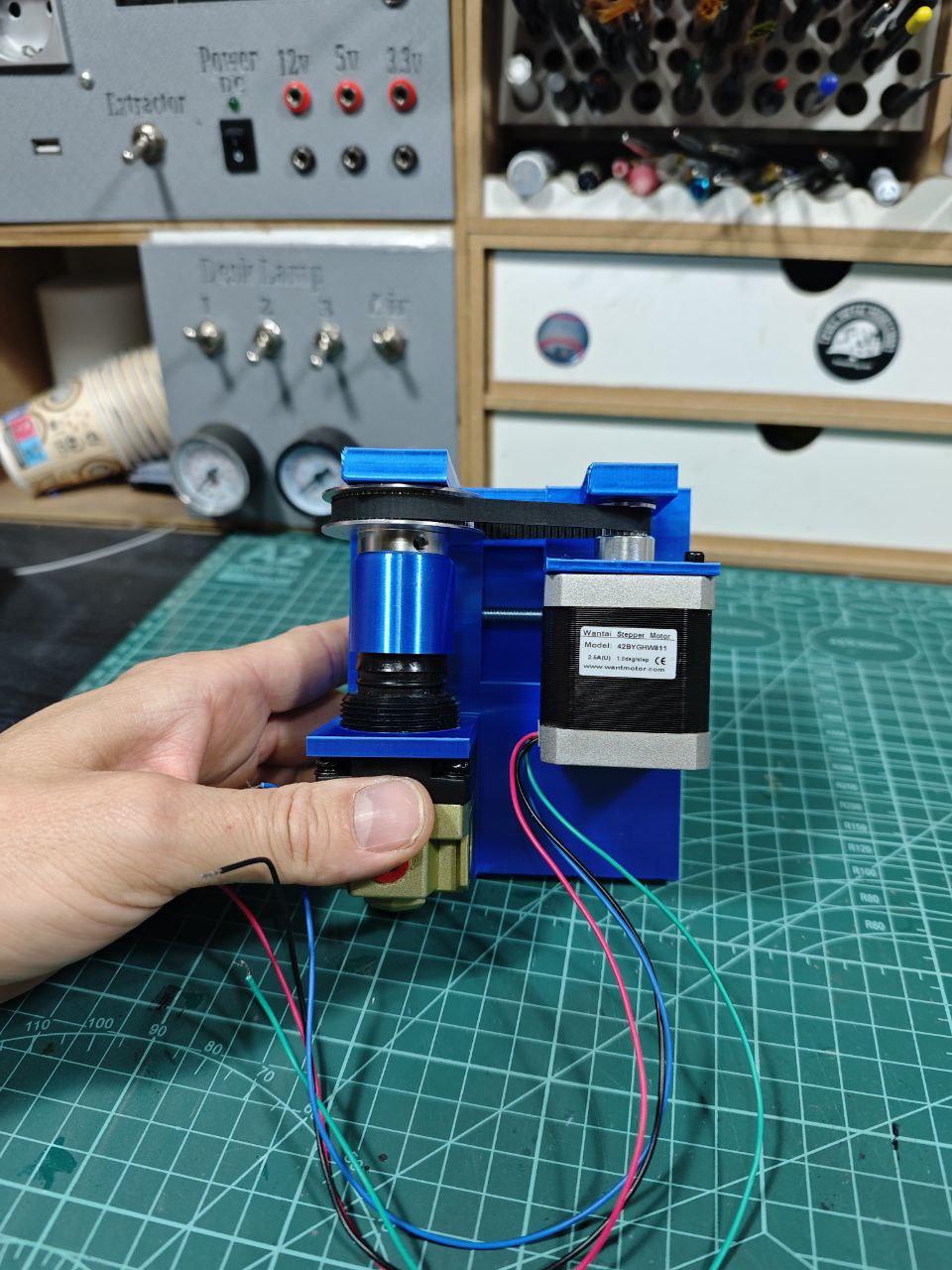

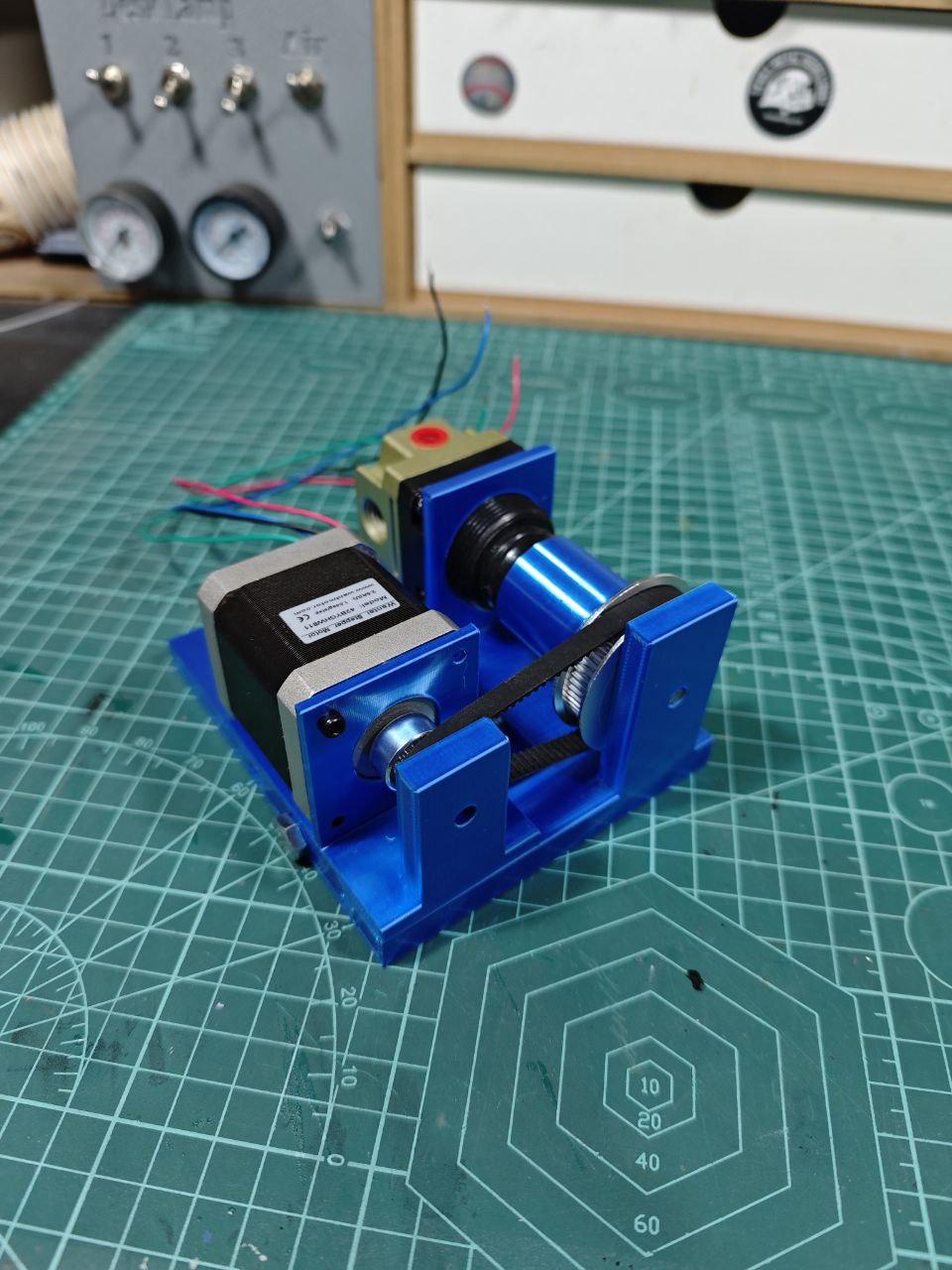

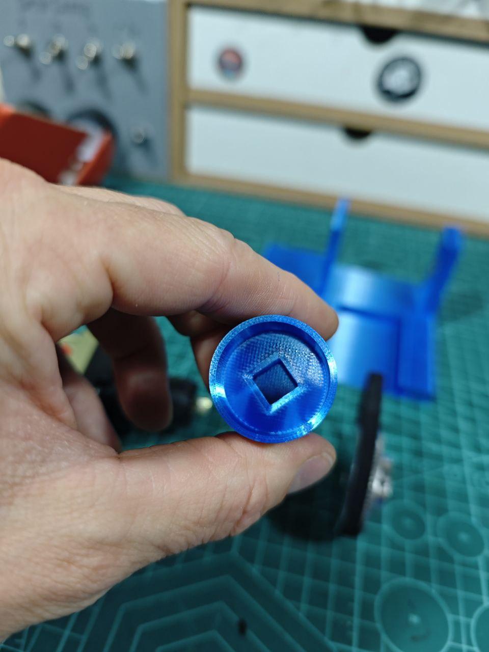

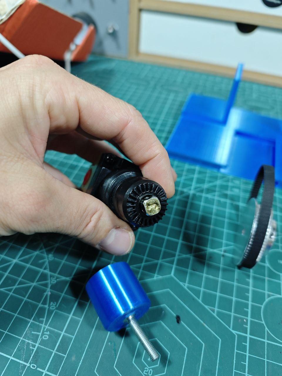

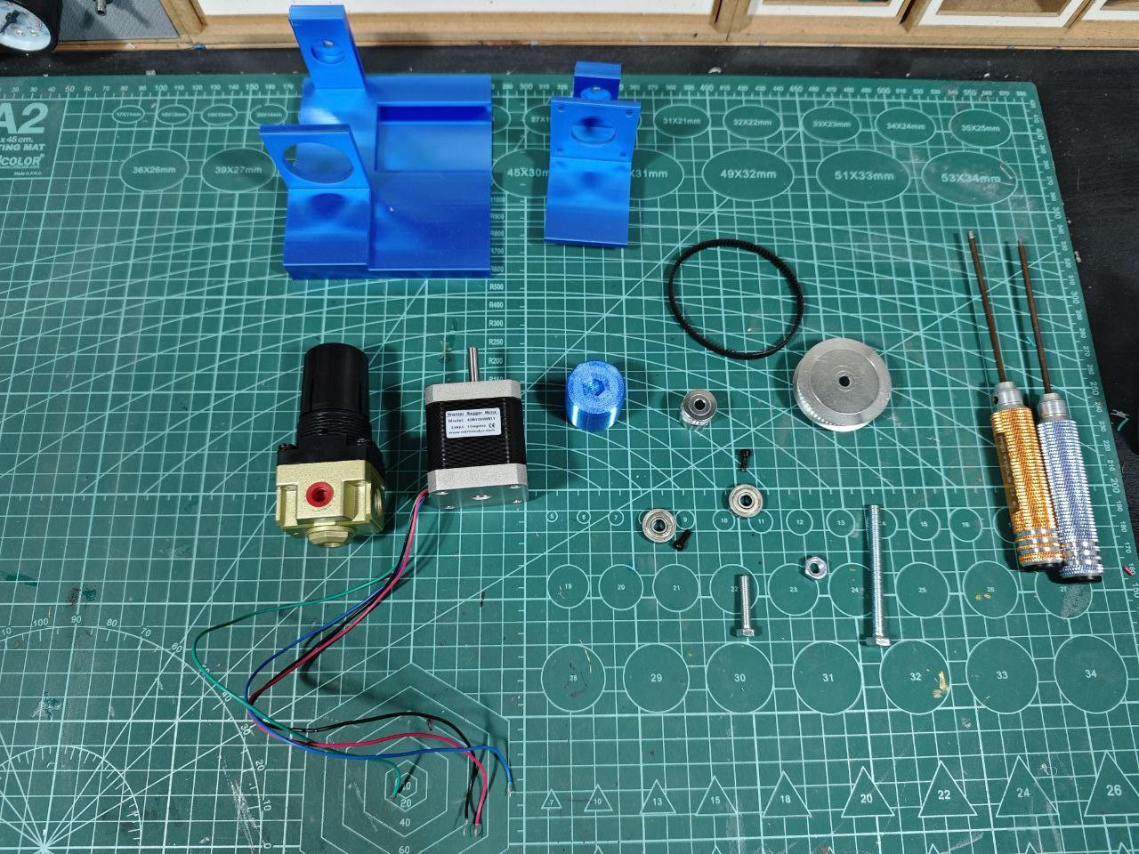

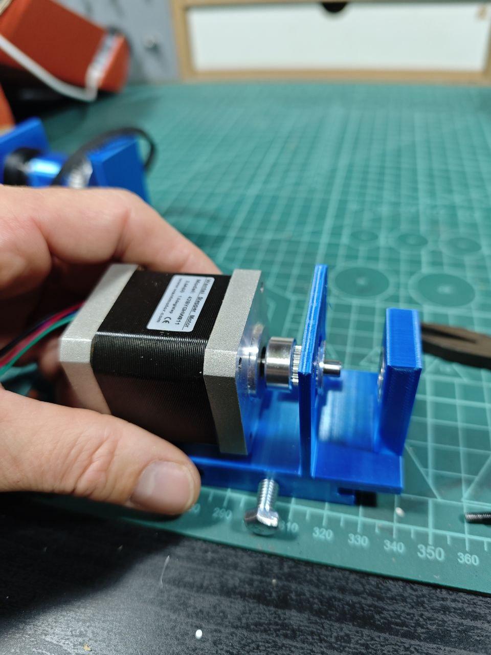

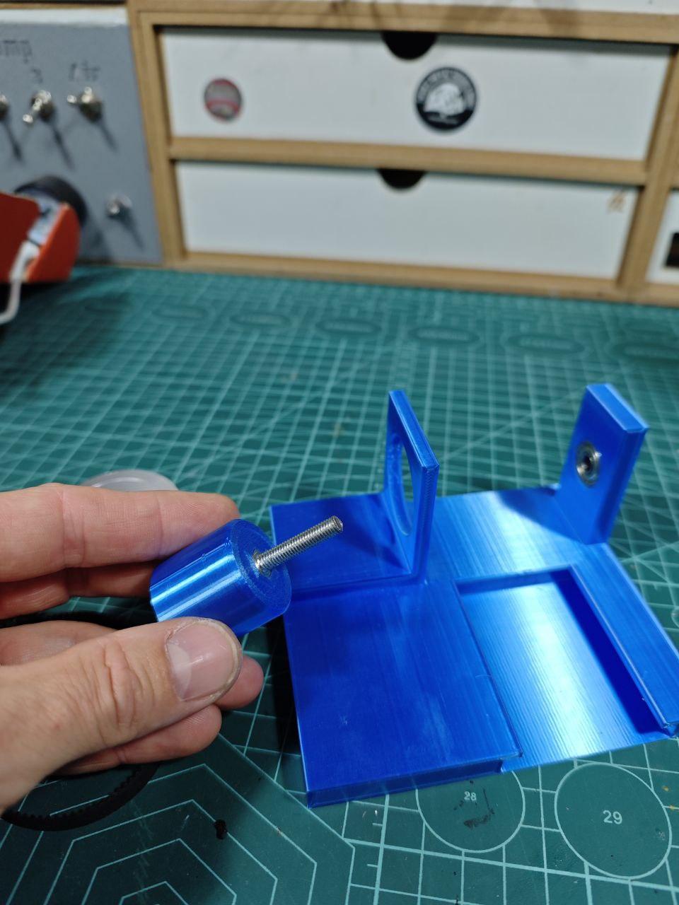

Step 1: Motor Connection / Conexión Del Motor
To connect the motor to the pressure reducer I have opted for a pulley system, the assembly is quite simple and you will only have to see the photos to see the result. The idea is that it is compact and that the motor makes little effort. I have put a screw on the side to act as a belt tensioner. If you prefer not to use pulleys, you can always make a direct connection; you can simply use an electrical terminal to connect the motor piston to that of the pressure reducer. I know it works because I did it in my first version.
Para la conexión del motor al manorreductor he optado por un sistema de poleas, el montaje es bastante sencillo y solo tendréis que ver las fotos para ver el resultado. La idea es que quede compacto y que el motor realice poco esfuerzo. He puesto un tornillo en un lateral para hacer la función de tensor de la correa. Si prefieres no usar poleas siempre podrás realizar una conexión directa, puedes usar simplemente una clema eléctrica para conectar el embolo del motor junto al del manorreductor. Se que funciona porque lo hice en mi primera versión.

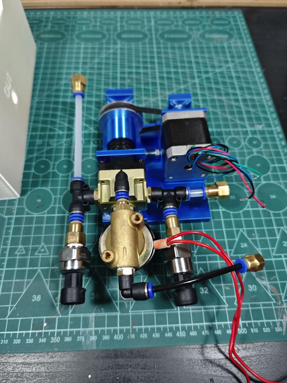

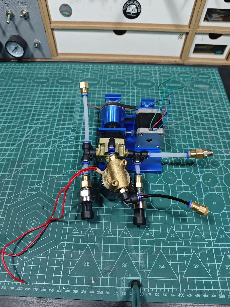

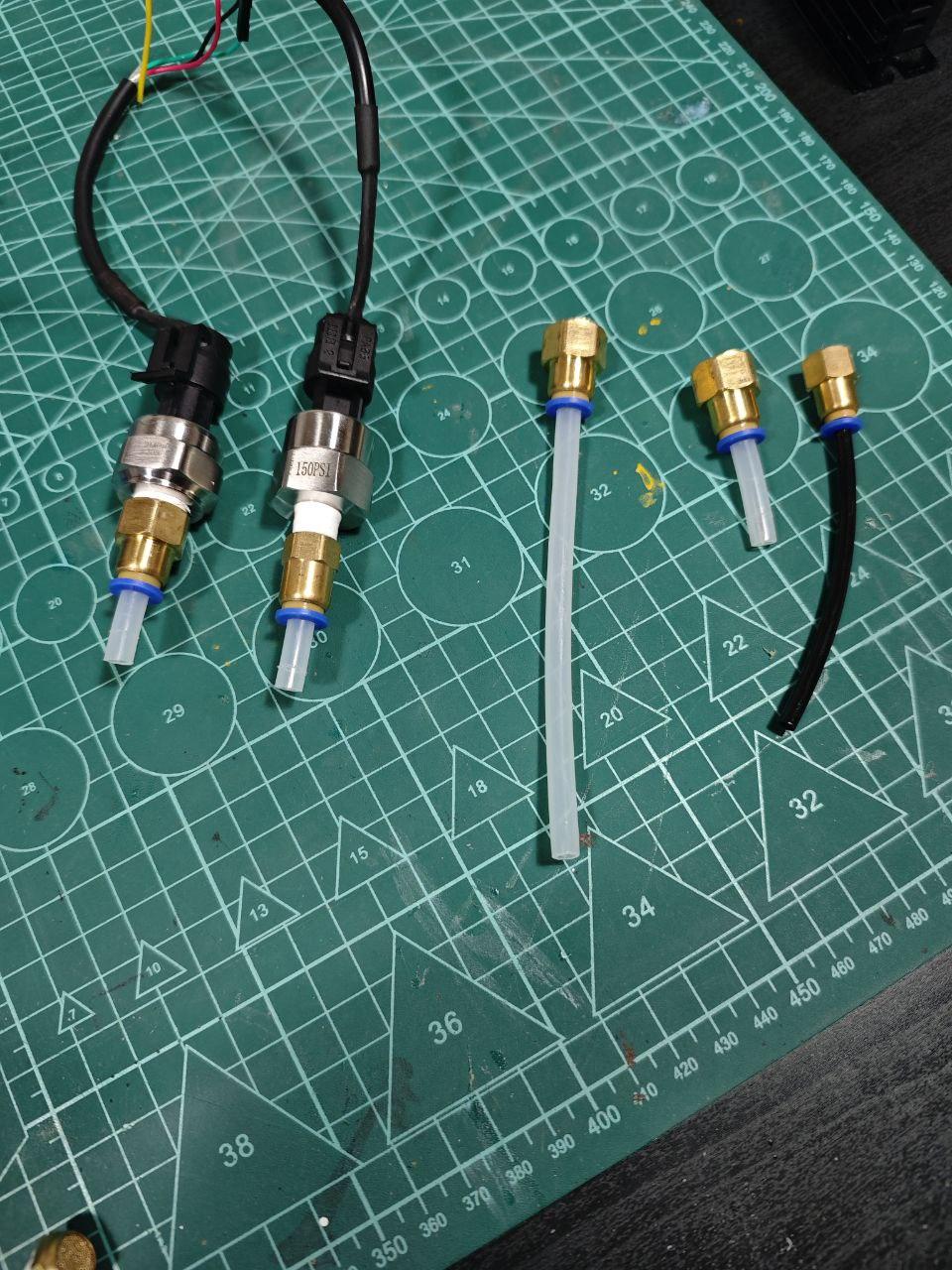

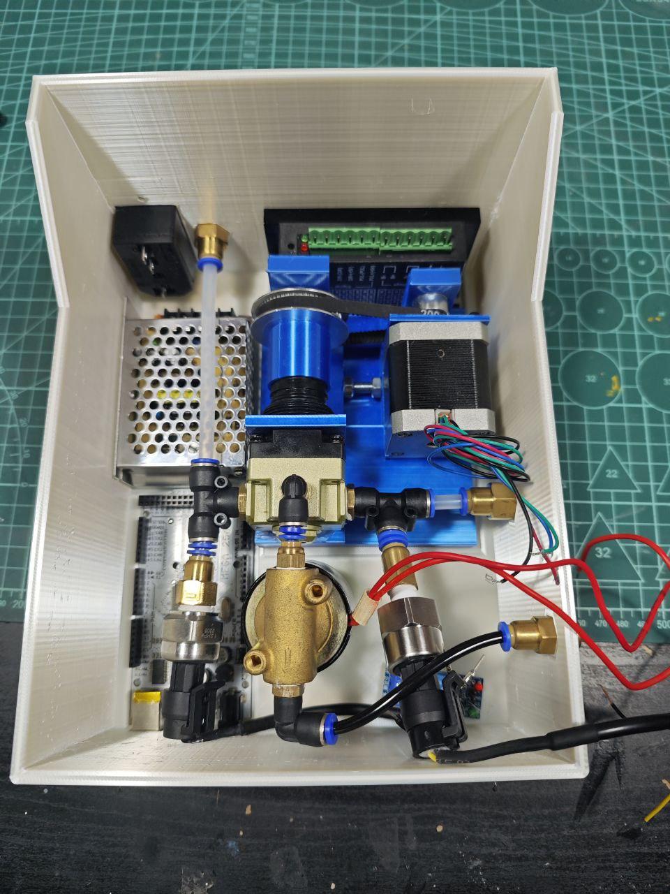

Step 2: Pneumatics / Neumatica
We will add the air connection tubes using a little Teflon on the threaded parts. The idea is that at the entrance to the pressure reducer there is a T, where the inlet pressure transducer will be connected. At the outlet we will place another T for the same purpose and where the clock is usually placed, we will place the solenoid valve and after it a silencer.
Añadiremos los tubos de las conexiones de aire usando un poco de teflón en las partes roscadas. La idea es que a la entrada al manorreductor tenga una T, donde se conectara el transductor de presión de entrada. En la toma de salida colocaremos otra T para el mismo propósito y en la que se suele poner el reloj, colocaremos la válvula solenoide y tras esta un silenciador.

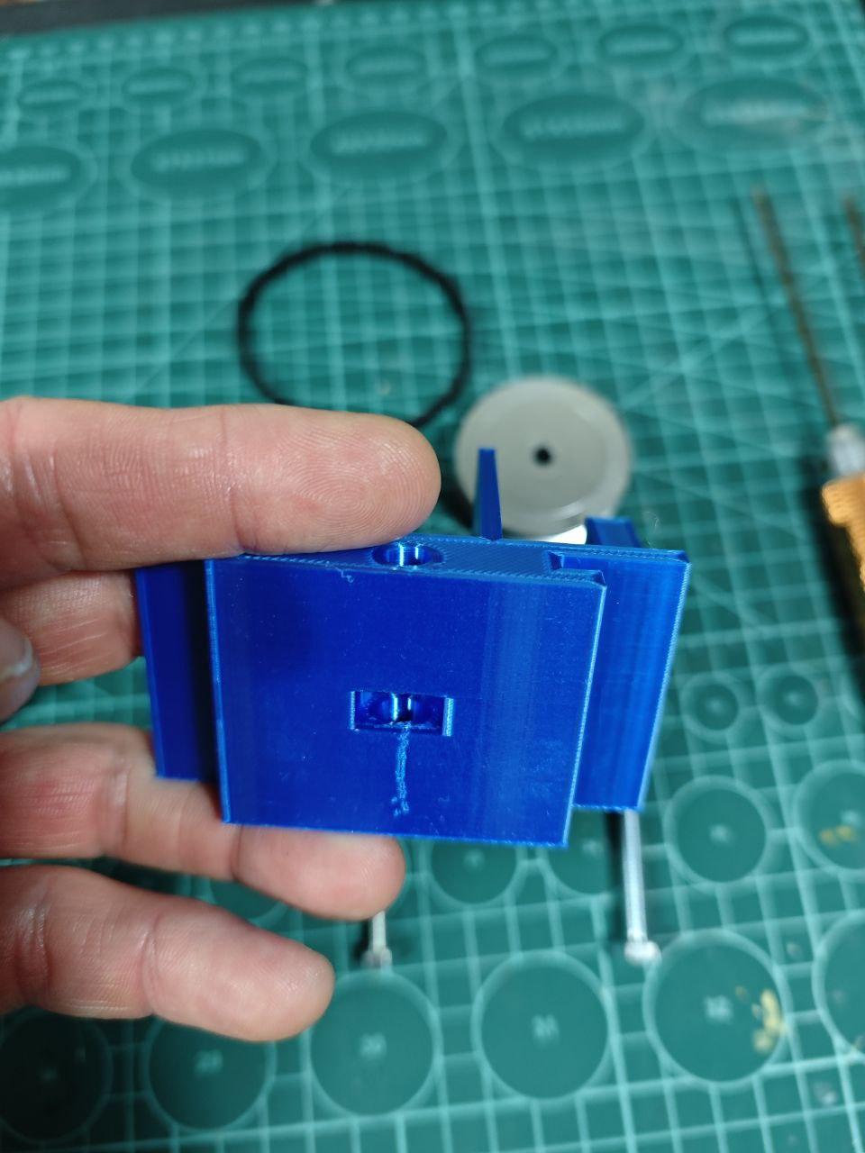

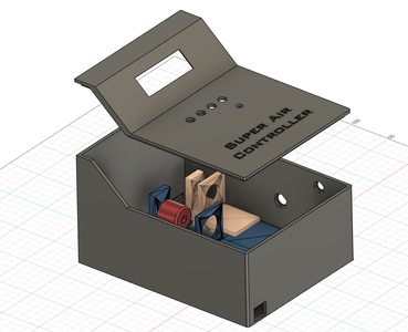

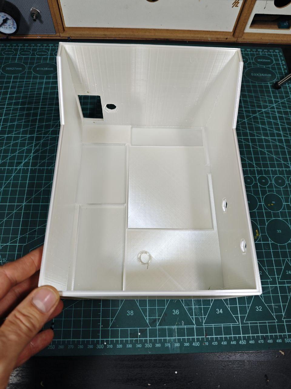

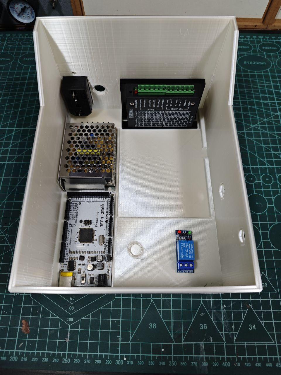

Step 3: The Box / La Caja
The design of the box was made in Fusion360 based on the size of the components, I have to say that it turned out to be somewhat large, not the box, but the entire assembly, I also know that it can be greatly reduced, either by using a larger Arduino small, a much smaller solenoid valve and an integrated circuit motor controller. However, I already had these things at home and I wanted to take advantage of them, and it is basically to give the idea and adapt it to your needs. The printing took me about 29 hours and 400 grams of PLA.
El diseño de la caja se a realizado en Fusion360 a partir del tamaño de los componentes, he de decir que a quedado algo grande, no la caja, sino todo el conjunto, también se que se puede reducir sobremanera, ya sea usando un Arduino mas pequeño, una válvula de solenoide mucho mas pequeña y un controlador de motor de circuito integrado. No obstante, estas cosas las tenia ya por casa y quería aprovecharlas, además que básicamente es para dar la idea y que lo adaptéis a vuestras necesidades. La impresión me llevo unas 29 horas y 400gramos de pla.

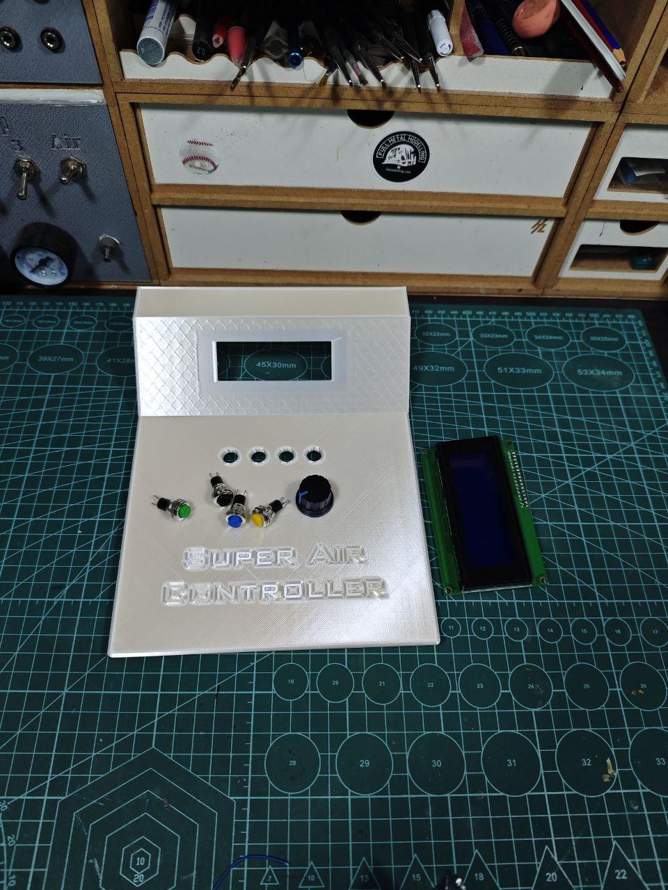

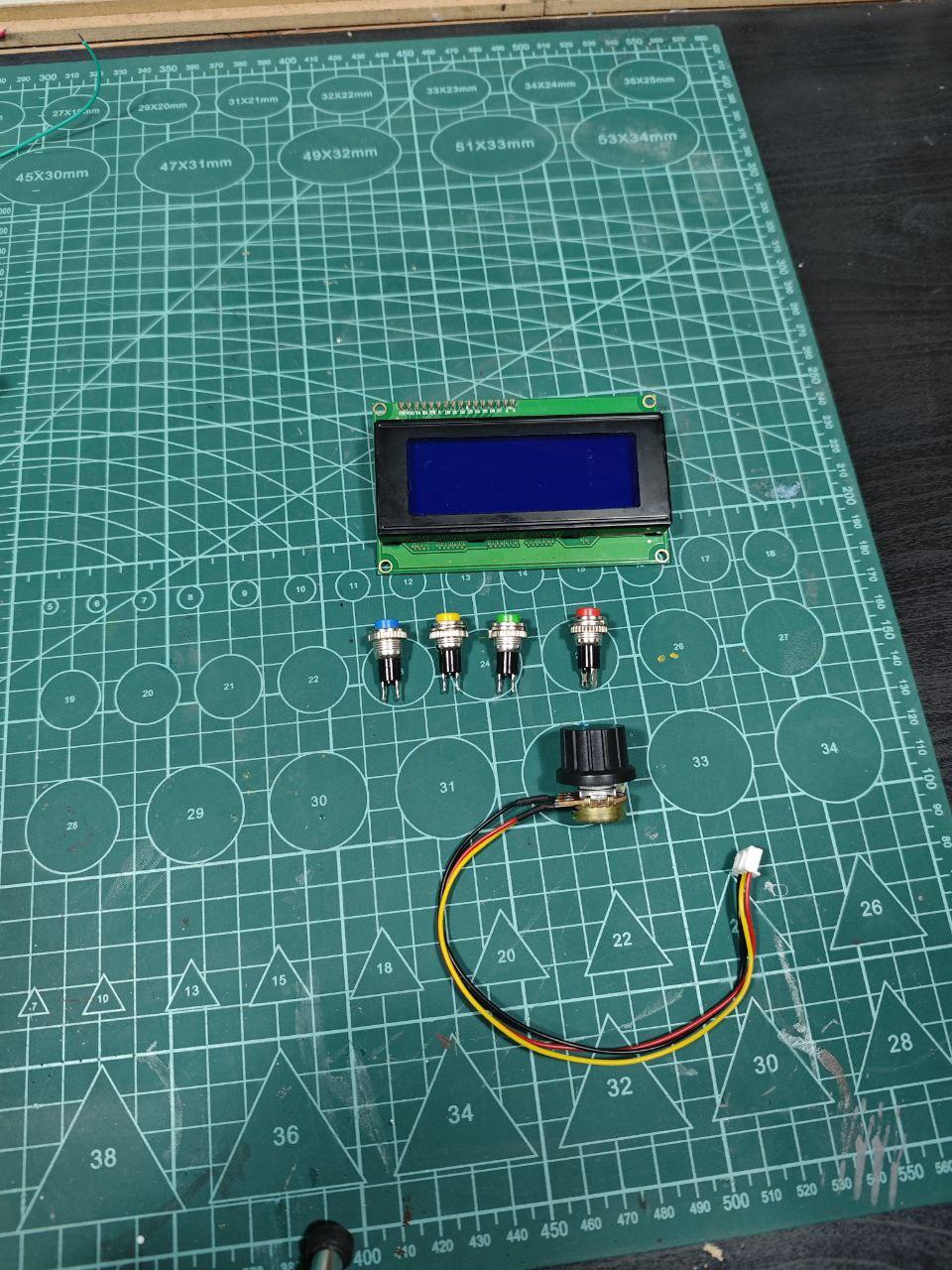

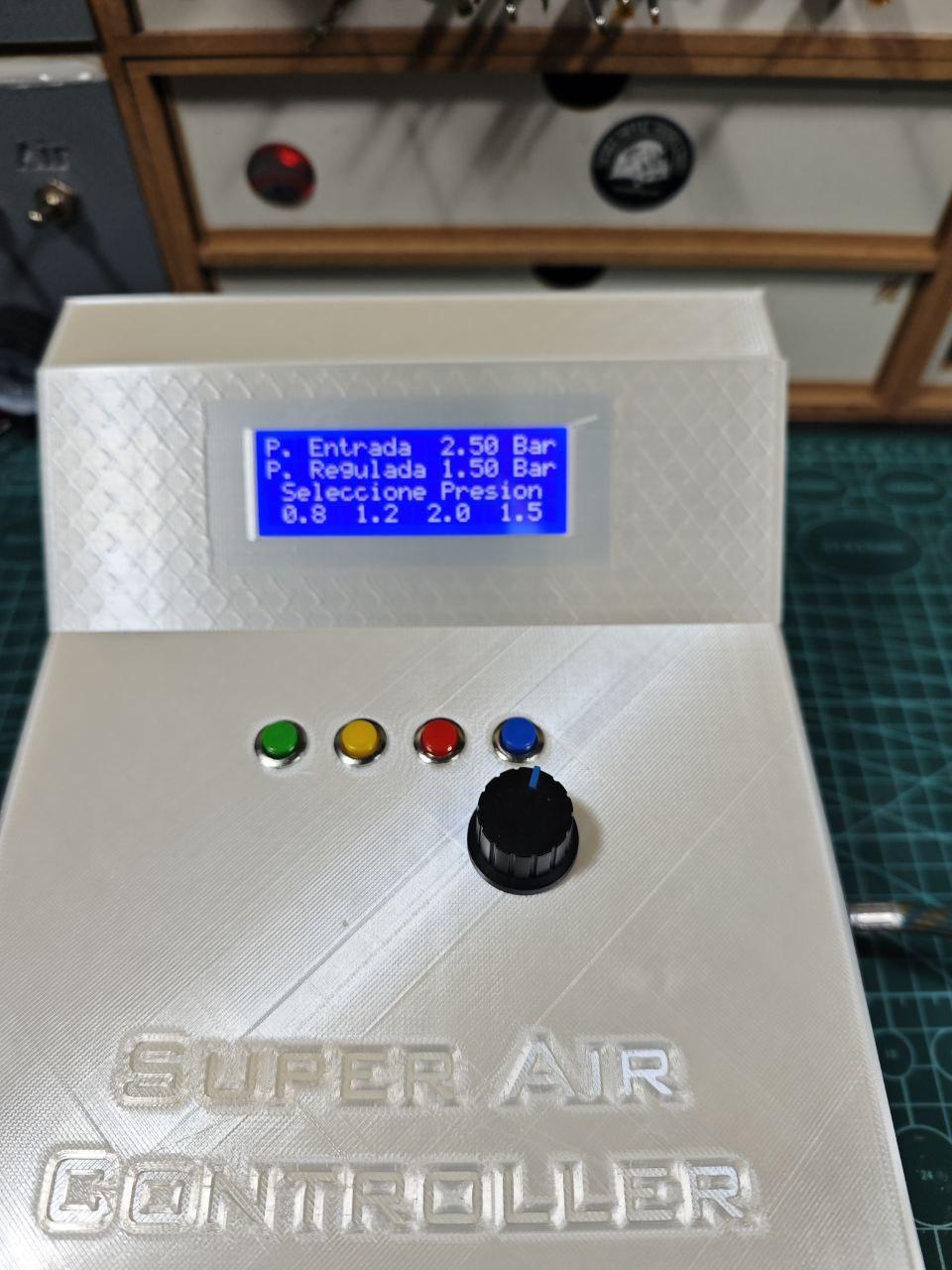

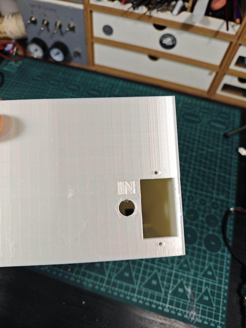

Step 4: The Cover / La Tapadera
The cover has holes to add 4 buttons, a potentiometer and the screen. There is no science to it and could easily be done even with MDF. The printing took about 12 hours and 100 grams of pla.
La tapadera tiene los orificios para añadir 4 botones, un potenciómetro y la pantalla. No tiene ciencia alguna y podría realizarse fácilmente incluso con MDF. La impresión fueron unas 12 horas y 100 gramos de pla.

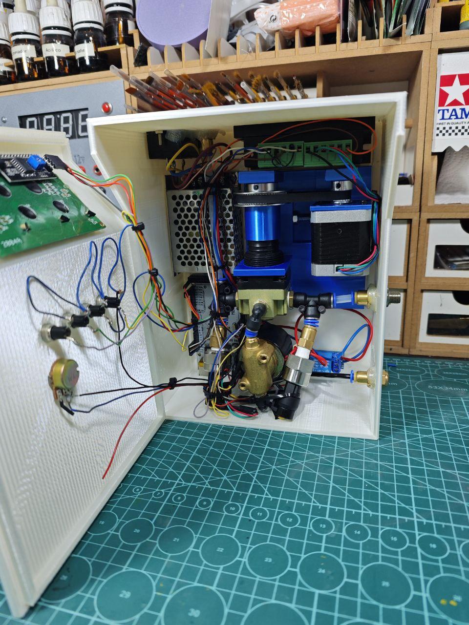

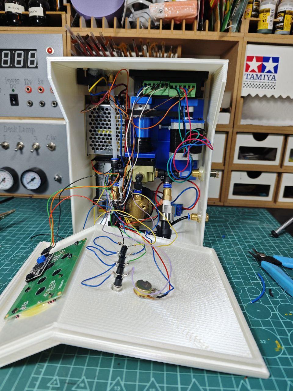

Step 5: Electronics / Electronica
I attach the electronic schematic, special care must be taken to place each cable in its corresponding pin as well as once placed, place clips to avoid the possibility of them becoming entangled in the motor.
Adjunto el esquema electrónico, hay que tener especial cuidado en colocar cada cable en su pin correspondiente asi como una vez puestos, colocar presillas para evitar la posibilidad de que se enreden en el motor.

The program itself is quite simple. We read the translators and print on the screen the values of both the inlet and regulated (outlet) pressures. At the bottom of the screen, we put some default values on the first 3 buttons. 0.8 1.2 2.0, the 4th button will be configured with the potentiometer that depending on where it is, will give a value from 0.7 to 3 bars.
Once we press the button with the value we want, if it is higher than the output pressure, it will rotate the motor clockwise, in turn rotating the pressure reducer, thus increasing the pressure. If we select a lower pressure, the motor It will rotate counterclockwise a quarter of a turn, it will draw air through the solenoid valve and if the pressure is still higher, it will repeat the process of continuing to rotate the engine counterclockwise for another quarter of a turn.

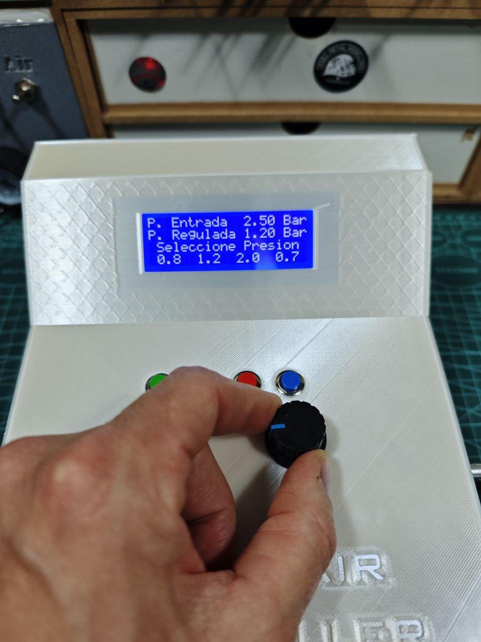

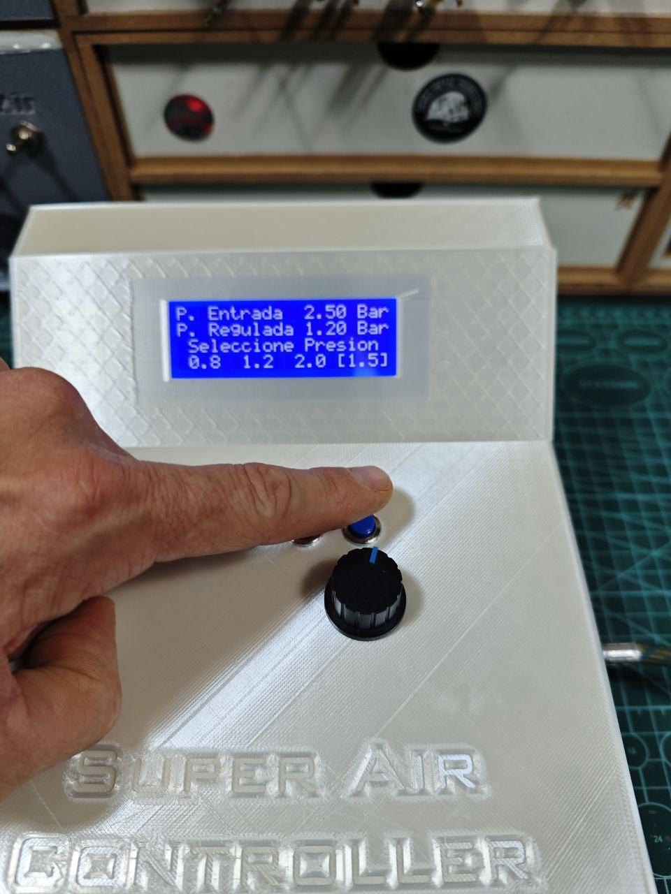

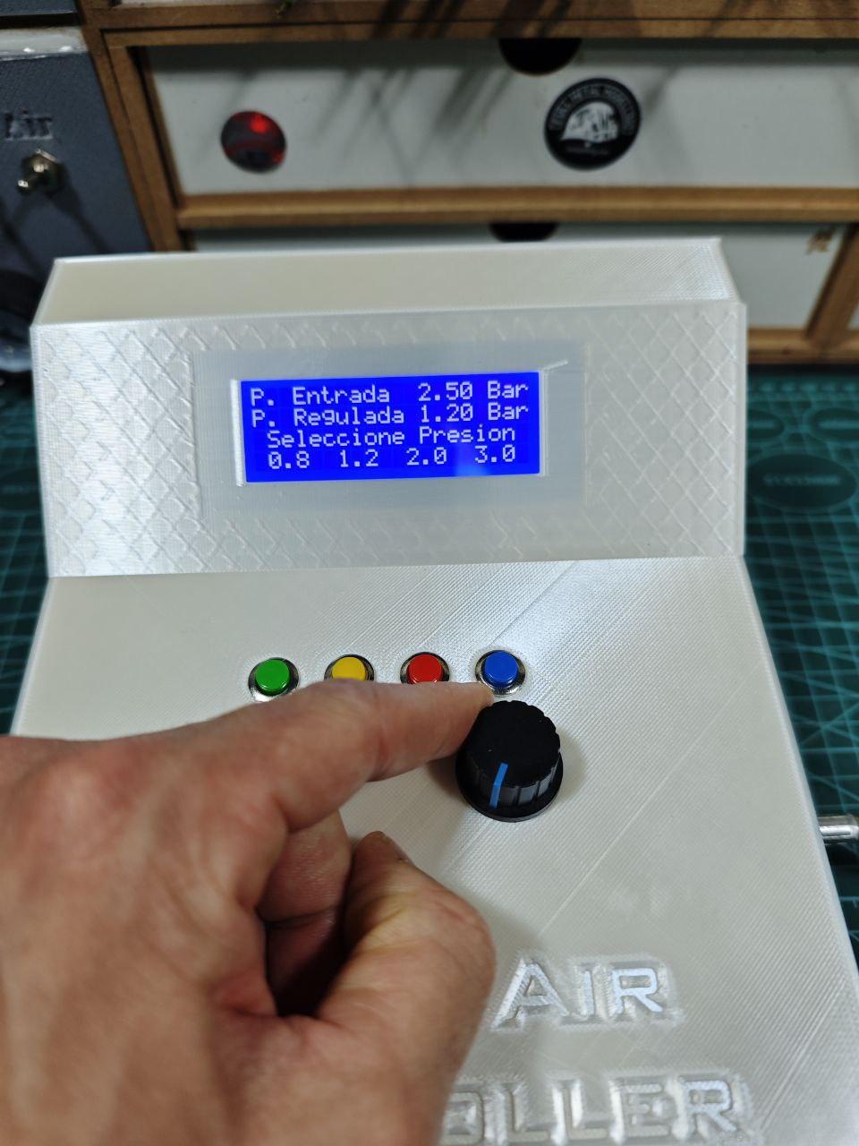

Step 7: FInal Test
Once the program is loaded we will proceed to turn on the device. We will select one of the defined pressures or using the potentiometer we will mark one, in the photos it has been adjusted to 1.5 bars and shown the range of 0.7 to 3 bars that the potentiometer gives. Then we will press the button on the potentiometer. It will be indicated with brackets while this pressure is reached. Once reached, the brackets will be deleted and it will be ready for use. I have it set to paint with the most common airbrush pressures and the smallest to connect it as an air supply for laser cutting.
