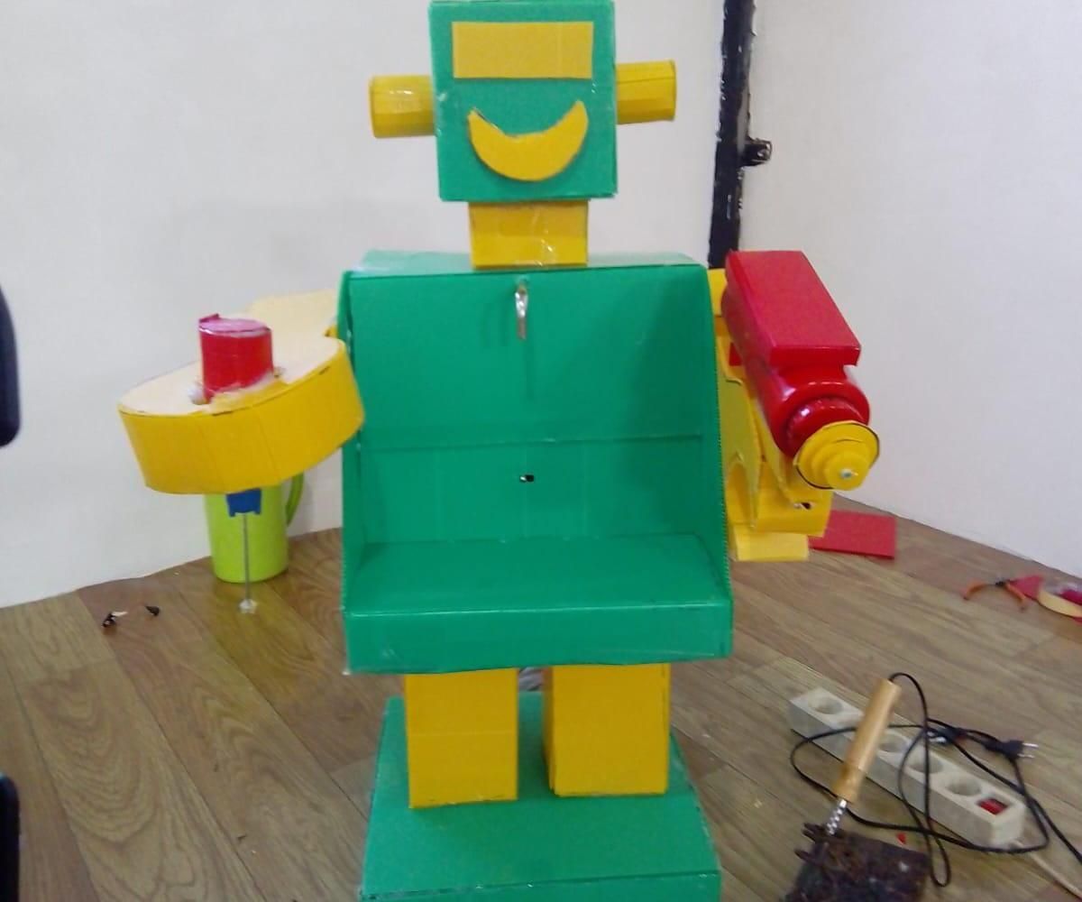

Step 3: Make a Cat Feeder
The method :
Arrange 6 cardboard boxes, 1 plastic can, 1 balloon stick and a gearbox motor as shown in the picture by gluing the cardboard with glue.

Step 5: Arrange the Component of Cat Feeder
The position of components on the cat feeder
