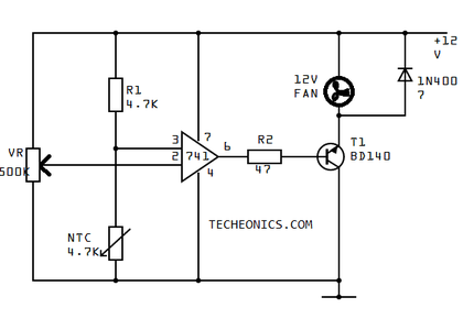

Step 1: Schematics
Schematics
Step 2: Setup the Circuit Board
Arrange the components on a circuit board in accordance with the schematic diagram.
Step 3: Connect the UA741 IC:
The UA741 IC should be placed at the center of the circuit. Connect its pins according to the circuit diagram.
Step 4: Integrate the NTC Thermistor:
the 4.7k NTC Thermistor acts as the temperature-sensing element. Connect it to the UA741 IC in the appropriate configuration.
Step 5: Add the Supporting Components
Install the 4.7k and 47 Ohm resistors, NPN transistor BC140, 10K potentiometer, and 1N4007 diode in their respective positions on the circuit board.
Step 6: Power Supply Connection
 Connect the 9V battery or DC source to power the circuit.
Step 7: Testing and Calibration
once the circuit is assembled, test its functionality. Adjust the potentiometer to calibrate the sensitivity of the temperature sensor.
Step 8: Integration With Fan
Finally, connect the output of the circuit to control the speed of a fan based on the detected temperature.
