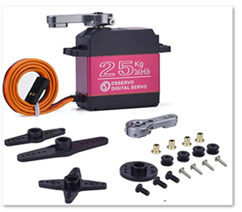

Step 1: Arduino Uno and Servo
Arduino Uno
You can purchase the Arduino Uno through the Arduino Official Store or Amazon, Sparkfun, etc. Cost: $20 on Amazon. Power: It can run on 7 to 12 volts DC.
Servo -25KG Digital Servo Full Metal Gear High Torque Waterproof. Cost: $19.77 From: https://www.amazon.com/gp/product/B0882W5P22 Power: can operate from 4.8v to 6.8v. 5 volts worked for me. It can draw from 1.8 amps to 2.2 amps.
After tweaking the swing arm and removing one "soft close" cabinet attachment, this servo was powerful enough to push our garbage can bin open more than half way open.

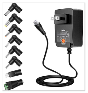

Power Supply
I used a Belker 36W Universal Power Supply up to 2500 mA. It needs to be powerful enough to drive both the Arduino and the Servo motor. Cost: $14.90 From: Amazon:
https://www.amazon.com/gp/product/B078LSVVTB
This power supply was perfect. I was able to set the voltage to an efficient level - 7.5 volts. It also came with different tips - one of which was perfect for the Arduino.

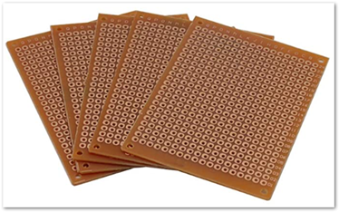

Breadboards and Perfboards
It's always good to keep some of these around. The breadboards are great for prototyping your circuits. Cost: 4 Pack for $5.99 From: Amazon, Sparkfun, Adafruit, etc.
I started out this project using a breadboard. I even mounted the breadboard circuit in the cabinet to test everything out. Eventually I soldered the circuit onto a perfboard.
Perfboards can be found here:
https://www.amazon.com/Nanlaohu-Perfboard-Breadboa...

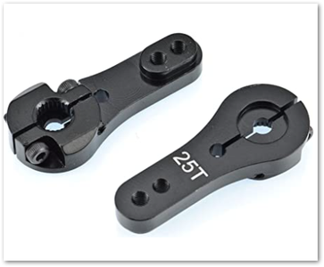

Step 4: ​Screws, PC Card Slot Cover, Ball Bearing, Nuts, Soldering Gun and Solder
Screws, PC card slot cover, ball bearing, nuts
You're going to need some supplies to make the arm that's attached to the servo. I scrounged up some supplies around the house as well as a trip to Ace Hardware. Love that store! Cost: Around $5
Take the servo arms with you to a hardware store, and ask them for help finding the necessary parts to construct the sweep arm. They're very helpful there. I basically constructed the arm in the store.

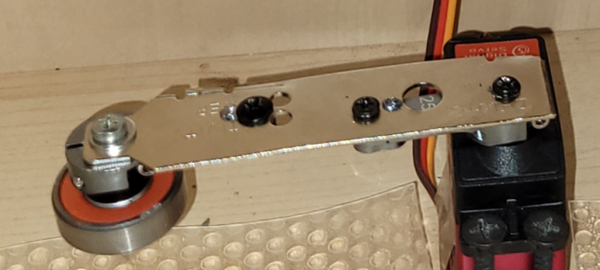

Step 6: Make the Servo Swing Arm
I took the two servo "horns" that came with the servo, and attached them to a PC Slot Cover, and trimmed the metal as seen above. At the end, I attached a cylindrical roller bearing with a bushing and some screws as shown above. The roller bearing cuts down on friction as it sweeps the back of the cabinet drawer.

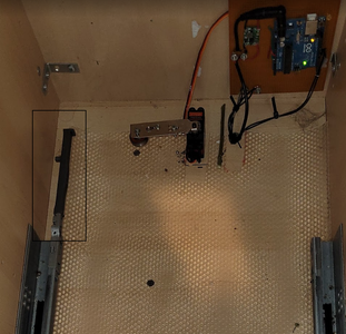

Step 8: Place the Servo
Follow these steps to easily line up where the servo needs to be mounted:
  1. Open your cabinet drawer, the place the servo up against the back of the drawer.
  2. The servo should be positioned such that the arm is pointing to your left, and can swing 180 degrees towards your right.
  3. Slowly slide the drawer all the way closed
  4. Open the drawer and use a pen to mark the locations where you will screw in the servo to the bottom of the cabinet.
  5. Pre-drill holes if needed,
  6. Screw in the servo.
  7. In the second image above, you can see one of those "soft close" attachments on one of the drawer rails. When your cabinet was installed, two of these may have been used. They're great for making drawer slow down and not slam. However, two of them create a fair amount of friction when opening drawer. I found that removing one, did not affect the "soft close" feature and helped reduce the friction so the servo can properly open the drawer wide enough. You'll have to figure out how to remove your soft close attachment. My cabinets came from IKEA. The soft close attachments came off fairly easily.
