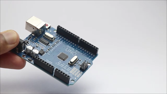

Arduino Uno from amazon

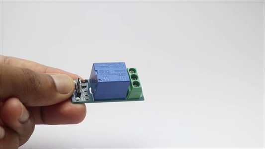

5V Relay Module

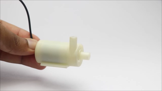

Submersible water pump

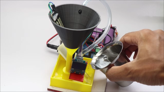

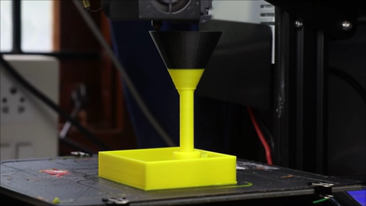

Step 1: Design and 3d Printing

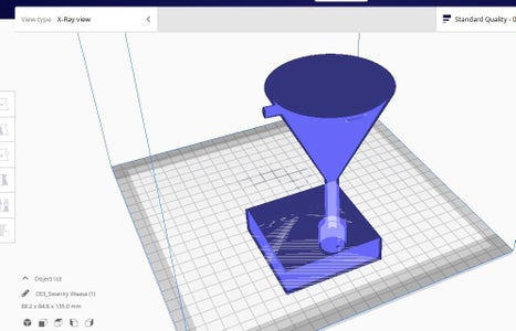

I made the design using TINKERCAD and you can edit my original design here

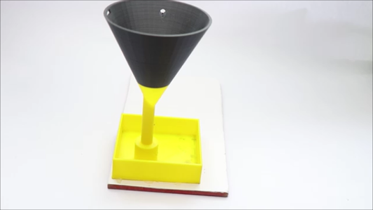

The most challenging part of this project was to make a design that serves several purposes, Now you may wonder what are those purposes?
Design should be stable enough to hold the soil and plant and it should be elevated so that pests are out of reach

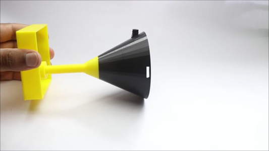

So i came up with this design, the base holds as a reservoir to hold the water, the top is in the shape of a funnel with a hole in the center that will squeeze out the excess water that will cause stagnant water and spoil plant growth
The design has a slot to flush out excess water and also a place to hold the soil moisture sensor
In case if the electronics break and if the pump continuously pumps water then nothing to worry the overflow slot will flush out water by itself and all this happens without a drop of spillage anywhere on the part
How cool this is isnt it? In the images on the step above i also have given you a xray view of the part so that you can see the inside of the part where the water circulation happens
You can simply import my design to your slicer and slice the model considering the default setting that i have shown in the steps above
I made design in such a way that there is no need of any rafts or supports at the time of print and also it eliminates the need of post processing the model after it is printed
I chose combination of yellow and black color to print and this choice is left to you
Print time was around 5 hours in my case and this may change depending on the type of printer and settings

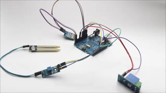

Here is the electronics circuit for this project, you may seem it difficult at the first view but is easy than you think
Let me break it down with an explanation component wise so that it is easier for anyone

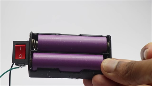

I will divide the project into 2 parts since we are using 2 different type of battery to power the project

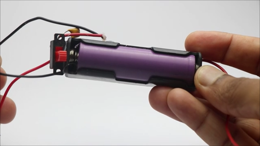

The first is the dual battery that will power the uno board and the other is single battery pack that will power the relay and submersible water pump
So here are the component connections

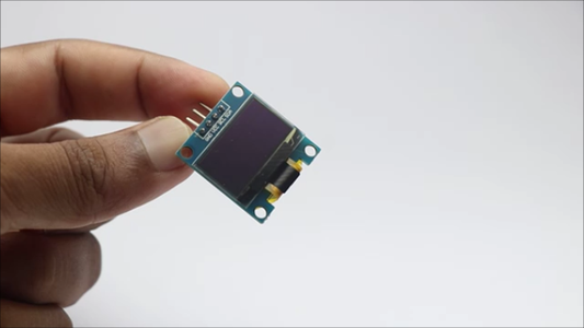

OLED module connections
Sda to A4
Scl to A5
Gnd to Gnd
Vcc to 5V on Uno

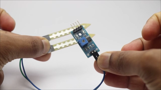

Soil moisture sensor
A0 to A0
Gnd to Gnd
Vcc to 3.3v pin on Uno
Relay Connections
IN to D7
Gnd to Gnd, Vcc to 5v on Uno
Com to positive of battery
Negative of battery and pump to NO of relay

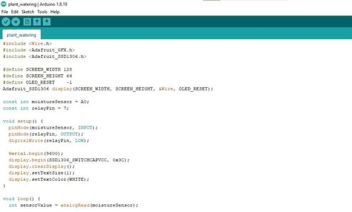

After the circuit is complete we can upload the code to board, Simply copy and paste the below code to IDE and then select proper board type and port and click on upload
Now after the program is done uploading we are good to go and test the circuit before installing electronics on piece of board

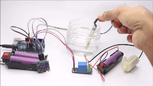

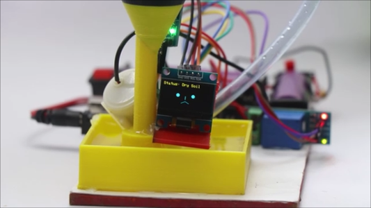

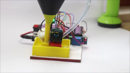

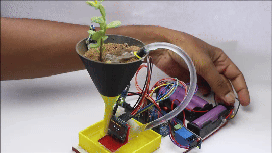

To test if the circuit is working fine simply take a cup of water and then power on the arduino uno board first and then the pump part of power supply
When the sensor is not dipped in water the OLED will show a sad face and DRY status message and now the pump will turn on untill the moisture sensor detects water content
When the sensor detects water the OLED shows watering and then the face becomes happy, and now the pump will stop automaticlly and again after a long time if the sensor detects no moisture the same actions will be repeated

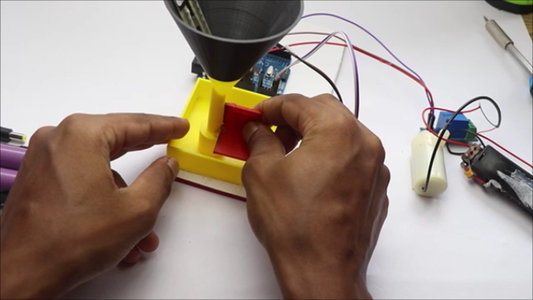

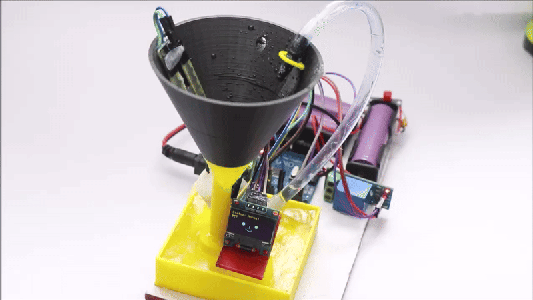

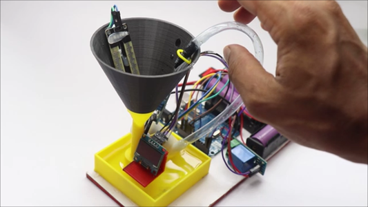

Now since you have checked the circuit we can assemble all this componnets on a piece of cardboard and later place the printed thing on it and asssemble it with all the sensors
The OLED part should be placed in a safe place and i have placed below the funnel, the soil moisture sensor has a dedicated place and you simply place and glue it there
The hose of the pump was new and it was difficult to work on so i made a small hook and placed it inside funnel, Follow the same placements so that the system works without any hassle
The pump that i used earlier lacked performance so that i had to replace it with new one, You can see that in the video
At this point we are almost done with the project, We can now head over to testing this project
Step 4: How to Use
Using this is very simple and since you have built this projrct you will already know how to use but still let me explain you a proper step to use this project

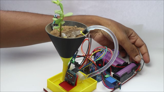

You should make a note that this project needs separate power supply and if you use the power from USB the project wont work as expected so i chose uisng a 7.4v battery pack
Power on the swich and now you have the OLED module showing the status and now power on the pump(relay)supply

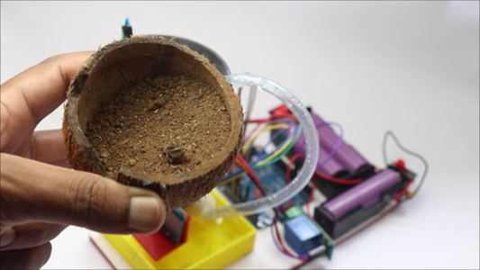

I filled the funnel(pot part) with soil and planted a plant that will be growing here, Later to the base fill up with water or any nutrient water if you have any
The first time the pump will wet the soil until the sensor is finally wet and stops the relay from water more, Now the OLED face will show happy and now we have a ready system that will take care of itself
You dont need to worry about water overflow since we have a slot to drain that and also from the inside we have a space that will allow circulation of water
