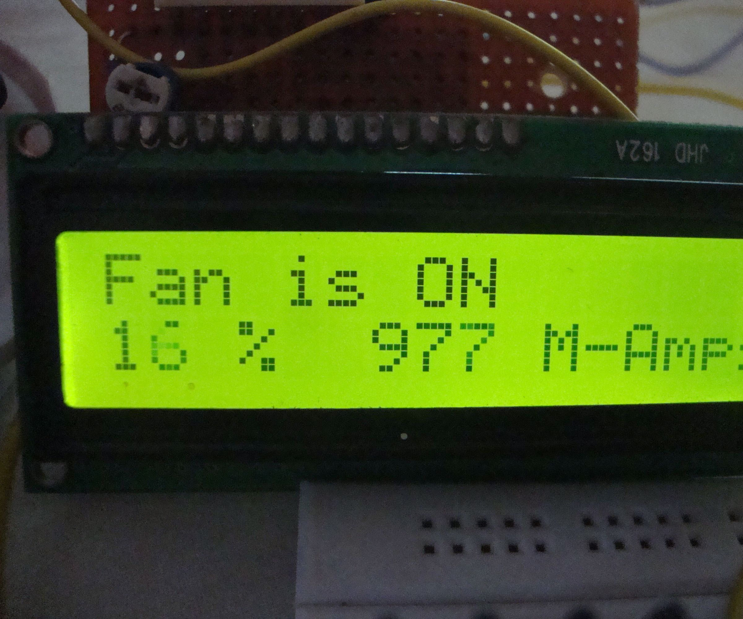

In This Model we are going to combine a temperature sensor and an fan and are going to program the arduino to handle the analog output from the sensor and use it to determine if the temperature is okay or High .
if the temperature is high then fan will start automatically and a Warning message will be displayed on the LCD Screen....

Step 2: The Circuit !!
connect the circuit as shown in the fritzing diagram.
the reading of LM35 goes to arduino pin A5.
the lcd wiring is as follows :-
* LCD RS pin to digital pin 7
* LCD Enable pin to digital pin 6
* LCD D4 pin to digital pin 5
* LCD D5 pin to digital pin 4
* LCD D6 pin to digital pin 3
* LCD D7 pin to digital pin 2
* LCD R/W pin to ground
* 10K resistor: ends to +5V and ground
* wiper to LCD VO pin (pin 3)
