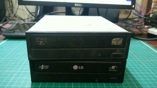

Step 1: CD-ROM
Now a days CD drives are not used regularly .So you will Get cd rom for cheap price

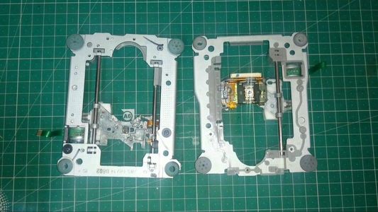

Step 2: Stepper Motor
Dismantle the CD- ROM so you will get two stepper motar

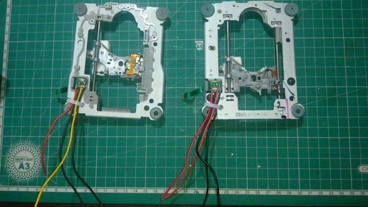

Step 3: Soldering
Solder the four leads in the stepper motor

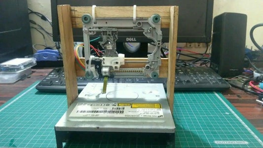

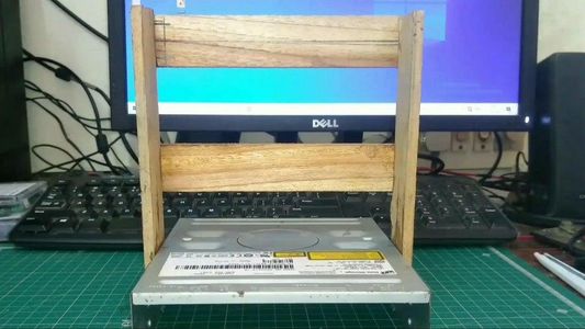

Step 4: Frame
I made this frame by using CD-ROM chase and some old woods
Step 5: Setting Up Y Axis
Set your "Y" axis stepper motor in vertical postion
Step 6: X Axis
Set your "X" Axis Stepper motor in Horizontal Postion

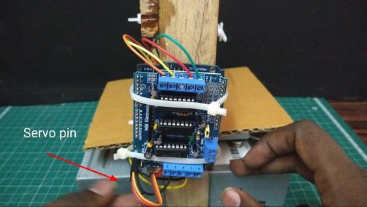

Step 7: Servo Motor
Servo motar used to lift pen up and down . So place the servo motor in Y axis

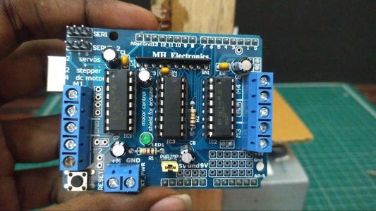

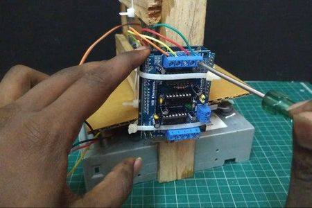

Step 9: L2939 Motor Driver
Motor shield Used to control Two Stepper motor
Step 10: Wiring X and Y Axis
Step 11: Connecting Servo to L293d Motor Driver

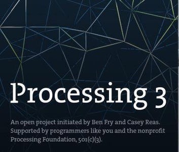

Step 13: Secondly How Upload Your Processsing Code
Step 14: Press P to Select Port Number & Press G to Select G Code

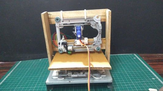

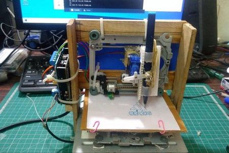

Step 15: Final Output
