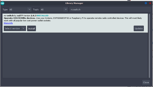

I assume that you already have some familiarity with Arduino and the paired IDE, if you are not familiar please see this link to install a guide: https://www.arduino.cc/en/guide/windows
We will be recording the RF commands that the RF remote broadcasts to control the lights or outlets, using the receiver module. We will then retransmit them with the transmitter and thus control the lights with our microcontroller. In order to do this we will leverage the RCswitch library. Please search your Arduino IDE, under Sketch> Include Library> Manage Libraries, then search for RCSwitch and install that library.
Next you will need to plug the NodeMCU into the PC and upload the below code. This code also exists in the examples section of your Arduino IDE after the RCSwitch library is installed.

Step 3: Recording RF Controller Codes for Parroting Part 2
I am assuming you already have NodeMCU Libraries installed, if not please follow this tutorial:
https://www.instructables.com/Steps-to-Setup-Ardui...
Next you will need to wire your receiver to your NodeMCU using the below configuration. For this use case you probably will not require an antenna or additional 5v capacitor. Now while the NodeMCU is connected to your PC open up your Serial Monitor, under Tools> Serial Monitor. Then you need to press each of the buttons on your RF Remote, you should see RF Codes and associated with the presses appear in the Serial Monitor. Take note of these values for the next step.
