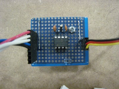

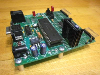

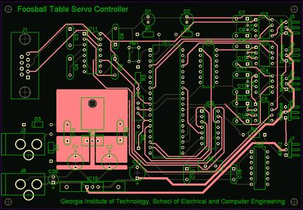

The attached images are a full circuit schematic as well as a picture of the final product for the motor control board. All of these required parts may be purchased at most major online electronics stores (including Digi-Key and Mouser. As a side note, all of the parts used here were through hole, and thus, the parts may be assembled on a protoboard/breadboard, or using the attached PCB design. A much smaller package could be created by using a number of surface mount parts.
When we implemented, the design, we split the motor controls into 2 circuits, though there is no advantage to doing so other than any particular cabling scheme used. The small blue board implements the PWM control circuitry, which is basically just a clocked PIC-12F with some specialized code.

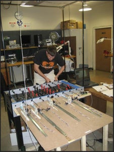

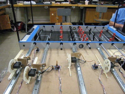

Step 2: Servo Motor Assembly
Two different types of servos are used. First, the lateral motion is controlled by a group of four high-torque servos: Robotis Dynamixel Tribotix AX-12. These four run on a single serial line and provide amazing functionality. The high torque enables these servos to be geared in such a way that provides a high tangential velocity for lateral movement. We were able to find a set of 3.5 inch gears and tracks to go with them from Grainger at a cost of about $10 for each. The servos provide torque overload protection, an individual servo addressing scheme, quick communications, internal temperature monitoring, two-way communications, etc. The downside of these servos is that they're expensive and not very fast (though gearing helps them). So in order to get faster motion for kicking, Hitec HS-81s are used. The HS-81s are relatively inexpensive, have a decently fast angular velocity, and are easy to interface (standard PWM). The HS-81s only rotate 90 degrees, however (though it is possible -- and not recommended -- to attempt to modify them to 180 degrees). Additionally, they have internal nylon gears that strip easily if you attempt to modify the servo. It would be worth the money to find a 180 degree rotating servo that has this type of angular velocity.
The entire system is tied together with pieces of medium-density fiberboard (MDF) and high-density fiberboard (HDF). This was chosen for its low cost (~$5 for a 6'x4' sheet), ease of cutting, and ability to interface with virtually any surface. A more permanent solution would be to machine aluminum brackets to hold everything together. The screws holding the PWM servos in place are standard machine screws (#10s) with hex nuts holding them from the other side. 1mm metric machine screws, about 3/4" in length, hold the AX-12 into the MDF that connects the two servos together. A double-action drawer track holds the entire assembly down and in-line with the track.

A Philips SPC-900NC webcam was used, though it is not recommended. The specs for this camera were falsified either by the engineering or sales staff at Philips. Instead, any cheap webcam would do, so long as it is supported by the operating system. For more information regarding the use of webcams under linux, check out this page.
We measured the distance required by the webcam's focal length to fit the entire foosball table in the frame. For this camera model, that number turned out to be just over 5 feet. We used shelving racks available from any major hardware store to build a mount for the camera. The shelving racks extend upward from each of the four corners of the table and are cross-braced by angled aluminum brackets. It is very important that the camera is centered and has no angular rotation, since the software assumes the x- and y-axis are aligned to the table.
