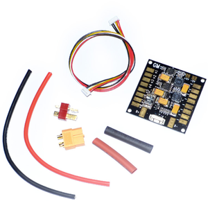

- power distribution board http://bit.ly/1roQpFl

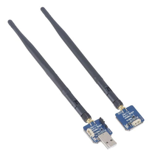

- telemetry radio http://bit.ly/1OJZE65

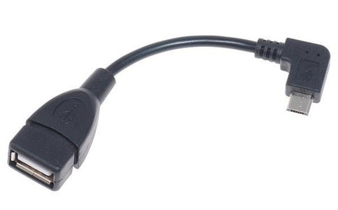

Optional: you will need a USB OTG cable if you want to connect with your android device.

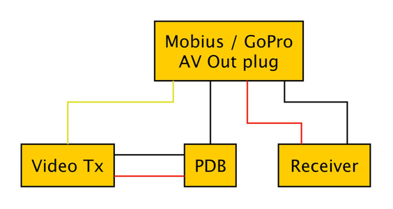

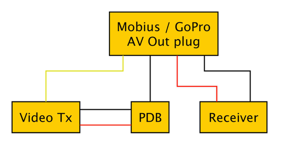

At this point I prepared the AV cord to connect the video-out port of my Mobius action cam to the video transmitter. I cut the yellow wire of the Mobius cable from its servo plug and soldered it to the yellow wire of the video TX plug. Leave the Mobius power plug alone if you want to power it off the flight battery.

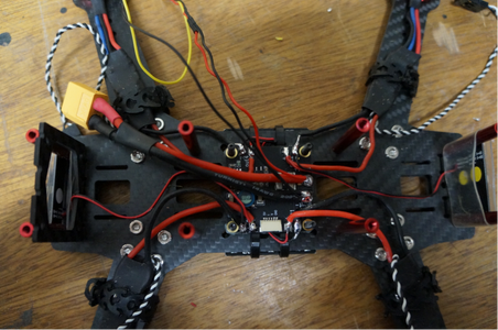

- Attach the power distribution board (PDB) to the quadcopter frame.
- Solder on the battery lead to B+ (red) and B- (black) and the ESCs to the pads on the side.
- If you’re using a 3S flight battery, the side pads will be running 12v so you can put your LEDs and video Tx anywhere. If you’re running 4S or more, there is a dedicated 12v output at the top that you can solder them to.
Solder the lonely ground wire from the Mobius cable (you cut its yellow companion) to any ground (-) pad on the PDB.

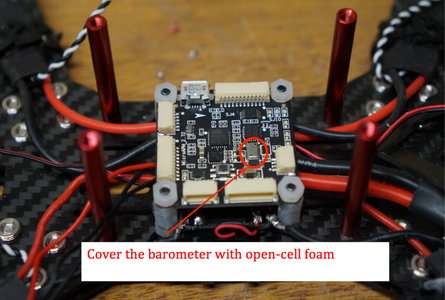

Step 5: Attaching the Flight Controller

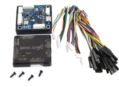

I removed the case of the Ardupilot to mount it on the existing centre stack screws. You can choose to remove the case or find another way to mount it. If you do remove the case, you have to hot glue some open-cell foam over the barometer so it is not affected by the prop wash.
Screw on nylon spacers and place the Ardupilot flight controller above the PDB with the arrow facing towards the front of the aircraft.

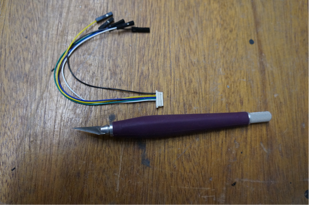

Unpack the other 10-position cable from the mini Ardupilot bag. You can use a scalpel / x-acto knife to lift up the tabs on the white plug and remove the four wires farthest from the black wire, or you could cut them off with side cutters.
You have three choices of how to power your Mobius / GoPro from the flight battery. One option is described in this step, and alternatives are described in on the following two steps. This step is permanent and involves cutting wires. The two alternatives are non-destructive and reversible.
If you choose this method, cut the red wires of the Mobius cable and the 10 positions plug, and solder them together.
If you do not choose this method, remove the red wire.

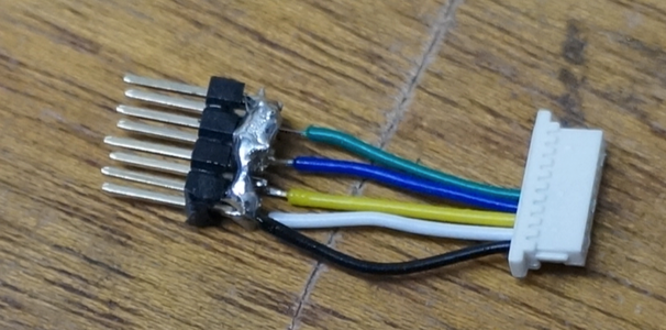

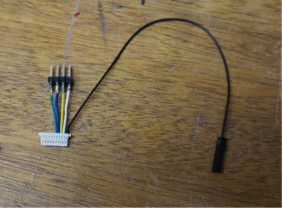

For some reason, the wire harness has all female plugs despite the fact that all ESCs also have female plugs. So we’re going cut off all the ends and make them into a combined 4-pin connector.

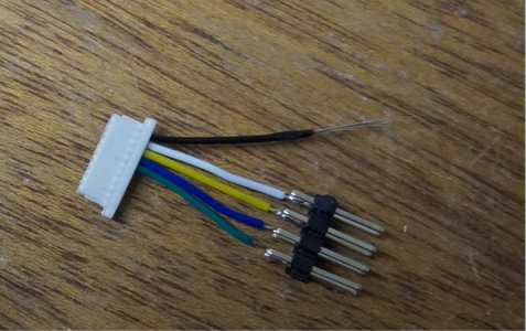

Break your header pin rack so you have a 4x2 block.
Hold the black wire aside. Cut the other 4 wires about 5cm long. Solder the ends to the short side of the top row of header pins. Hold the wires with pliers while you strip the insulation, otherwise you will pull it out if the plug. If this happens, it probably damaged the metal connector, so replace it with one of the other wires you removed.
Cut the black wire 1cm longer than you cut the other wires. Strip 1cm of insulation from the end and solder it along the bottom row of header pins so it connects them all together.

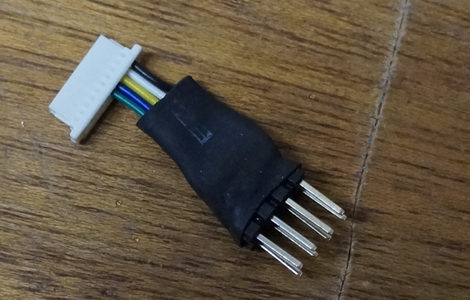

Heat shrink or electrical tape the solder joints.
Mark which row is ground and which row is signal. I you forget, you can use a multimeter to test. Set the multimeter to continuity (the one that beeps when the probes touch) and whichever row beeps when two of its pins are touched is the ground row.

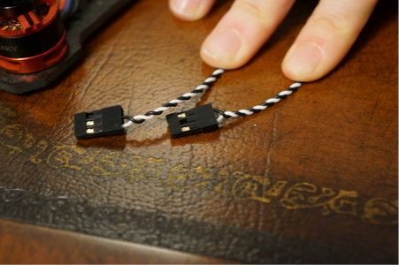

The ESCs most likely have only two wires in a three-position servo plug, with the middle position empty. If they have a red wire in the middle position, remove it.
This won’t plug into your 4x2 header plug so you have two choices.
- NOT RECOMMENDED: You can move the black wire (using the scalpel / x-acto knife to lift the tabs) to the middle position. This is NOT RECOMMENDED, as the ground wires are now in the standard power position. If you move these ESCs to another machine and forget to move the wire back, it will short our and blow something up.
- RECOMMENDED: Use the scalpel / x-acto knife to lift the tabs and remove the single plugs from all those wires you just cut off. Remove the plugs from the ends of the ESCs and put on the single plugs.

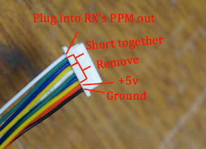

Unpack the other 10-position cable from the mini Ardupilot bag. You can use a scalpel / x-acto knife to lift up the tabs on the white plug; pull out both yellow wires and everything between them.
Or you can cut them off with the side cutters. All you need are the black and red wires, and the first three wires on the opposite side of the plug.
Short the 2nd and 3rd wire together. If you’re ok with it being permanent, the best way to do this is to cut the wires pretty short, (~4cm), and solder them together. Don’t forget to insulate the solder joint with heat shrink or electrical tape. This tells the Ardupilot to listen for a PPM signal on wire 1.
Plug the PPM signal, 5v and ground wires into your PPM receiver.
If you have spare power and ground pins on your receiver, you can plug in the Mobius / GoPro power plug here to power it from the flight battery.

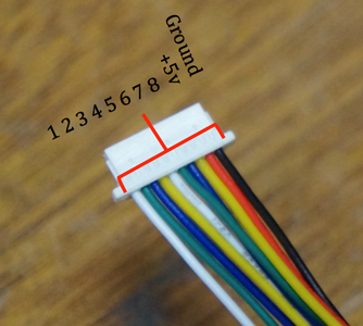

Unpack the other 10-position cable from the mini Ardupilot bag. You can use a scalpel / x-acto knife to lift up the tab of the plug on the wire closest to the red wire and pull the plug away from the metal wire end. See the pictures. Slide the wire into the spare slot in the Mobius power plug if you have one.
Now plug all the wires into the receiver. The plug coming from the Mobius is channel 8, the red wire can go into any power pin (centre row), and the black wire into any ground pin (bottom row). Work your way back from the red wire, and plug in each wire along the top (signal) row in descending order. The wire farthest from the red wire is channel 1.
