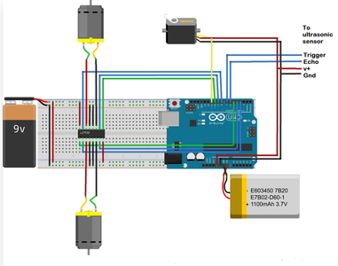

> Follow the steps below for connecting the micro-controller (Arduino Uno) to the ultrasonic sensor, L293D driver and the servo motor.
Circuit diagram:
Connections overview>
Servo motor- signal wire to pin 11 on Arduino Uno
Ultrasonic sensor- Echo pin to pin 6 on Arduino Uno
Ultrasonic sensor- Trigger pin to pin 7 on Arduino Uno
L293D IC- Input 1, 2 (motor 1) to pin 3, 4 on Arduino Uno
Input 3, 4 (motor 2) to pin 8, 9 on Arduino Uno
Enable 1 (motor 1) to pin 5 on Arduino Uno
Enable 2 (motor 2) to pin 10 on Arduino Uno

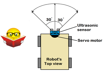

Function of the program:
> The ultrasonic sensor is swept 30 degree towards left and right from servos centre position.
> This determines the range of object on the left and right of the robot’s front end.
> The distance is compared and the robot is moved along the direction which has obstacle at a longer distance. > This is looped again and again and the robot moves in a confined space by avoiding the obstacles in its way autonomously
