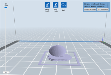

Ok, here is the truth. The reason I wanted my players to be 3.5cm in the previous step is because I'm using a 3D model that is pretty much that hight. I also believe that it is good height for table top players to be.
The link to the player STL files if you are going to print your own:
Player STL file
The only change I've made to printing these, was to copy and paste them a couple of times so I can reduce the amount of prints.
But as stated in the supplied, you can make your own players. Simply cut a cardboard of around 3.5cm x 1cm and glue it on another piece of card board so it stands upright. This way you don't have to have human players either. You can customise that cardboard with all sorts of colours and mutations.

Step 4: The Ruck Decider and Footy Ball
The ruck decider's job in the game will become more evident through the rules. However, for it, you can really use any cone shaped object of around 2cm high.
The footyball should be an oval shaped ball. This will help with the randomness of the ball movement and add to the strategies in play on the field.
I've included the STL files for the ruck decider and the footyball I created via Tinkercad.
