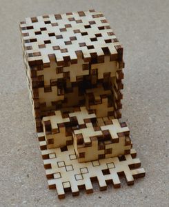

Before you start assembling BöxliSpiil you need to determine the distribution of pegs on the inside of the faces, according to the desired complexity.
Download and print the attached PDF. It shows an unfolded dice as in the first picture. That is the inner sides of our puzzle.
The blue fields are inner fields not shared with other faces and are thus always occupied by a peg. The corners (yellow) share three faces and the edge fields (green) share two faces. Each field containing a symbol is thus shared over two or three faces. If you decide to put a peg on one face it must stay free on the other ones (eg: only one "D" can be occupied). The second picture shows the distribution I randomly chose for this tutorial.
Simple games will have an uneven distribution, having faces with 6 or more pegs and others with 3 or less pegs. The more evenly you distribute the pegs (4 or 5 pegs per face) the more difficult it will be.

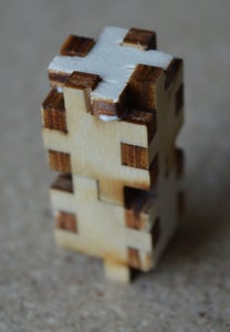

- Put the peg's sides in a row outside down, fix them with your fingers and apply glue like in the picture.
- Fold them up.
- Apply glue to the backside of the peg's topside and put it on the peg.
- We recommend to place the pegs on the faces while they are still malleable. Once the glue has dried they possibly won't fit onto the faces anymore.
