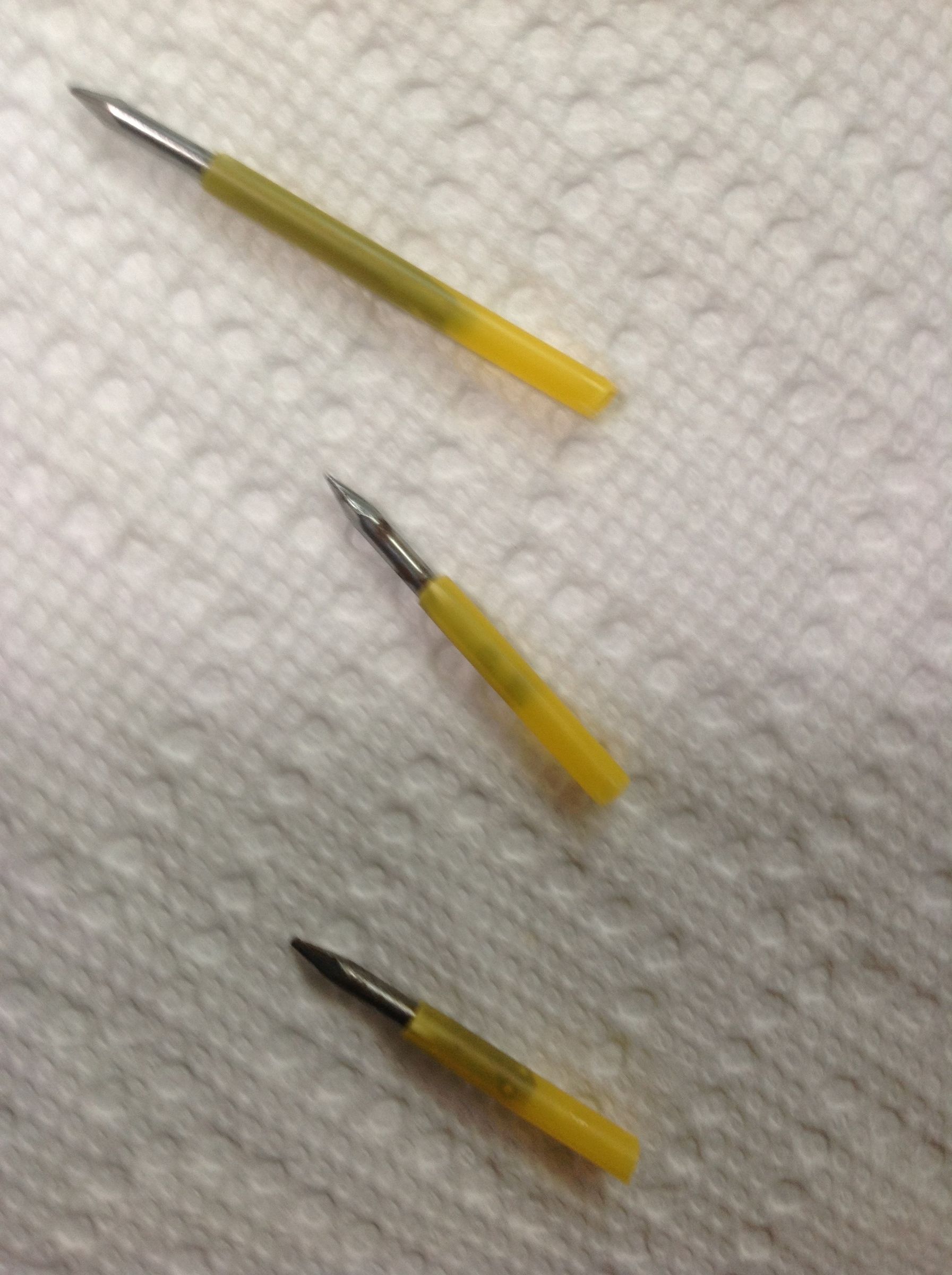

Step 1: Cutting the Nails
Using the wire cutters, cut the nails right near the head. The wire cutters do not cut the nails evenly, so a sharp edge is left on the nail near the head. The picture with the pellet shows what the cut nail should look like (left). Make sure to keep the end of the nail with the head.

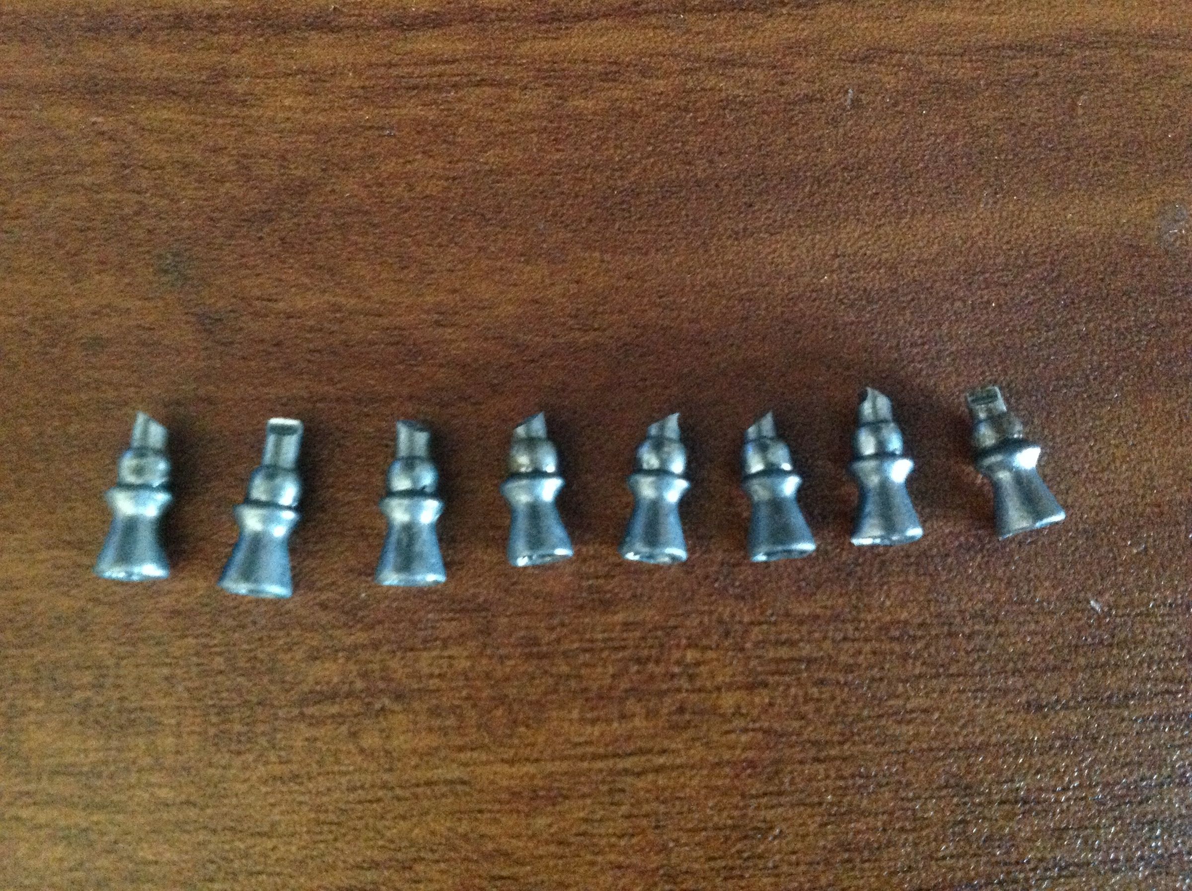

Step 2: Attaching the Nail to the Pellet
Simply apply a drop of glue onto the pellet, and put the nail on. Let it completely dry, and the pellets are ready to use.
