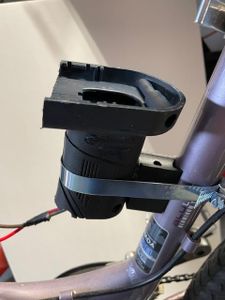

Step 2: ATTACH MOTOR TO REAR WHEEL STRUT
Check that the motor can fit on the strut with the drive wheel touching the side wall of the bike tire.
Slit the rubber hose and place it over the strut to provide spacing, cushioning and a good non slip fit for the motor. Secure it in place with the two gear clamps making sure that the drive wheel fits firmly against the bike tire with no slippage.

Gear clamp the battery holder securely to the frame so the battery can be removed easily for recharging. Connect one side of the motor to one of the battery holder leads. Connect the other battery holder lead to one side of the switch. Connect the other side of the switch to the remaining lead on the motor. Use the wire stripper to bare the leads and use crimp connectors to join the wires. Zip tie the wires to the bike frame. Be sure to leave enough length at the handlebar so you can still steer the bike.
Plug in the battery. Put the bike on the kickstand so the rear wheel is off the ground. Keep hands away and hit the switch. If the wheel turns the wrong way, reverse the leads to the motor. Make any last minute adjustments. Take it for a ride. It is wise to get the bike moving before you switch on to reduce strain on the motor. Watch the attached video.
