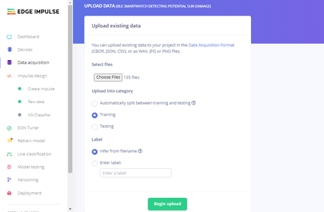

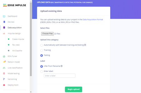

After completing my data set, I built my artificial neural network model (ANN) with Edge Impulse to make predictions on sun damage risk levels (classes) based on UV index, temperature, pressure, and altitude measurements. Since Edge Impulse is nearly compatible with all microcontrollers and development boards, I had not encountered any issues while uploading and running my model on XIAO BLE. As labels, I employed the empirically assigned sun damage risk classes for each data record while collecting data outdoors:

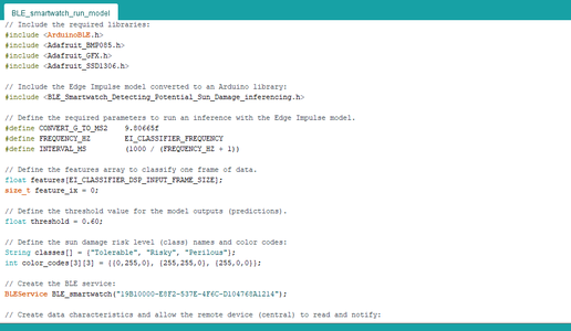

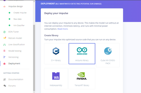

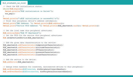

After training and testing my neural network model, I deployed and uploaded the model on XIAO BLE. Therefore, the smartwatch is capable of detecting precise sun damage risk levels (classes) by running the model independently. Also, after running the model successfully, I employed XIAO BLE to transmit (advertise) the prediction (detection) result and the recently collected data over BLE.

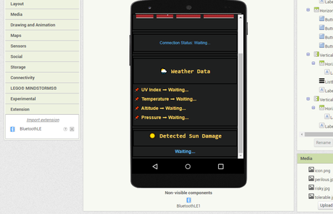

Step 4: Developing a BLE-enabled Android Application W/ the MIT APP Inventor
To be able to obtain the transmitted (advertised) information from the smartwatch over BLE, I decided to develop an Android application from scratch with the MIT APP Inventor.
MIT App Inventor is an intuitive, visual programming environment that allows developers to build fully functional Android applications. Its blocks-based tool (drag-and-drop) facilitates the creation of complex, high-impact apps in significantly less time than the traditional programming environments.
After developing my application, named BLE UV Smartwatch, I published it on Google Play. So, you can install the BLE UV Smartwatch app on any compatible Android device via Google Play.
📲 Install BLE UV Smartwatch on Google Play
Nevertheless, if you want to replicate the BLE UV Smartwatch app on the MIT App Inventor, follow the steps below.
#️⃣ First of all, create an account on the MIT App Inventor.
#️⃣ Download the BLE UV Smartwatch app's project file in the aia format (BLE_UV_Smartwatch.aia) and import the aia file into the MIT App Inventor.
#️⃣ Since the MIT App Inventor does not support BLE connectivity by default, download the latest version of the BluetoothLE extension and import the BluetoothLE extension into the BLE UV Smartwatch project.
In this tutorial, you can get more information regarding enabling BLE connectivity on the MIT App Inventor.
#️⃣ Inspect the BLE UV Smartwatch project functions and source code in the Blocks editor.
#️⃣ After installing the BLE UV Smartwatch app on a compatible Android device, the app starts displaying the transmitted (advertised) information from the smartwatch over BLE immediately to inform the user of potential sun damage risk.
You can get more information regarding the BLE UV Smartwatch app's features in Step 8.

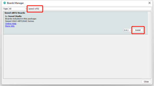

However, before proceeding with the following steps, I needed to set up XIAO BLE on the Arduino IDE and install the required libraries for this project.
#️⃣ To add the XIAO BLE board package to the Arduino IDE, navigate to File ➡ Preferences and paste the URL below under Additional Boards Manager URLs.
https://files.seeedstudio.com/arduino/package_seeeduino_boards_index.json
#️⃣ Then, to install the required core, navigate to Tools ➡ Board ➡ Boards Manager and search for Seeed nRF52 Boards.
#️⃣ After installing the core, navigate to Tools > Board > Seeed nRF Boards and select Seeed XIAO BLE - nRF52840.

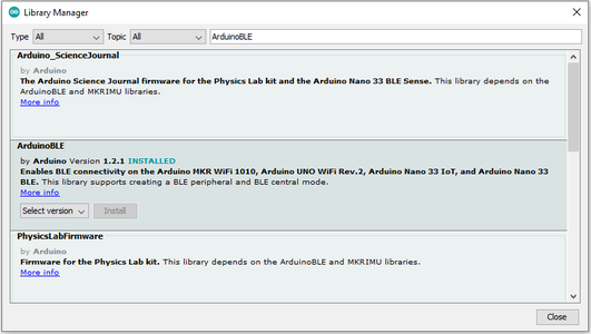

#️⃣ To transmit (advertise) data packets over BLE, download the ArduinoBLE library: Go to Sketch ➡ Include Library ➡ Manage Libraries… and search for ArduinoBLE.

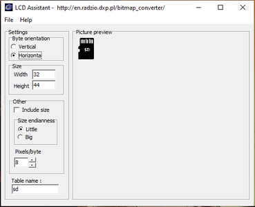

Step 6: Displaying Images on the SSD1306 OLED Screen
To display images (black and white) on the SSD1306 OLED screen successfully, I needed to create monochromatic bitmaps from PNG or JPG files and convert those bitmaps to data arrays.
#️⃣ First of all, download the LCD Assistant.
#️⃣ Then, upload a monochromatic bitmap and select Vertical or Horizontal depending on the screen type.

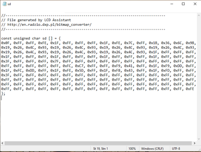

#️⃣ Convert the image (bitmap) and save the output (data array).
#️⃣ Finally, add the data array to the code and print it on the screen.
static const unsigned char PROGMEM sd [] = {
0x0F, 0xFF, 0xFF, 0xFE, 0x1F, 0xFF, 0xFF, 0xFF, 0x1F, 0xFE, 0x7C, 0xFF, 0x1B, 0x36, 0x6C, 0x9B,
0x19, 0x26, 0x4C, 0x93, 0x19, 0x26, 0x4C, 0x93, 0x19, 0x26, 0x4C, 0x93, 0x19, 0x26, 0x4C, 0x93,
0x19, 0x26, 0x4C, 0x93, 0x19, 0x26, 0x4C, 0x93, 0x19, 0x26, 0x4C, 0x93, 0x1F, 0xFF, 0xFF, 0xFF,
0x1F, 0xFF, 0xFF, 0xFF, 0x1F, 0xFF, 0xFF, 0xFF, 0x1F, 0xFF, 0xFF, 0xFF, 0x1F, 0xFF, 0xFF, 0xFF,
0x3F, 0xFF, 0xFF, 0xFF, 0x7F, 0xFF, 0xFF, 0xFF, 0xFF, 0xFF, 0xFF, 0xFF, 0xFF, 0xFF, 0xFF, 0xFF,
0xFF, 0xFF, 0xFF, 0xFF, 0xFF, 0xFC, 0xC7, 0xFF, 0xFF, 0xF9, 0x41, 0xFF, 0x1F, 0xF9, 0xDD, 0xFF,
0x1F, 0xFC, 0xDD, 0xFF, 0x1F, 0xFE, 0x5D, 0xFF, 0x1F, 0xF8, 0x43, 0xFF, 0x1F, 0xFD, 0xFF, 0xFF,
0x3F, 0xFF, 0xFF, 0xFF, 0xFF, 0xFF, 0xFF, 0xFF, 0xFF, 0xFF, 0xFF, 0xFF, 0xFF, 0xFF, 0xFF, 0xFF,
0xFF, 0xFF, 0xFF, 0xFF, 0xFF, 0xFF, 0xFF, 0xFF, 0xFF, 0xFF, 0xFF, 0xFF, 0xFF, 0xFF, 0xFF, 0xFF,
0xFF, 0xFF, 0xFF, 0xFF, 0xFF, 0xFF, 0xFF, 0xFF, 0xFF, 0xFF, 0xFF, 0xFF, 0xFF, 0xFF, 0xFF, 0xFE

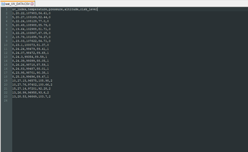

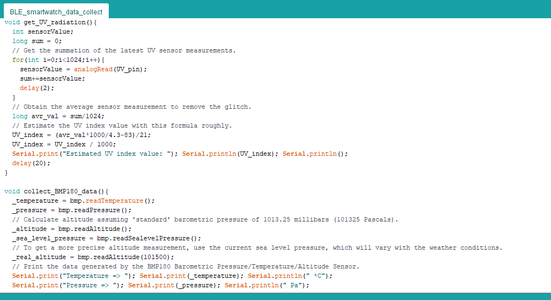

Step 7: Collecting and Storing UV Radiation and Weather Data W/ XIAO BLE

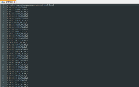

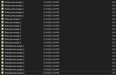

After setting up XIAO BLE and installing the required libraries, I programmed XIAO BLE to collect UV index, temperature, pressure, and altitude measurements in order to save them to the given CSV file on the SD card.
  • UV Index
  • Temperature (°C)
  • Pressure (Pa)
  • Altitude (m)

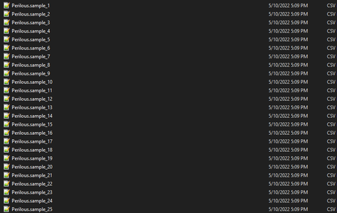

Since I needed to assign sun damage risk levels (classes) empirically as labels for each data record while collecting data outdoors to create a valid data set, I utilized the built-in button on the XIAO expansion board in two different modes (long press and short press) so as to choose among classes and save data records. After selecting a sun damage risk level (class) by short-pressing the button, XIAO BLE appends the selected class and the recently collected data to the given CSV file on the SD card as a new row if the button is long-pressed.
  • Button (short-pressed) ➡ Select a class (Tolerable, Risky, Perilous)
  • Button (long-pressed) ➡ Save data to the SD card
You can download the BLE_smartwatch_data_collect.ino file to try and inspect the code for collecting UV radiation and weather data and for saving information to the given CSV file on the SD card.

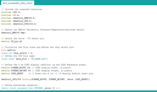

⭐ Include the required libraries.
#include <SPI.h>
#include <SD.h>
#include <Adafruit_BMP085.h>
#include <Adafruit_GFX.h>
#include <Adafruit_SSD1306.h>
⭐ Define the BMP180 precision sensor and the UV sensor's (Grove) voltage signal pin.
Adafruit_BMP085 bmp;
// Define the Grove – UV Sensor pin.
#define UV_pin A0
⭐ Initialize the File class and define the chip select pin for the MicroSD card module on the XIAO expansion board.
File myFile;
const int chip_select = 2;
// Define the CSV file name:
const char* data_file = "UV_DATA.csv";
⭐ Define the 0.96 SSD1306 OLED display on the XIAO expansion board.
#define SCREEN_WIDTH 128 // OLED display width, in pixels
#define SCREEN_HEIGHT 64 // OLED display height, in pixels
#define OLED_RESET    -1 // Reset pin # (or -1 if sharing Arduino reset pin)
Adafruit_SSD1306 display(SCREEN_WIDTH, SCREEN_HEIGHT, &Wire, OLED_RESET);

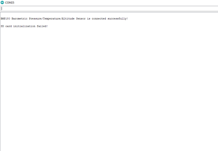

  display.setTextColor(SSD1306_WHITE);
  display.setCursor(0,40);
  display.println("Check the serial monitor to see the error!");
  display.display();

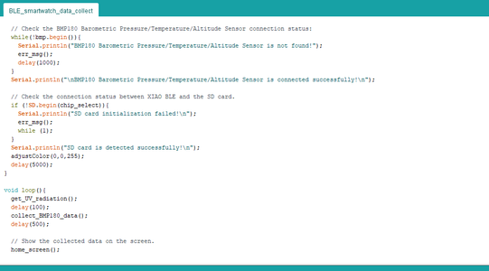

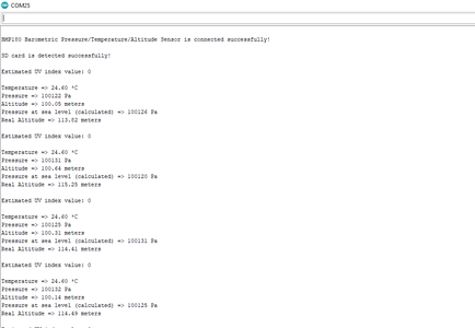

⭐ Check the BMP180 precision sensor connection status.
  while(!bmp.begin()){
    Serial.println("BMP180 Barometric Pressure/Temperature/Altitude Sensor is not found!");
    err_msg();
    delay(1000);
  Serial.println("\nBMP180 Barometric Pressure/Temperature/Altitude Sensor is connected successfully!\n");
⭐ Check the connection status between XIAO BLE and the SD card. If the connection is successful, turn the RGB LED to blue.
  if (!SD.begin(chip_select)){
    Serial.println("SD card initialization failed!\n");
    err_msg();
    while (1);
  Serial.println("SD card is detected successfully!\n");
  adjustColor(0,0,255);
  delay(5000);
⭐ In the get_UV_radiation function:
⭐ Get the summation of the latest 1024 UV sensor measurements.
⭐ Obtain the average sensor measurement to remove the glitch.
⭐ Estimate the UV index value with the formula below roughly.
Although the UV sensor measurements cannot be converted into the exact EPA standard UV index values, the UV index can be estimated roughly with the given formula.
void get_UV_radiation(){
  int sensorValue;
  long sum = 0;
  // Get the summation of the latest UV sensor measurements.
  for(int i=0;i<1024;i++){
    sensorValue = analogRead(UV_pin);
    sum+=sensorValue;
    delay(2);
  // Obtain the average sensor measurement to remove the glitch.
  long avr_val = sum/1024;
  // Estimate the UV index value with this formula roughly.
  UV_index = (avr_val*1000/4.3-83)/21;
  UV_index = UV_index / 1000;
  Serial.print("Estimated UV index value: "); Serial.println(UV_index); Serial.println();
  delay(20);
⭐ In the collect_BMP180_data function:
⭐ Obtain temperature, pressure, altitude, sea level pressure, and real altitude measurements generated by the BMP180 precision sensor.
⭐ Calculate altitude assuming 'standard' barometric pressure of 1013.25 millibars (101325 Pascals).
⭐ If needed, to get a more precise altitude measurement, use the current sea level pressure, which varies with the weather conditions.
void collect_BMP180_data(){
  _temperature = bmp.readTemperature();
  _pressure = bmp.readPressure();
  // Calculate altitude assuming 'standard' barometric pressure of 1013.25 millibars (101325 Pascals).
  _altitude = bmp.readAltitude();
  _sea_level_pressure = bmp.readSealevelPressure();
  // To get a more precise altitude measurement, use the current sea level pressure, which will vary with the weather conditions.
  _real_altitude = bmp.readAltitude(101500);
  // Print the data generated by the BMP180 Barometric Pressure/Temperature/Altitude Sensor.
  Serial.print("Temperature => "); Serial.print(_temperature); Serial.println(" *C");
  Serial.print("Pressure => "); Serial.print(_pressure); Serial.println(" Pa");
  Serial.print("Altitude => "); Serial.print(_altitude); Serial.println(" meters");
  Serial.print("Pressure at sea level (calculated) => "); Serial.print(_sea_level_pressure); Serial.println(" Pa");
  Serial.print("Real Altitude => "); Serial.print(_real_altitude); Serial.println(" meters\n");

    display.drawBitmap(48, 0, sd, 32, 44, SSD1306_WHITE);

Step 8: Logging the Collected Data in a CSV File on the SD Card
After uploading and running the code for collecting UV radiation and weather data and for saving information to the given CSV file on the SD card on XIAO BLE:
☀️⌚ The smartwatch turns the RGB LED to blue if the sensors and the MicroSD card module connections with XIAO BLE are successful.
☀️⌚ Then, the smartwatch turns the RGB LED to magenta as the default color and displays the collected data and the selected class on the SSD1306 OLED screen:
  • UV Index
  • Temperature (°C)
  • Pressure (Pa)
  • Altitude (m)
  • Selected Class
☀️⌚ If the button (built-in) is short-pressed, the smartwatch blinks the RGB LED as white and increases the class number in the range of 0-2:
  • Tolerable [0]
  • Risky [1]
  • Perilous [2]
☀️⌚ If the button (built-in) is long-pressed, the smartwatch blinks the RGB LED as yellow and appends the recently created data record to the UV_DATA.CSV file on the SD card, including the selected sun damage risk level (class) under the risk_level data field.
☀️⌚ If the smartwatch saves the data record successfully to the given CSV file on the SD card, it blinks the RGB LED as green and displays this message on the SSD1306 OLED screen: Data saved to the SD card!
☀️⌚ If XIAO BLE throws an error while operating, the smartwatch shows the error message on the SSD1306 OLED screen, turns the RGB LED to red, and prints the error details on the serial monitor.
☀️⌚ Also, the smartwatch prints notifications and sensor measurements on the serial monitor for debugging.
After logging the collected UV radiation and weather data in the given CSV file on the SD card for 20 days outdoors in different parts of the day (early morning, late afternoon, night, etc.), I elicited my data set with eminent validity:
Since I also needed a testing data set to evaluate the accuracy of my model, I collected additional data to create a modest data set in volume under the test_UV_DATA.CSV file.

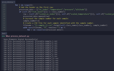

Step 10: Preprocessing and Scaling (normalizing) the Data Set to Create Samples
To scale (normalize) and preprocess my data set so as to create samples, I developed a Python application consisting of one file:
  • process_dataset.py
If the data type is not time series, Edge Impulse requires a CSV file with a header indicating data fields per sample to upload data with CSV files. Since Edge Impulse can infer the uploaded sample's label from its file name, the application reads the given data set and generates a CSV file for each data record (sample), named according to the assigned sun damage risk class of the given data record. Also, the application increases the sample number incrementally for each generated sample having the same label:
  • Tolerable.sample_1.csv
  • Tolerable.sample_2.csv
  • Risky.sample_1.csv
  • Risky.sample_2.csv
  • Perilous.sample_1.csv
  • Perilous.sample_2.csv

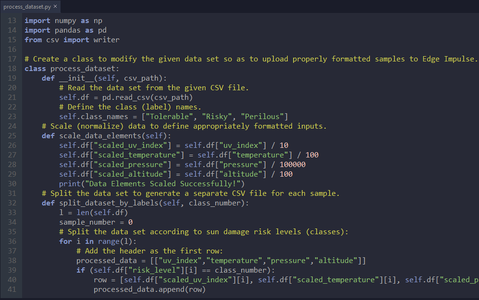

First of all, I created a class named process_dataset in the process_dataset.py file to execute the following functions precisely.
⭐ Include the required modules.
import numpy as np
import pandas as pd
from csv import writer
⭐ In the __init__ function, read the data set from the given CSV file and define the sun damage risk class names.
    def __init__(self, csv_path):
        # Read the data set from the given CSV file.
        self.df = pd.read_csv(csv_path)
        # Define the class (label) names.
        self.class_names = ["Tolerable", "Risky", "Perilous"]
⭐ In the scale_data_elements function, scale (normalize) data elements to define appropriately formatted data items in the range of 0-1.
    def scale_data_elements(self):
        self.df["scaled_uv_index"] = self.df["uv_index"] / 10
        self.df["scaled_temperature"] = self.df["temperature"] / 100
        self.df["scaled_pressure"] = self.df["pressure"] / 100000
        self.df["scaled_altitude"] = self.df["altitude"] / 100
        print("Data Elements Scaled Successfully!")

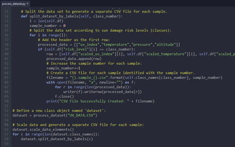

⭐ In the split_dataset_by_labels function:
⭐ Split the data set according to the given sun damage risk level (class).
⭐ Define the header indicating data elements.
⭐ Create a data record (sample) with the scaled data elements and increase the sample number for each sample.
⭐ Then, create a CSV file named with the assigned sun damage risk class (label), identified with the sample number.
⭐ Each sample includes four data items [shape=(4,)]:
[1.2, 0.31379999999999997, 0.9698, 0.9237000000000001]
  • uv_index
  • temperature
  • pressure
  • altitude
    def split_dataset_by_labels(self, class_number):
        l = len(self.df)
        sample_number = 0
        # Split the data set according to sun damage risk levels (classes):
        for i in range(l):
            # Add the header as the first row:
            processed_data = [["uv_index","temperature","pressure","altitude"]]
            if (self.df["risk_level"][i] == class_number):
                row = [self.df["scaled_uv_index"][i], self.df["scaled_temperature"][i], self.df["scaled_pressure"][i], self.df["scaled_altitude"][i]]
                processed_data.append(row)
                # Increase the sample number for each sample:
                sample_number+=1
                # Create a CSV file for each sample identified with the sample number.
                filename = "{}.sample_{}.csv".format(self.class_names[class_number], sample_number)
                with open(filename, "a", newline="") as f:
                    for r in range(len(processed_data)):
                        writer(f).writerow(processed_data[r])
                    f.close()
                print("CSV File Successfully Created: " + filename)
⭐ Finally, run the split_dataset_by_labels function for each sun damage risk level (class) to create samples in the CSV format.
  • 0 — Tolerable
  • 1 — Risky
  • 2 — Perilous
dataset.scale_data_elements()
for c in range(len(dataset.class_names)):
    dataset.split_dataset_by_labels(c)

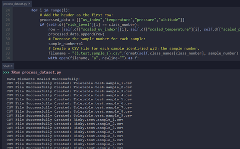

💻 After executing the application, it generates a CSV file for each data record (sample) in the given data set (training or testing) and prints the file names on the shell for debugging.
📌 Training samples:
Inspect the images above.
📌 Testing samples:
Step 11: Uploading Samples to Edge Impulse
After generating training and testing samples successfully, I uploaded them to my project on Edge Impulse.
#️⃣ First of all, sign up for Edge Impulse and create a new project.
#️⃣ Navigate to the Data acquisition page and click the Upload existing data button.
#️⃣ Then, choose the data category (training or testing) and select Infer from filename under Label to deduce labels from file names automatically.
#️⃣ Finally, select files and click the Begin upload button.

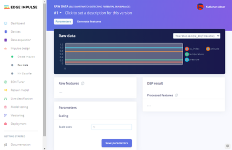

#️⃣ Go to the Create impulse page. Then, select the Raw Data block and the Classification learning block. Finally, click Save Impulse.
#️⃣ Before generating features for the model, go to the Raw data page and click Save parameters.
#️⃣ After saving parameters, click Generate features to apply the Raw Data block to training samples.

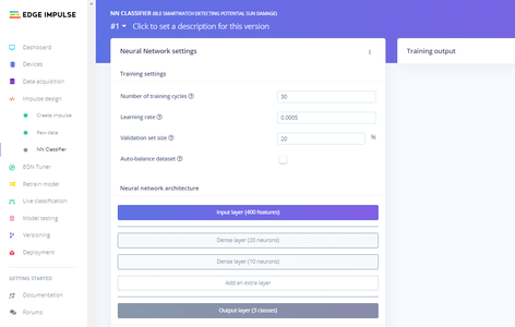

#️⃣ Finally, navigate to the NN Classifier page and click Start training.
I utilized the default classification model settings, architecture, and layers to build my neural network model.
After generating features and training my model with training samples, Edge Impulse evaluated the precision score (accuracy) as 100%.
The precision score is approximately 100% due to the volume and variety of training samples. In technical terms, the model overfits the training data set. Therefore, I am still collecting data to improve my training data set.

After validating my neural network model, I deployed it as a fully optimized and customizable Arduino library.
#️⃣ To deploy the validated model as an Arduino library, navigate to the Deployment page and select Arduino library.
#️⃣ Then, choose the Unoptimized (float32) option to deploy the model without downsizing the accuracy.
#️⃣ Finally, click Build to download the model as an Arduino library.

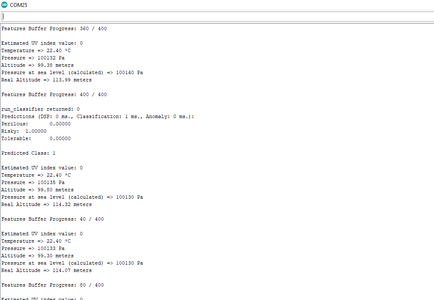

Step 14: Setting Up the Edge Impulse Model on XIAO BLE
After building, training, and deploying my model as an Arduino library on Edge Impulse, I needed to upload and run the Arduino library on XIAO BLE directly so as to create an easy-to-use and capable smartwatch operating outdoors with minimal latency and power consumption.
Since Edge Impulse optimizes and formats signal processing, configuration, and learning blocks into a single package while deploying models as Arduino libraries, I was able to import my model effortlessly to run inferences.
#️⃣ After downloading the model as an Arduino library in the ZIP file format, go to Sketch > Include Library > Add .ZIP Library...
#️⃣ Then, include the BLE_Smartwatch_Detecting_Potential_Sun_Damage_inferencing.h file to import the Edge Impulse neural network model.
#include <BLE_Smartwatch_Detecting_Potential_Sun_Damage_inferencing.h>

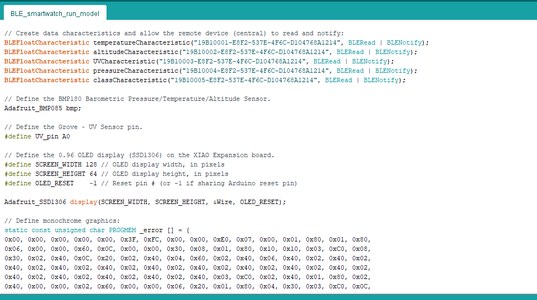

After importing my model successfully on the Arduino IDE, I utilized XIAO BLE to run inferences at regular intervals so as to forecast sun damage risk levels.
Also, after running inferences successfully, I employed XIAO BLE to transmit (advertise) the prediction (detection) result and the recently collected data over BLE as a peripheral device.
#include <ArduinoBLE.h>
// Include the Edge Impulse model converted to an Arduino library:
⭐ Define the required parameters to run an inference with the Edge Impulse model.
⭐ Define the features array (buffer) to classify one frame of data.
#define FREQUENCY_HZ        EI_CLASSIFIER_FREQUENCY
#define INTERVAL_MS         (1000 / (FREQUENCY_HZ + 1))
// Define the features array to classify one frame of data.
float features[EI_CLASSIFIER_DSP_INPUT_FRAME_SIZE];
size_t feature_ix = 0;
⭐ Define the threshold value (0.60) for the model outputs (predictions).
⭐ Define the sun damage risk level (class) names and color codes:
  • Tolerable
  • Risky
  • Perilous
float threshold = 0.60;
// Define the sun damage risk level (class) names and color codes:
String classes[] = {"Perilous", "Risky", "Tolerable"};
int color_codes[3][3] = {{255,0,0}, {255,255,0}, {0,255,0}};
⭐ Create the BLE service and data characteristics. Then, allow the remote device (central) to read and notify.
BLEService BLE_smartwatch("19B10000-E8F2-537E-4F6C-D104768A1214");
// Create data characteristics and allow the remote device (central) to read and notify:
BLEFloatCharacteristic temperatureCharacteristic("19B10001-E8F2-537E-4F6C-D104768A1214", BLERead | BLENotify);
BLEFloatCharacteristic altitudeCharacteristic("19B10002-E8F2-537E-4F6C-D104768A1214", BLERead | BLENotify);
BLEFloatCharacteristic UVCharacteristic("19B10003-E8F2-537E-4F6C-D104768A1214", BLERead | BLENotify);
BLEFloatCharacteristic pressureCharacteristic("19B10004-E8F2-537E-4F6C-D104768A1214", BLERead | BLENotify);
BLEFloatCharacteristic classCharacteristic("19B10005-E8F2-537E-4F6C-D104768A1214", BLERead | BLENotify);
⭐ Define monochrome graphics.
⭐ Create an array including icons for each sun damage risk level (class).
static const unsigned char PROGMEM *class_icons[] = {tolerable, risky, perilous};
⭐ Check the BLE initialization status and print the XIAO BLE address information on the serial monitor.
  while(!BLE.begin()){
    Serial.println("BLE initialization is failed!");
    err_msg();
  Serial.println("\nBLE initialization is successful!\n");
  // Print this peripheral device's address information:
  Serial.print("MAC Address: "); Serial.println(BLE.address());
  Serial.print("Service UUID Address: "); Serial.println(BLE_smartwatch.uuid()); Serial.println();
⭐ Set the local name (BLE UV Smartwatch) for XIAO BLE and the UUID for the advertised (transmitted) service.
⭐ Add the given data characteristics to the service. Then, add the service to the device.
⭐ Assign event handlers for connected and disconnected devices to/from XIAO BLE.
⭐ Finally, start advertising (broadcasting) information.
  BLE.setLocalName("BLE UV Smartwatch");
  // Set the UUID for the service this peripheral advertises:
  BLE.setAdvertisedService(BLE_smartwatch);
  // Add the given data characteristics to the service:
  BLE_smartwatch.addCharacteristic(temperatureCharacteristic);
  BLE_smartwatch.addCharacteristic(altitudeCharacteristic);
  BLE_smartwatch.addCharacteristic(UVCharacteristic);
  BLE_smartwatch.addCharacteristic(pressureCharacteristic);
  BLE_smartwatch.addCharacteristic(classCharacteristic);
  // Add the service to the device:
  BLE.addService(BLE_smartwatch);
  // Assign event handlers for connected, disconnected devices to this peripheral:
  BLE.setEventHandler(BLEConnected, blePeripheralConnectHandler);
  BLE.setEventHandler(BLEDisconnected, blePeripheralDisconnectHandler);
  // Start advertising:
  BLE.advertise();
  Serial.println(("Bluetooth device active, waiting for connections..."));

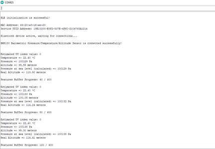

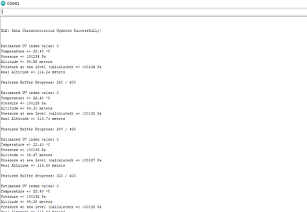

Step 15: Running the Model on XIAO BLE to Make Predictions on Sun Damage Risk Levels
When the features array (buffer) is full with data items, my Edge Impulse neural network model predicts possibilities of labels (sun damage risk classes) for the given features buffer as an array of 3 numbers. They represent the model's "confidence" that the given features array (buffer) corresponds to each of the three different sun damage risk levels (classes) based on UV index, temperature, pressure, and altitude measurements [0 - 2], as shown in Step 5:
  • 0 — Tolerable
  • 1 — Risky
  • 2 — Perilous
As discussed in the previous steps, I also employed XIAO BLE to transmit (advertise) the prediction (detection) result and the recently collected data over BLE.
After executing the BLE_smartwatch_run_model.ino file on XIAO BLE:
☀️⌚ The smartwatch turns the RGB LED to blue if the BLE initialization status is successful.
☀️⌚ Then, the smartwatch turns the RGB LED to magenta as the default color and displays the collected data on the SSD1306 OLED screen:
  • UV Index
  • Temperature (°C)
  • Pressure (Pa)
  • Altitude (m)
☀️⌚ The smartwatch runs inferences with the Edge Impulse model at regular intervals by filling the features buffer with the recently collected UV index, temperature, pressure, and altitude measurements.
☀️⌚ Then, the smartwatch displays the detection result, which represents the most accurate label (sun damage risk class) predicted by the model.
☀️⌚ Each sun damage risk level (class) has a unique monochrome icon to be shown on the SSD1306 OLED screen and a color code for adjusting the RGB LED when being predicted (detected) by the model:
  • Tolerable ➡ Green
  • Risky ➡ Yellow
  • Perilous ➡ Red
☀️⌚ After running inference successfully, the smartwatch also transmits (advertises) the prediction result (class) and the recently collected data over BLE.
☀️⌚ If XIAO BLE transmits the given information over BLE successfully, the smartwatch prints this message on the screen:
BLE: Data Transmitted
As far as my experiments go, the smartwatch operates impeccably while forecasting sun damage risk levels (classes) and transmitting (advertising) the prediction result over BLE outdoors :)
Step 16: Monitoring the Model Prediction Result Over BLE Via the BLE UV Smartwatch App
As discussed in Step 2, I developed an Android application (BLE UV Smartwatch) from scratch with the MIT APP Inventor so as to obtain and display the transmitted (advertised) information from the smartwatch over BLE.
☀️⌚ If the Scan button is pressed, the application scans for compatible BLE devices and shows them as a list.
☀️⌚ If the Stop button is pressed, the application desists from scanning devices.
☀️⌚ If the Connect button is pressed, the application attempts to connect to the selected BLE device (smartwatch) over BLE.
☀️⌚ If the application connects to the smartwatch (peripheral device) as the central device successfully, the application waits for the advertised (transmitted) data packets from the smartwatch.
☀️⌚ When the application receives the advertised data packets, it shows the recently collected data by the smartwatch and the sun damage risk level (class) predicted by the Edge Impulse model.
☀️⌚ Each sun damage risk level (class) has a unique fusion state image and color code to be displayed on the screen when being received:
  • Tolerable ➡ Green
  • Risky ➡ Yellow
  • Perilous ➡ Red
☀️⌚ If the Disconnect button is pressed, the application disconnects from the smartwatch and clears all received information.
