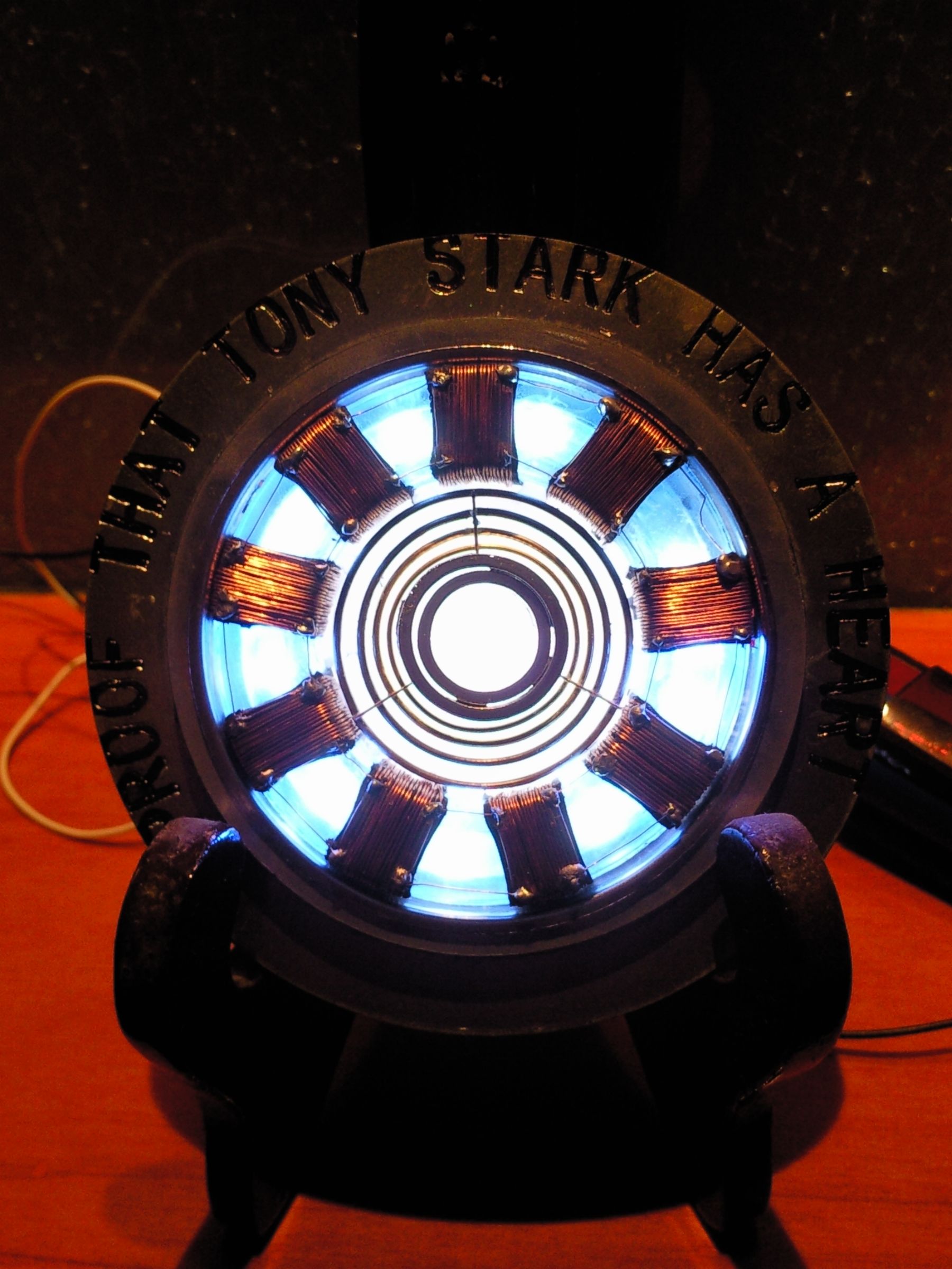

Sorry for keeping you waiting for so long. This is the second arc reactor I made. I did not completely copy the prop in themovie. I created some new designs.

Step 6: THE FINAL STEP AND FINAL DISPLAY
The final step is to assemble all the parts. Glue some plastic cubes on the interior side of the light ring to fix the center component.
This reactor is super thin, it is only less than 2CM including the cover.
Put the reactor into the round frame. The frame is a filter of the tea pot. Here is how I made the exterior metal ring: I took apart a thermometer and painted its cover silver to make it look like real metal.
