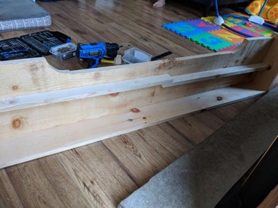

Step 2: Assemble Seat
Started on one side and began screwing in the boards to make a box. Screwed the front piece to the top piece and the supporting side pieces.
Step 3: Trim Seat to Fit
Using a jigsaw and circular saw, we cut out the fireplace insert so that the bench will sit flush against the brick
Step 4: Add Seat Support
Using a couple of boards and a few screws, placed a couple pieces of wood to support the seat. This will rest on the fireplace

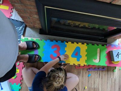

Step 5: Add Floor Foam
Using woodglue, we placed foam flooring to the bench to help create a base for where the stuffing will sit for the seat. Using heavy objects to place on the floor to help make it stick
Step 6: Trim Flooring
Using Scissors or an exacto knife, begin trimming the flooring

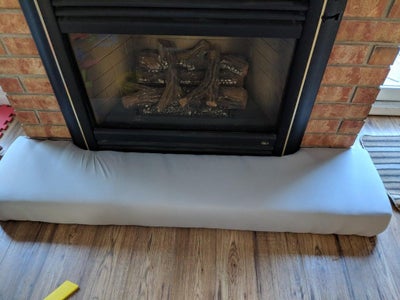

Step 9: Finished!
Once done, place the bench back to check the fit. Once happy with the fit, add some pillows for decorations
