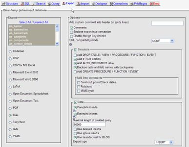

Step 7: Export 1
The main part of the screen is now divided into a number of sections.
i.Export
In this section you can specify which tables you'd like to backup. The default is for all of the tables but it doesn't hurt to select the 'Select All' link again.
i.Export
Step 8: Export 2
Further down this section, it is possible to specify which type of file we'd like to create. Check that 'SQL' is selected. This means we're able to use this file for later restoring of the data is required.
Step 9: Export Options
ii.Options
Leave as default settings.
Step 10: File Structure
iii.Structure
We will select two extra check boxes, over and above the default.
Step 11:
'Add DROP TABLE / VIEW / PROCEDURE / FUNCTION / EVENT' – this options adds extra entries in the SQL file. If the backup file is used to restore a database, these entries mean that tables etc. will be overwritten if they exist already, which means that you don't have to delete the tables beforehand.
The two images here show a before and after in the sql file, when using this option.
Step 12: Add Into Comments
You can select any of these options if you wish as they shouldn't make any difference to the data from the database. They are simply used to put extra text into the file which maybe of use later.
