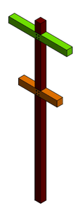

Step 6: Make a T-Trellis
This trellis will be used to support the canes and to keep the raspberries managable.
You will build 2 post to this drawing.

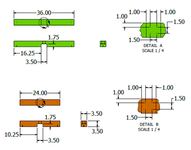

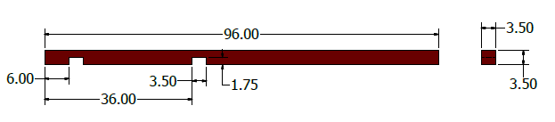

Step 7: Cut 4x4s As Shown
Cut 4x4s to the lengths shown.
Step 8: Slot 4x4s
For added strength, slot the post together as shown in the previous step. I used a miter saw with the depth set to half the thickness of the 4x4.

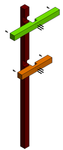

Step 10: Add Screws
Probably overkill but I used four 3" long deck screws to secure each joint.

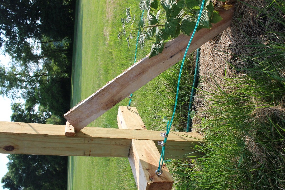

Step 15: Brace Posts (optional)
Ok, I didn't follow my own directions and tried to skimp on the post length (6 foot vs. 8 foot shown above) with only 2 feet in the ground. I also didn't wait to install the wire. The post leaned in with very little tension on the wire. I had to add these interior braces to keep the post vertical. Follow the previous steps and you shouldn't have this issue.
