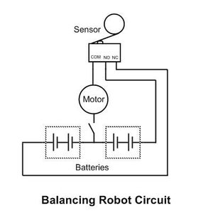

Step 5: Connecting the Switch
Solder a wire form positive pole of one of battery holders to the negative pole of the other battery holder and attach the toggle switch to it.
Then attach the other side of the switch to the motor.
Step 6: Wiring
Now it is time to solder the robot wires.
Note that you must solder the wires in a way that robot moves to the direction that is going to fall.
Step 7: Testing
The robot is now completed and it is time to test it.
Put 4 batteries into the battery holders and turn on the switch.
Try to change the position of the sensor to make the robot works better.
If the robot works inverted swap the red and blue wires on the sensor or on the battery holders.

    Assalamu alaikum, I decided to ask you about the wire connection, would you like to giving a picture of it ?
    0
    vahidyou
    vahidyou
    Reply 6 years ago
    Look at step 6.

    nmvb
    nmvb
    9 years ago on Step 6
    why is the switch in between the battery packs instead of after?
