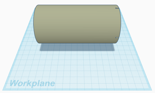

Step 1: Build on Tinkercad
The first step in making this ball launcher is to design its base on Tinkercad. The launcher base is a hollow circular tube with an open top and bottom. There would also four equally sized and spaced notches in the top lip of the tube. The tube needs to be 5 inches tall, with a radius of 1.25 inches, and notches that are .1 inches wide going .25 inches deep into the cup.
