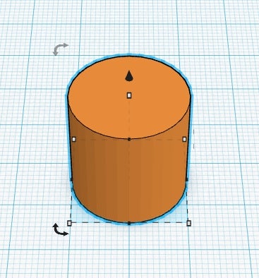

When working on CAD projects its typically easiest to start with your largest shape or feature. In this case our largest feature is the body of the button which is a cylinder.
Instructions
  1. Start by grabbing a cylinder and placing it on the workplane.
  2. Continue to the next step.
