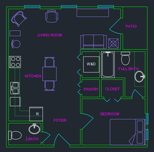

Step 2: Design Your Floor Plan
You are more than welcome to create your own floor plan, but for the sake of learning the basics as well as time, I created a floor plan that I encourage you to follow along with throughout this tutorial.
In my floor plan, I created a one bedroom apartment that has:
- 1 bedroom
- 1 half bath
- 1 full bath
- An open concept kitchen and living room
- A porch
- Laundry closet
These are basic rooms needed/wanted in an ideal one bedroom apartment. Of course, it is fictional, so we can make it as fancy as we want to.

Step 3: Begin Drafting Your Floor Plan in AutoCad
You might be thinking, "I just learned how to draw lines in AutoCad, and now you want me to make an entire floor plan??" And my answer is yes, yes I do. You have learned all the tools and commands you need to do so! Heck, you could even do it without me. Although, you won't; I'll be with you *virtually* every step of the way!
So let's get into it!
In this step, we create the outlines of each room and wall thickness to our floor plan. If you are using my floor plan design, the square footage should be 676sq ft, or in other words, 26ft x 26ft.

Step 4: Add in Doors and Windows
Now, after we have structured walls and rooms, we can add in doorways and windows.
Reminders:
- Make sure you are in the correct layer*
- Refer to step 3 for standards regarding door clearance and width
- Make sure OS (Object Snap) is turned on for accurate and easy placement of doors/windows
- Make sure PT (Polar Tracking) is on as well
*I did not specify this in the video, so please make sure you are in the DOORS layer to begin.
(Layers drop down menu > "DOOR")

Step 5: Add Appliances and Furniture
* Apologies in advance: this video does not have audio, but that's okay! You don't need to hear me to follow along.
TIP: Skip to 00:00:28 for when I start actually doing things, I was talking in the beginning.
We now have a floor plan with rooms, doors, and windows, but we need to add appliances!
Reminders/advice:
- To create a new layer:
Layer Properties > New Layer (should have small yellow star next to it)
Then just name the layer and choose a color! (make sure it isn't already taken)
- Use the Architecture Resources!
- Feel free to use whichever furniture you would like. Make it your own!
- If you follow my floor plan, use the kitchen layout I do in the video—I made it custom so it would fit perfectly!
- Turn off OS when positioning appliances—it will make your life easier.
**Do this AFTER positioning the kitchen layout
- Furniture is optional (just to make it look nice).
**ADVANCED TIP: if you were in the professional world making a real-life floor plan for potential buyers/homeowners, furniture is a great addition! It not only demonstrates the use of the space, but it also more clearly distinguishes each room.
