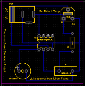

Step 1: Drawing Schematic
First, need to draw the schematic diagram of the circuit. Any software can be used. I have done it using EasyEDA.
The inverting pin of the op-amp is connected to the voltage-dividing node. This node has been created using a 10 kΩ resistor and a 10 kΩ NTC thermistor. The non-inverting pin has been connected to the potentiometer. This potentiometer sets the threshold value. When the temperature rises, the resistance falls along with the voltage. When the voltage is less than the threshold, the output of the op-amp goes high. It means the buzzer is on.
Step 2: Designing and Printing PCB
The schematic diagram has been transformed into the PCB design. After completing the design, the printing process begins. I have printed the board from a third-party shop. If you have a breadboard and are comfortable with it, then build it on the breadboard.

After placing all the components on the board, solder them to fix the circuit to the PCB. The project is completed. Now,
