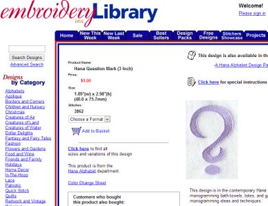

There are many embroidery designs available for free on the web, but I was in a hurry, so went to embroideryLibrary. They've got many nice designs, ready to go.
The Riddler is a guy who likes to question everything, so I used Hana 3" Question Mark, Hana 1.5" Question Mark and Fancy Flourish Punctuation 1.5" Question Mark.

The design software (to customize patterns) is several hundred dollars, but really I just needed a few question marks, which I managed to find for $1 each. Lucky for me the Riddler's not into custom logos.
