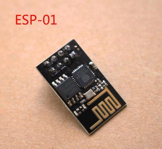

- ESP8266 01

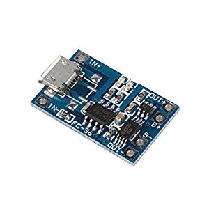

- USB LiPo Charger

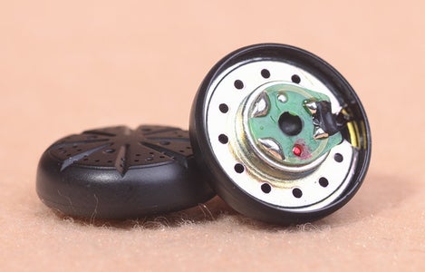

- Old earphone speaker

Step 2: Find an Old Earphone and Take One of Its Speaker
Earphone speakers are small and if you are going to generate some monotone sound, it is loud enough to be used in our purpose.

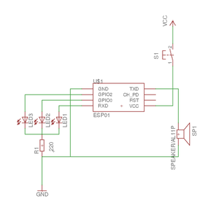

Step 3: Connection
Make the connection as per the circuit diagram. I have used 3 SMD (Red, Green, and Blue) LEDs. I soldered it to a small protoboard with 220 ohm resistor in series with the LEDs. You can use any LEDs, but SMD will save you a lot of space.
Connect the LiPo charger to the battery.
