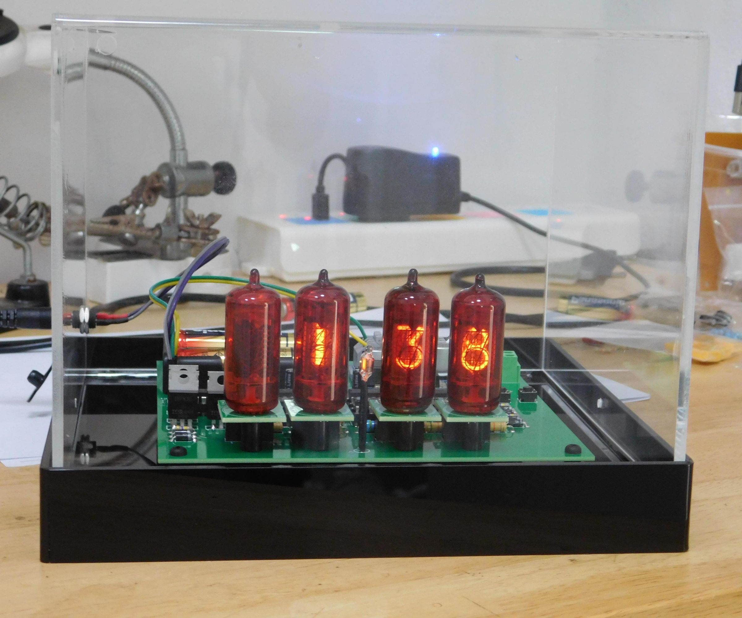

For where I live, brief power outages are common and I needed something for a binary clock I built as well as a digital clock I am working on. I came across this circuit on a digital clock schematic, redrew it to correct some errors, and it works great. I have this operational in 3 projects I have made.

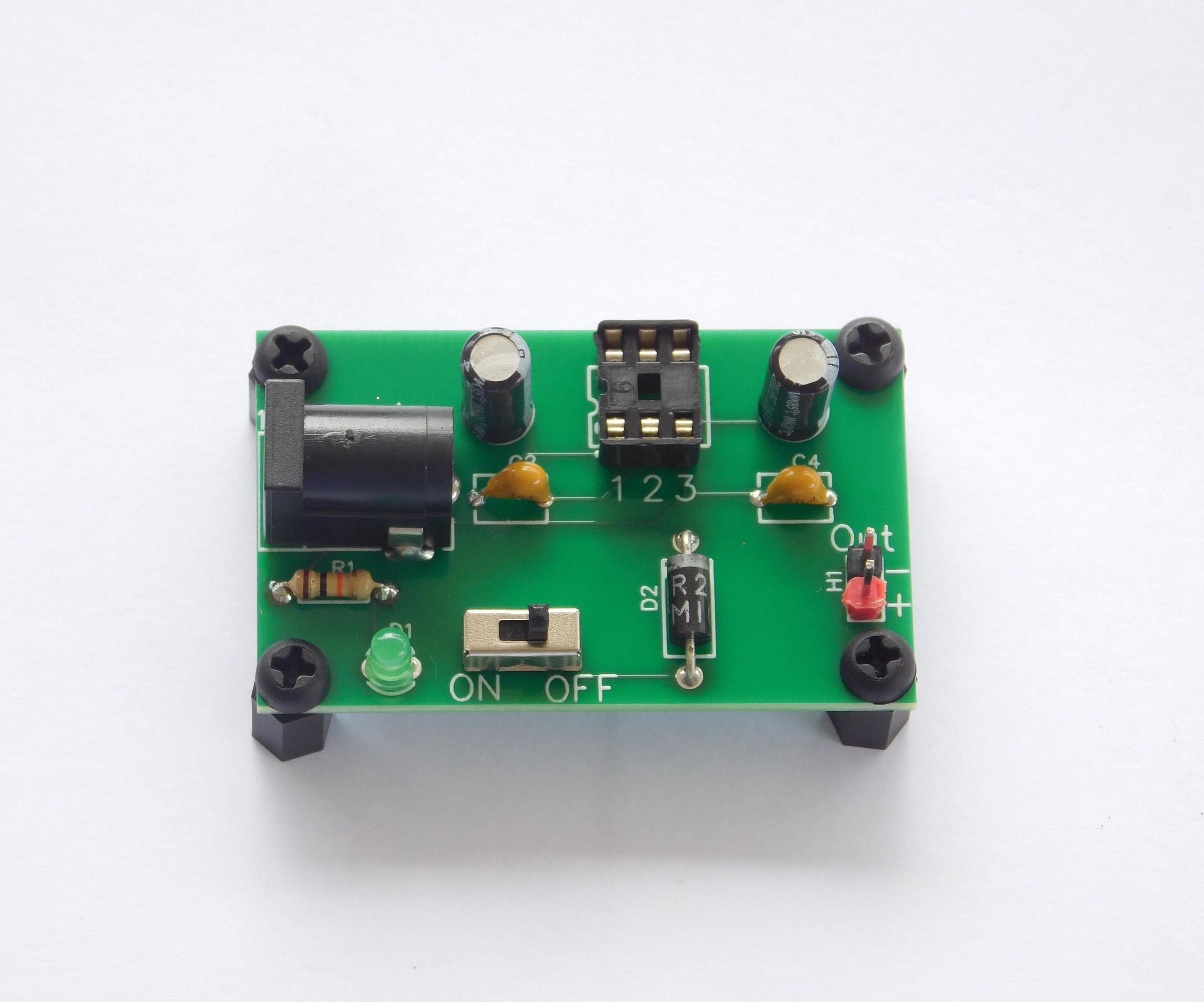

Assemble circuit as shown in the schematic. I use colored header pins, red for +5 and black for ground.
Step 2: Testing
Once the circuit is assembled, test the operation. Insert 3 fresh AA batteries into the battery holder, the green LED will light.
Then connect your 5 volt power supply to the correct header pins as shown in the photo.
Now remove 1 battery and the red LED will light, green LED will go out, adjust the trim pot as needed to get these indications. When all 3 batteries are installed and the red LED lights, that indicates you need to replace the batteries.
Now there will be no interruption in power when the mains power supply is removed.
