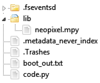

- Install this library from a recent bundle from https://circuitpython.org/libraries into the lib directory on CIRCUITPY:
- neopixel.mpy
- Download the example program to CIRCUITPY by clicking Save link as... on clue-battery-tester.py
- Rename or delete any existing code.py file on CIRCUITPY, then rename the clue-battery-tester.py to code.py. This file is run when the CircuitPython interpreter starts or reloads.

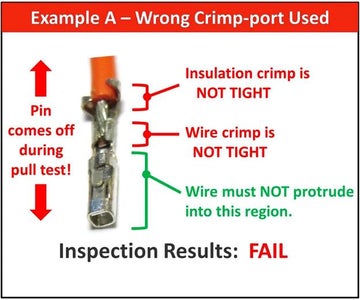

- Poor crimping on connectors of jumper wires can cause confusing issues as the cable may show a normal low resistance if measured with a multimeter but wiggling/twisting the cable can cause a substantial, unpredictable rise in resistance.

The images above are a breadboard abused by ElectroBoom and an example of a poor crimp from Instructables: Make a Good Dupont Pin-Crimp EVERY TIME!
