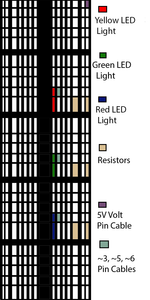

Step 2: Setup
  1. Plug your Grove base shield into your Edison (doesn’t have to be an Intel Edison - can be an Arduino board).
  2. Plug jumper cable into port I2C (doesn’t matter which one). Connect other end to RGB Backlight LCD.
  3. Plug jumper cable into port D8. Connect other end to Touch Sensor.
  4. Plug jumper cable into port A0. Connect other end to Rotary Angle Sensor.
  5. Plug jumper cable into port A3. Connect other end to Sound Sensor.
  6. Plug pin cable into 5V port (located by the I2C ports).
  7. Plug pin cables into ~3, ~5, and ~6 ports. We will connect these to the yellow, green, and red lights respectively.
  8. Check bread board diagram and set up accordingly.
  9. Download code at the end of the page.
