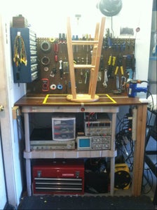

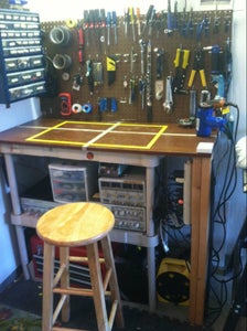

Step 1: The Workshop and Storage
The Workshop: This is where your projects will be built. Yes, on your very own work desk! I built mine out of scrap wood Ikea was giving throwing away, throwing on 2 2x4's I made the corner leg *shown in the picture*, the desk is secured to the wall by 2 2x4's drilled onto the wall studs, then resting the edge on top of the 2x4's. Because the desk is in a corner, I did not need more than 1 leg, This technique is the strongest type of desk, so if you are working on heavy things, I recommend a corner desk. Pegboard is an amazing way for quick and easy access to your tools. However I have so many tools, I have some in my toolbox, these tend to be more sharp and dangerous tools. Storage is a necessity and absolute MUST. You wont be able to have any test equipment or tool storage without a shelving unit. it just so happened I had a plastic shelving unit which I used under my desk.

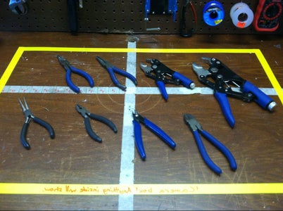

Step 4: Tools: Mechanical Hand Tools
We wouldn't be anywhere without hand tools. They range in size depending on the application, and provide an amazing ability that our hands themselves could not. Screwdrivers and needed anywhere, and if youre like me, you will need all sizes. Philips and Flat head screwdrivers are more common than others, but its not limited to. I recommend having 1 or 2 universal ones, which have detachable heads that can switch. I also recommend 2 long screwdrivers, 2 shorter ones, a small Philips and flathead, and a micro flathead and Philips. Wrenches, allens, rivet guns, and sockets are all awesome securing tools. they will drive down a screw, lock 2 items in place, and what not. Pliers are another necessity. They come in all shapes and sizes, but the recommended group of pliers include: Needle nose, Mini needle nose, hammer type, and a pair of snippers. This lot will get you through your project.

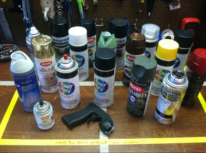

Step 7: Tools: Spray Paint
Before anything is said, I am a NUT when it comes to black spray paint. Makers LOVE it. and so will you. whats better than spreading a clean and even coat on something? When spraying, stay about a foot back, and do one coat, wait, do a second. if it looks polkadotted, don't worry, its the first coat. it will build up as you go. Do not spray continuously, spray in a back and forth motion, and only holding the spray nozzle down periodically. you can find tutorials online.
