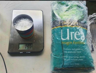

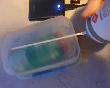

Step 12: How to Cool Beer Without Ice
Here's 2 methods to cool beer to 5c which don't use ice. Unfortunately, it costs about $10 a can to cool each can with these methods.
  1. Using Urea (a nitrogen fertilizer)
  2. Using an 'air' canister.
