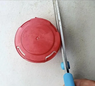

Cut out one of the circular disks from a beer clip-on pack using a pair of scissors.

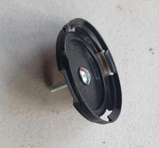

Drill a hole in the center of the clip-on disk.
Fix a roofing bolt though this hole and attach a nut to secure.

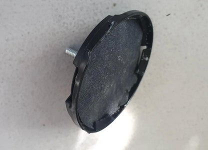

Place the plastic disk on top of a sheet of 240 grit wet and dry sandpaper and draw a circle around the circumstance.
Cut out the disk of sandpaper.
Trim the disk so it will just fit into the underside of the clip-on disk and remain there.
The sandpaper is to give move grip to the aluminium can.

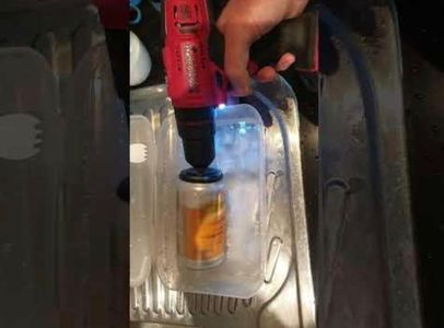

Attach the clip on attachment to a battery powered drill and select the drill setting .

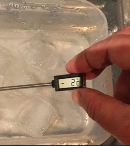

A 400mil tray of ice cubes was added to the salt water. After 1min it had cooled to 1degee C and after 2 min it was down to -2 degrees C.
Step 7: Spin for Three Minutes

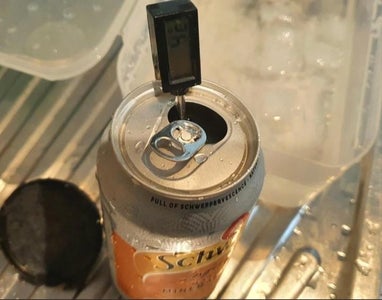

The beverage can was spun in the icey salt water for 3 minutes. This cooled the drink down to 4 degrees C.
When another can was tried, it could only be cooled to down to 10 degrees C as the salt water had warmed up from the heat transfer from the cans.
