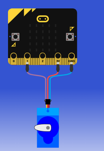

We have prepared the bee and flower models using unused plastic. We used servo motor to open and close the flower when the bee comes.

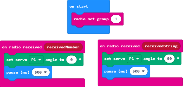

Step 2: Makecode

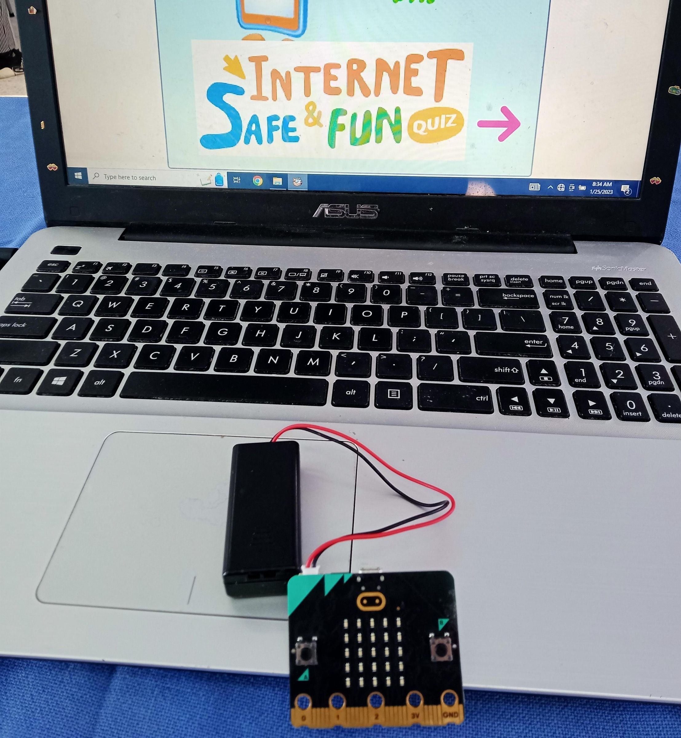

The microbit connected to the bee communicates with the flower's microbit using radio communication. When the bee is near the flower its sends a message. The flower decodes the message and opens to let the bee consume the pollen.
After finishing the flower closes.
The flower opens and closes using servo motor commanded by microbit.
Here the links of the code in github plants and github bees
