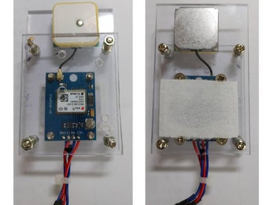

Step 4: GPS Module
Let’s look at each module one by one for more detail about how it was assembled is seen.
The GPS module consists of controller break-out and Antenna.
Because a tiny wire is connected from antenna to controller, both components should be tightly mounted on something sturdy chassis.
I used acrylic boards for firmly mounting and fixing both components of the GPS module.
Also, the Velcro band is attached to the backside of the GPS module to be firmly fixed on the back bag mounted on the rear of a bicycle.
For correct operation of the GPS module, the antenna should face upward toward the sky to receive signals from at least 3 satellites.
Therefore, you need to go out to an open space where any building’s height does not obstruct satellite signals as the line of sight.
When signal reception is possible from satellites, tiny blue light LED on the controller break-out board start to blink.

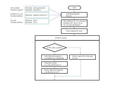

Step 7: Sketch Program
The program of the journey tracker is simple and easily understandable of the overall operational logic.
As depicted in the flowchart above, all relevant libraries should be included as follows.
-    SoftwareSerial and TinyGPS is necessary for receiving GPS data from satellites
-    LiquidCrystal_I2C is required for activating PCF8574 I2C LCD module
-    SPI and SD is standard libraries for interfacing SD card module
Subsequently, three device drivers are initialized including Neo-6M GPS (including software serial driver), PCF8574 I2C controller, and SD card module.
Then serial ports of the GPS module continually are monitored whether any data is available.
When the GPS module is receiving at least three satellite signals, the NEMA standard format of GPS data packet will be received.
A geographical location and exact time data can be received by the following system calls.
-    gps.f_get_position(&flat, &flon); // Get latitude and longitude coordination data
- gps.crack_datetime(&years,&months,&days,&hours,&minutes,&seconds,&hundredths); // Get exact time data
The captured coordination and time data will be stored as a text file on an SD card and displayed on the LCD display.
Subsequently, GPS data capturing, saving, and displaying will be continued endlessly until power is off.
